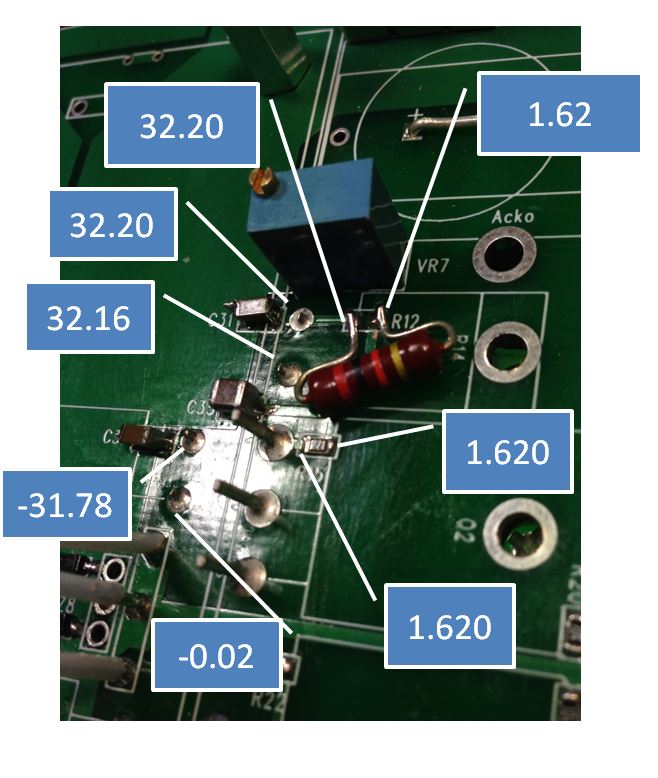

Hi Owen,
Slightly unorthodox but I wanted to make sure that I was interpreting what you asked correctly so I did it visually - all voltages relative to ground.
I have to say this is great learning for me - someone in another thread said that you only learn when something goes wrong...very true!
Isolation pad is doing its job correctly.

Very nice diagram! Makes troubleshooting much easier :)
It pretty much has to be one of the following:
- The resistor you added at R12 is faulty, or the wrong value.
- The pot is faulty or not correctly adjusted
- C35 is damaged or faulty and is presenting low impedance to GND.
Of the above three, my money would be on the pot. Try pulling it out and measuring the resistance from end to end, and wiper to each end. You might be able to do it in-circuit with everything off, so try that before pulling it.
My next guess would be the cap, but it's less likely.
With only 1.6V on the gate, the fet will not even begin to conduct, hence the 32V on the drain. With no current flowing through the drain resistor, there will be no voltage drop across it.
What doesn't make sense is that you have 0V on the source, when you should be seeing some negative voltage a little higher than the zener voltage. Not sure what's going on there.
You might want to adjust one of the other legs to have 1.6V on the gate, and see if the voltages match for troubleshooting purposes.
So close! You're 75% up and running :)
Owen

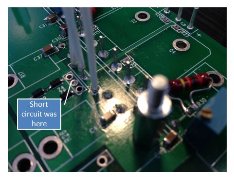

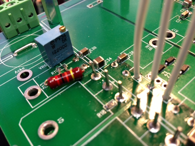

Owen, with your help I think I'm there!!! :))))
What it turned out to be was a tiny spec of solder lodged between the ground and the negative input which leads to Q2 - it wasn't even soldered in place...I just brushed it out the way. This was clearly left over by me when I removed the pins I had in there originally and decided to solder wires into the more widely spaced inputs (see pic below). This was after I took the whole thing off the heatsink of course...ha, but it doesn't matter, we're all up and running at the correct voltages and I'm going to put it together and test it with the DAC

- OK, so back on track. I worked through reasons why there would be 0v at source and the most logical was that there was a short to GND somewhere nearby....and sure enough I found one!!

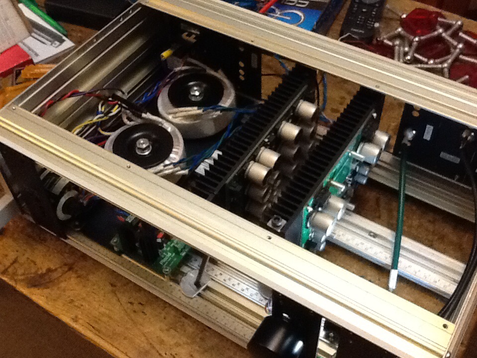

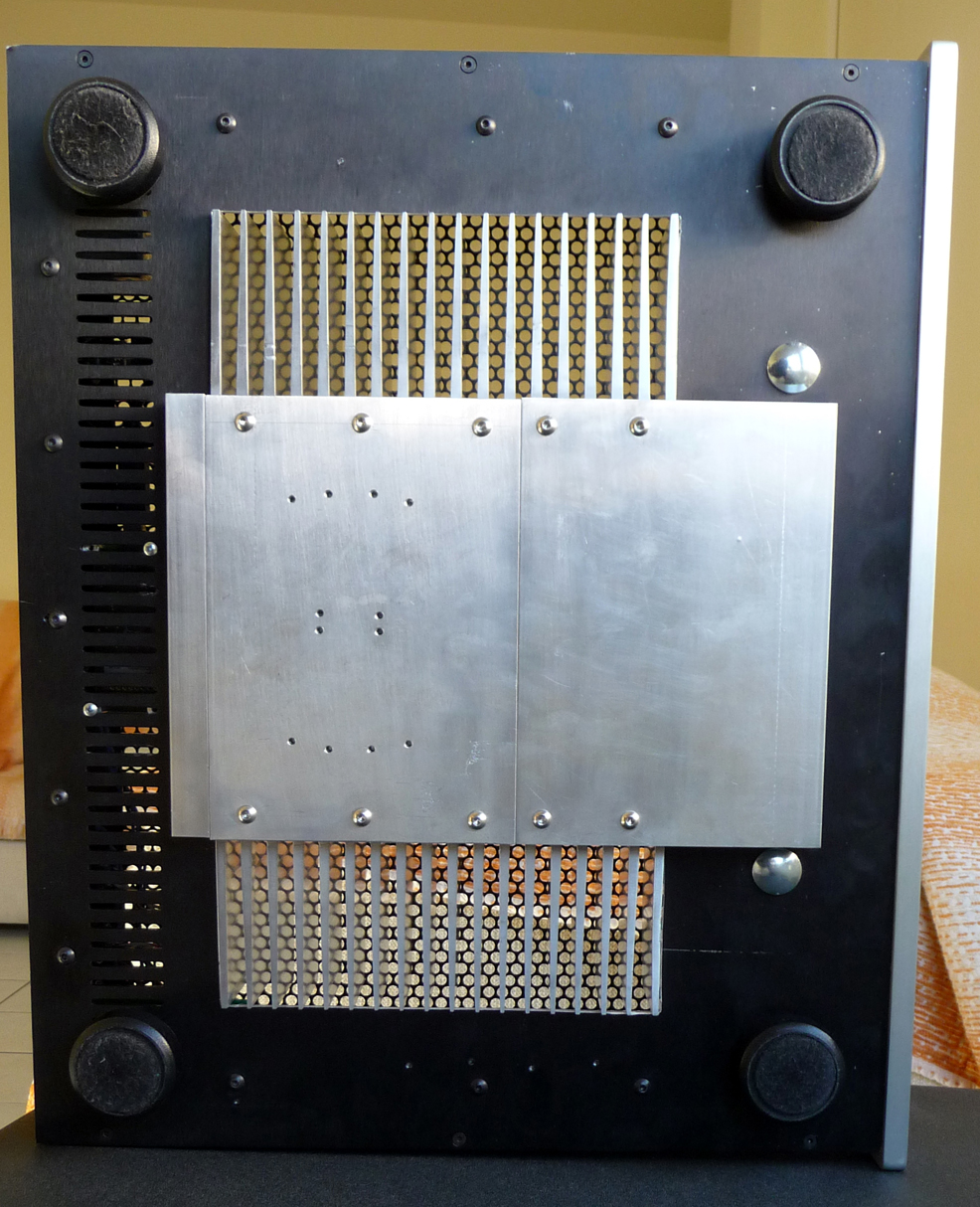

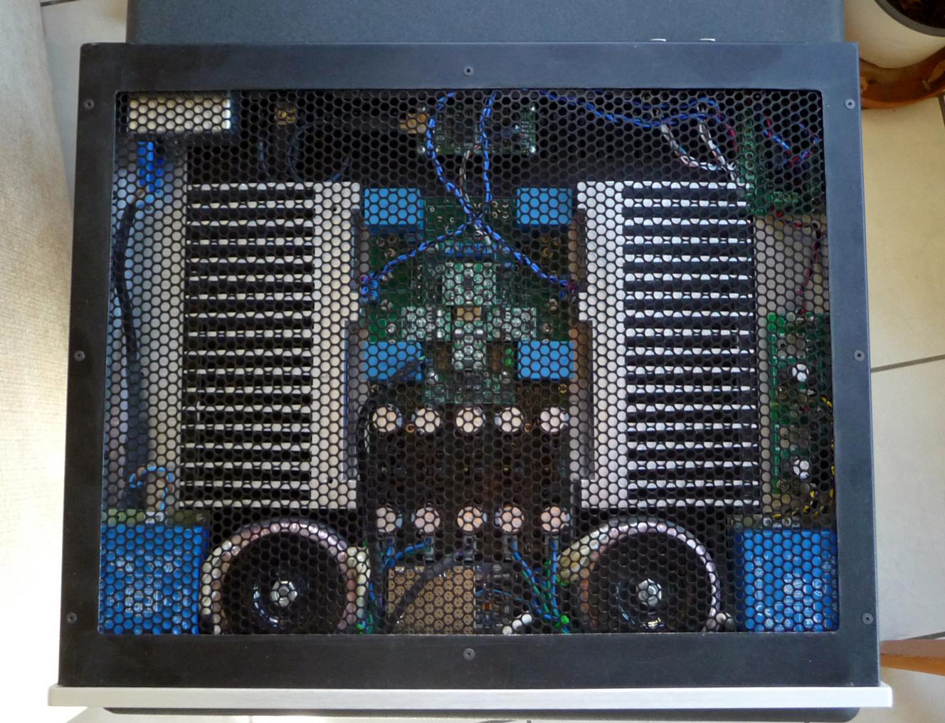

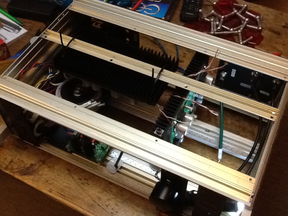

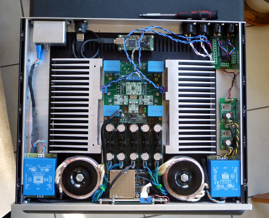

I thought that I would post a few photos of my DAC in its current state. Although not completed by any means, I believe its close.
Since having received quite a few messages concerning my NTD1 build, most of which were related to cooling, I thought it would be a good idea to post current photos of the DAC.
