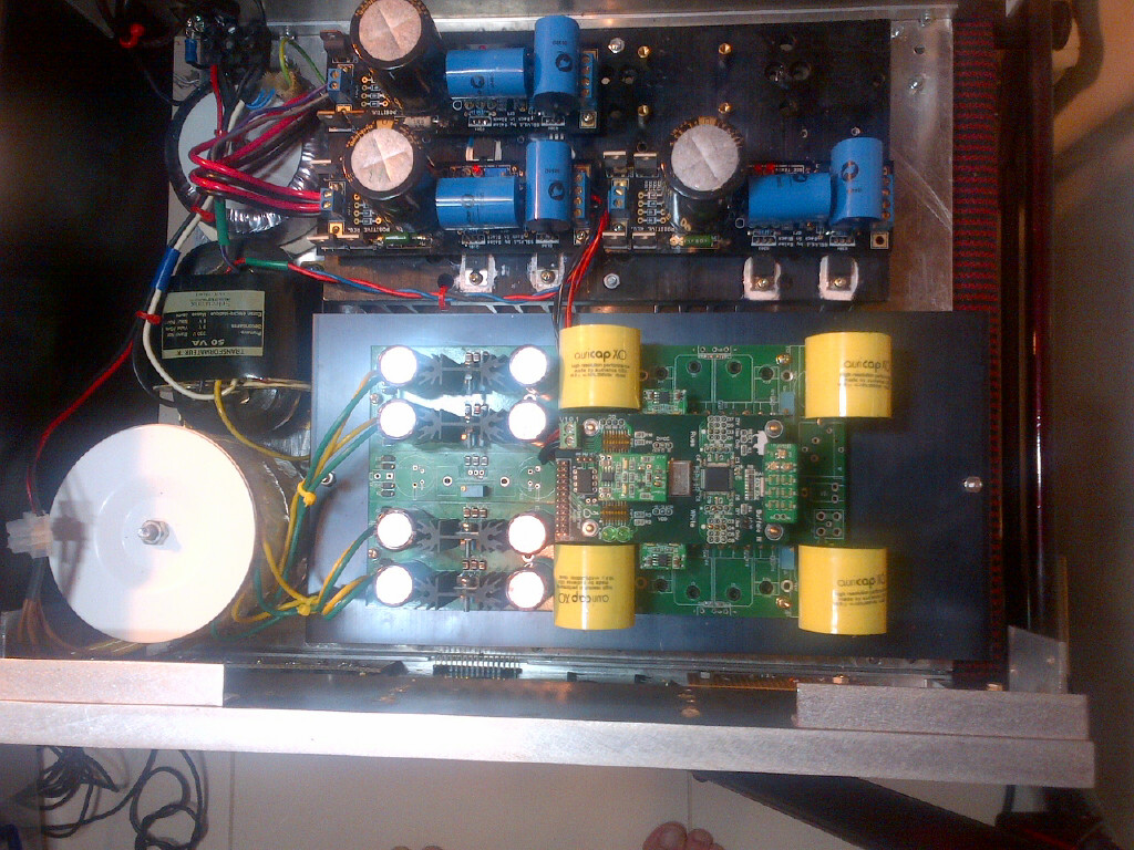

Here's a quick peek of my build... It is not the latest pics since I have added heatsinks to it.
Chassis will be done later. On a side note, has anyone modded an EXAU2I to add external power to it? If you have succeeded in doing so and it does make a difference in SQ please PM me.
I've already put in more than 30 hours of music and must say it is definitely the BEST I/V stage I have ever had for my BII!

Are in trouble: (
When Buffalo is offline I have the following voltages:
Q1: 1.65V - 21.8V
Q3: 1.65V - 23.5V
Q2: 1.65V - 23.5V
Q4: 1.65V - 23.5V
AVCC Buffalo: 3.3V - 3.3V
When connecting Buffalo:
Q1: 1.65V - 21.8V
Q3: 0.8V - 45V
Q2: 0.8V - 45V
Q4: 0.8V - 45V
AVCC Buffalo: 2.4V - 3.3V
Zener are removed.
Any advice please!
