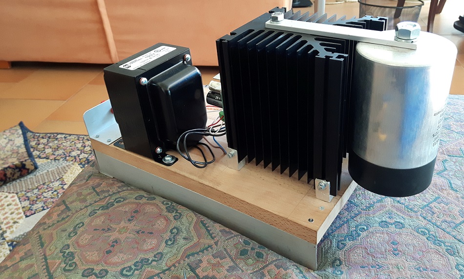

Hi MEPER
you're probably referring to my realization of the Mofo. I used that big polypropylene cap on the power supply downstream of the SMPS MeanWell.
Those big cap I paid them very little money (I also put the link for those interested ..... surplus material but in perfect condition).
I have 8 more, that I would try to use in out but being from 500uF / 900V to 6000uF I do not get there.
I took them to experiment ..... The next experiment will be using Salas ultraBiB 1.3 instead of the SMPS + MKPcaps.
My Mofo Big on attach.
PS: the link of caps.....500uF 900Vdc capacitor ISKRA KNG2047 polypropylene

Ok....so it was used for SMPS filtering and not as output cap. Could also be interesting to know how such a cap type compare against the standard E-cap. From new at RS components they are expensive.

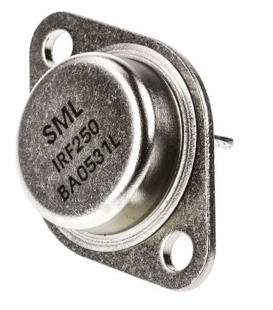

Mosfet's in TO-3 metal can package look great but is not easy to find good vintage transistors source.
Lot of fakes : eBay , Aliexpress etc.
Official distributor´s : Mouser , Digi-Key, RS or Farnell stock are genuine stuff
but TO-3 is frequently not available
https://docs-emea.rs-online.com/webdocs/156f/0900766b8156f429.pdf
Good luck :)
The heatsink I have in mind does not fit a TO-3 very well…...I think....so think it will be the modern housing. For TO-3 you need a kind of rail/bracket to mount them and then mount the rail to the heatsink. TO-3 looks nice…..I also think they can transfer the heat a little better than the plastic type housing.
