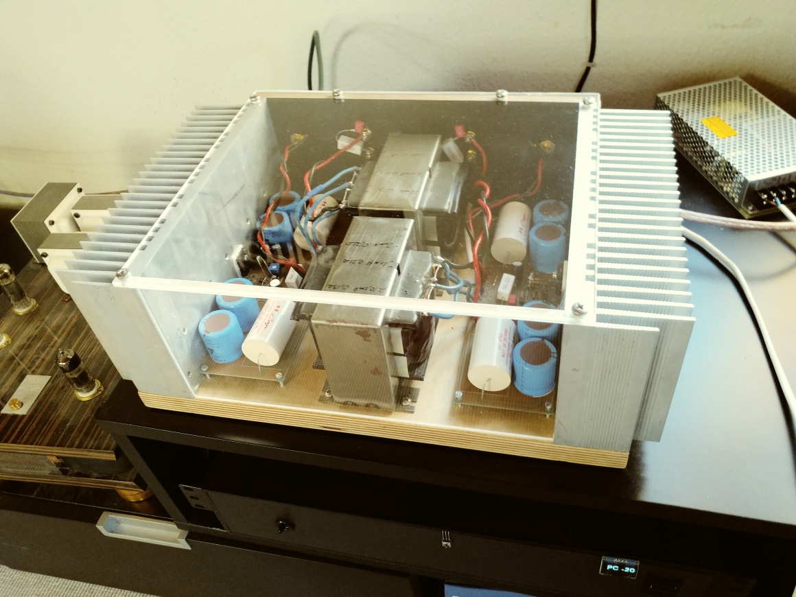

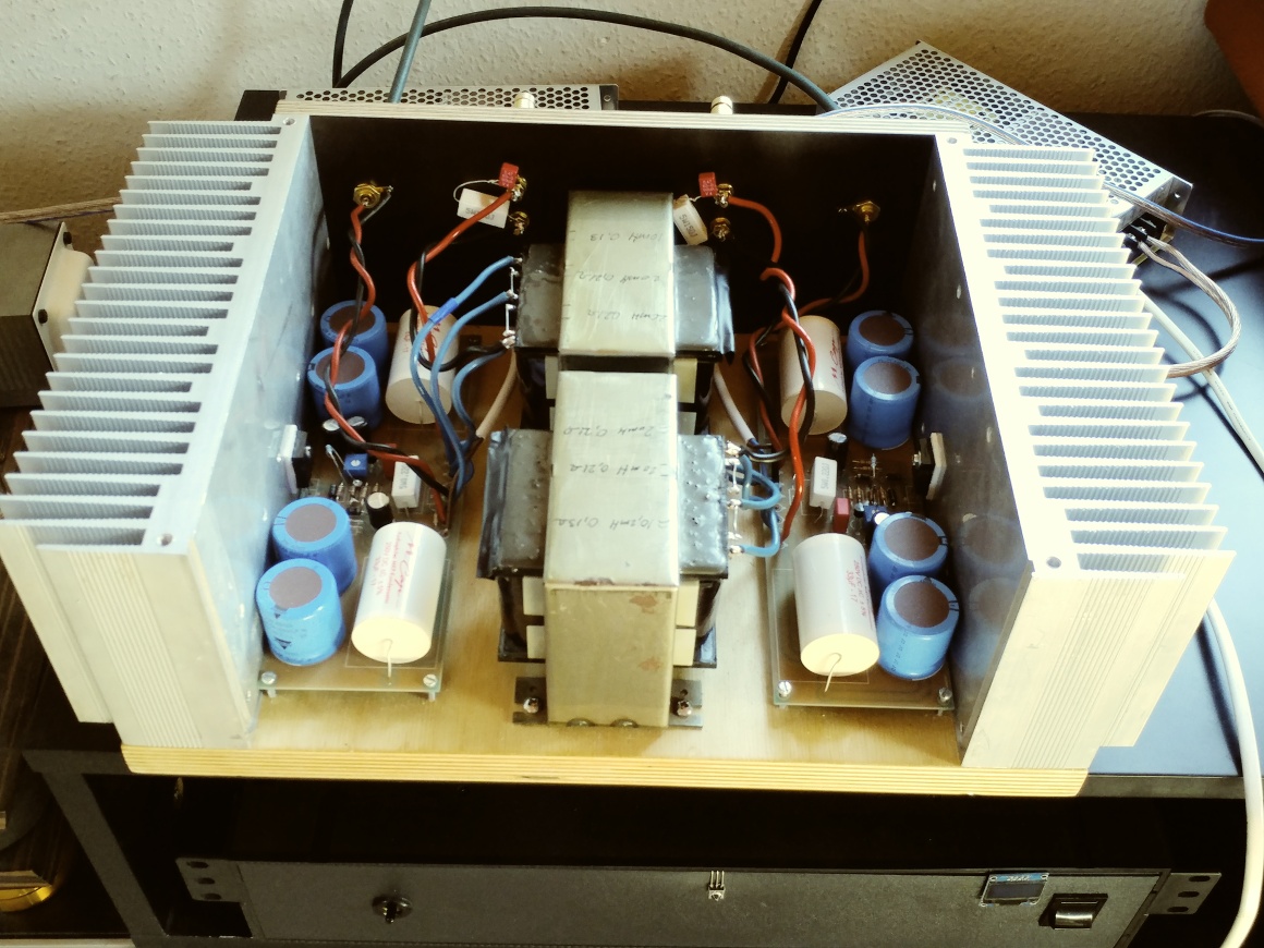

I got the transformers, boards and mosfets from Frank. Mine is not as elegant, but I have heard it play I unfortunately had to go abroad for some weeks, so thorough listening will be later..
A nice thing about this is that it does the amplification so no need for a special preamplifier..
Now it is in a nice working mode. Together with the SALs and two 15" Monacor, electronic x-over it is marvellous. The mofo substituted a tube amp, and it beats it being natural and distinct at one and the same time.
