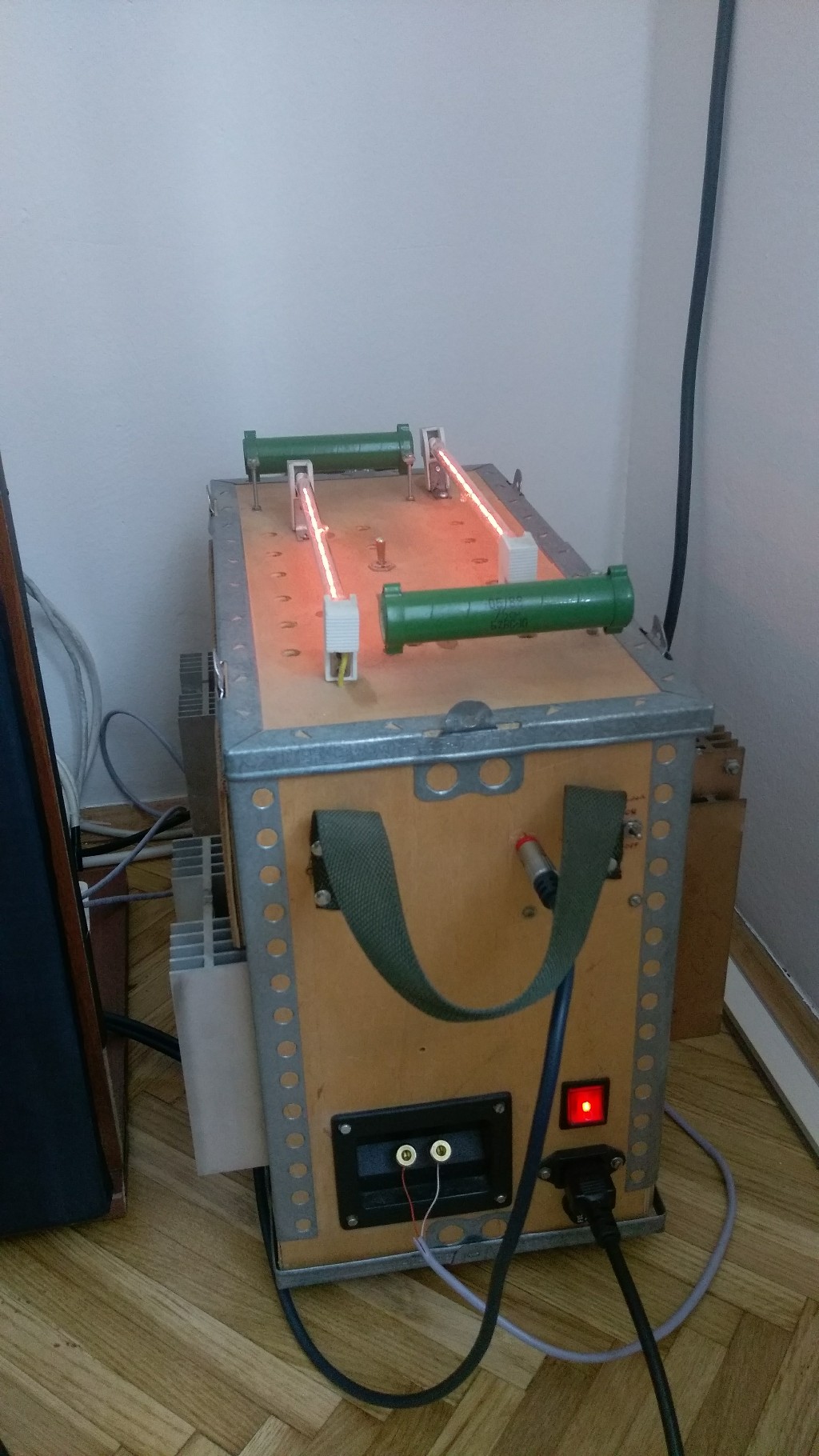

Nothing wrong with lightbulbs, except that you may need high wattage ones that are getting a bit more diffucult to obtain (leds everywhere), and/or you may find that a higher psu supply is needed, since for a proper headroom, you will want to drop around 2/3rds of the supply voltage through the lightbulb, and 1/3rd across the mosfet. With 19 v supply, it won't be enough for anything useful, but you can try. That also means readjusting the voltages on drain/source...

I have the same light bulbs, 1000W 220v
will try with 19v PSU, 12V on the bulb, 7V on the IFRP, it will bias around 0.8A

What I meant was simply reversing speaker cable connection, connect the - polarity speaker lead to the point previously connected to the + polarity lead, and + polarity speaker lead to the point previously connected to the - polarity lead. This way, phase of 2H amplifier generated distortion will shift 180 deg relative to the speaker's.
Next I will replace bulb by 2.5mH air core inductor and compare
Be careful, you cannot just swap the lightbulbs and the inductor. You have to adjust the proper Bias for each of them, since there should be much lower voltage across the inductor than the lightbulb...

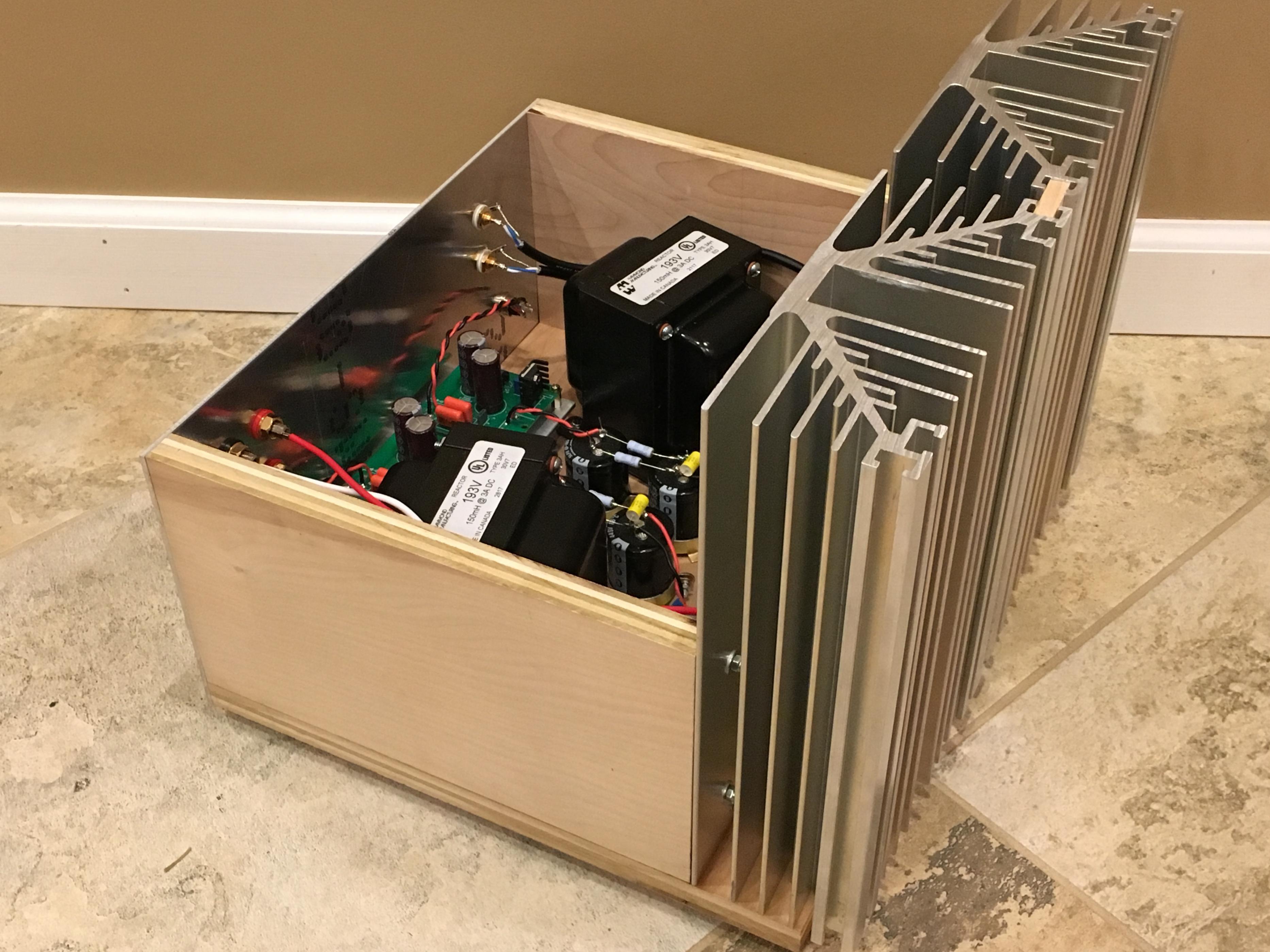

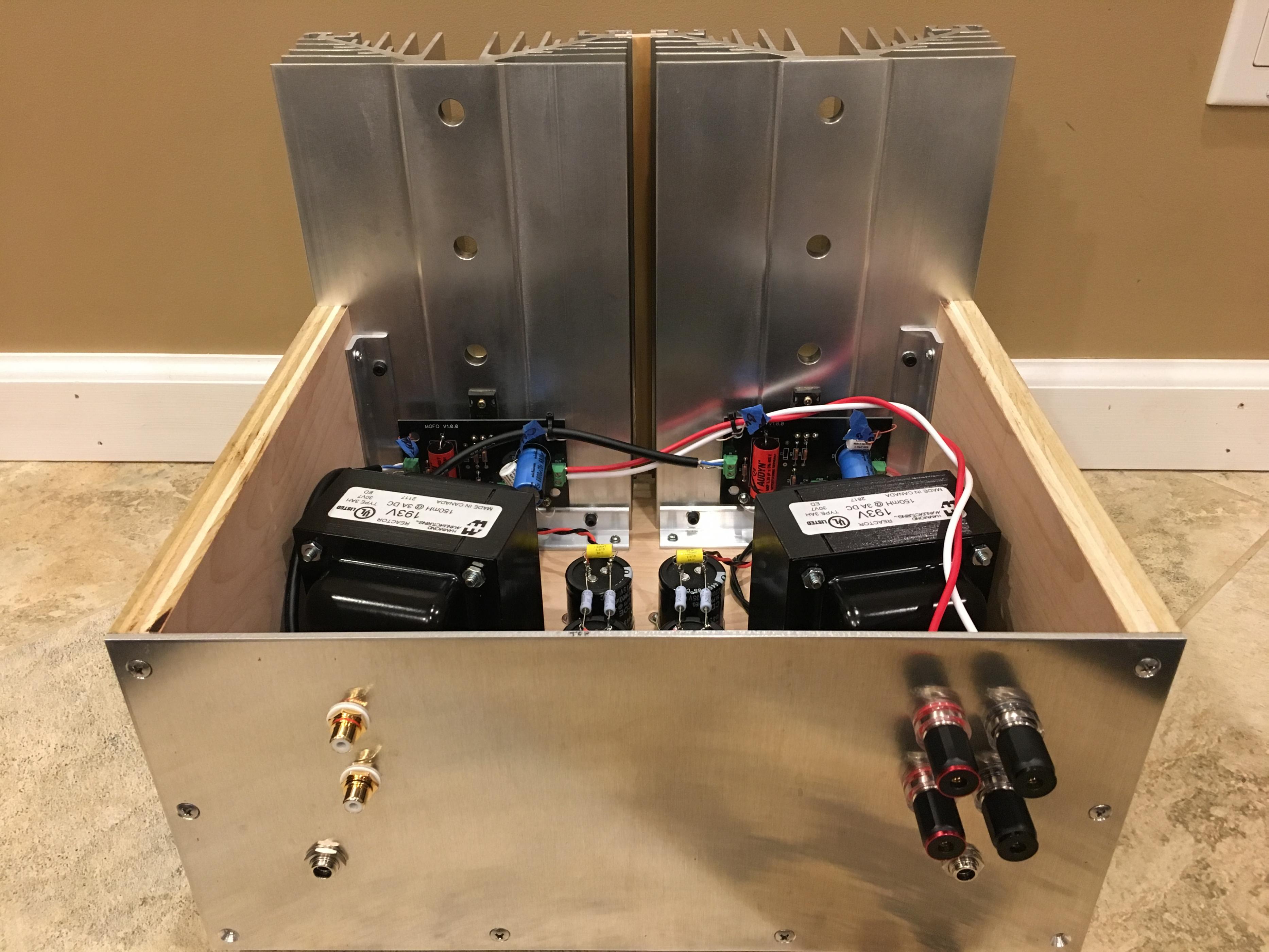

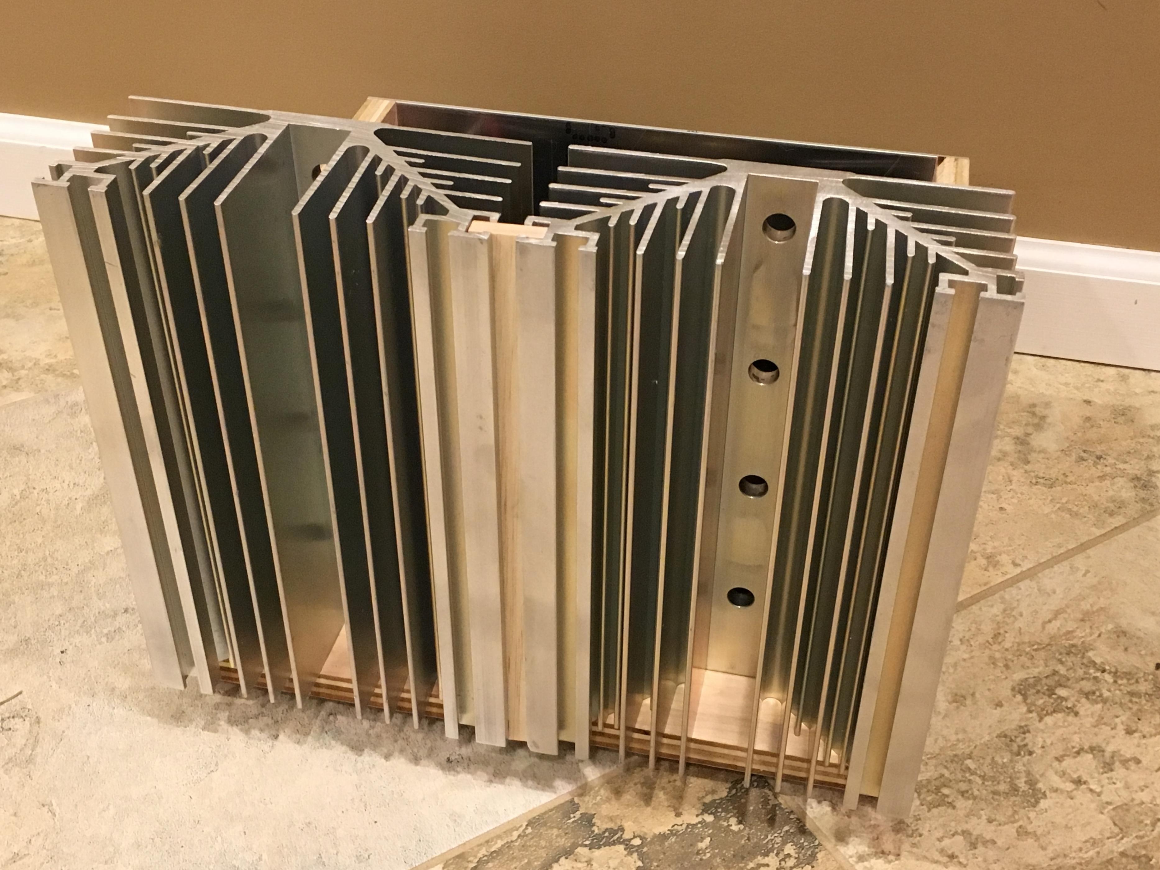

Almost finished with my Big MoFo build, still have a few details to button up. This is probably the quietest amplifier I own!! Absolutely no noise of any kind with my ear pressed up to a very efficient set of Klipsch speakers.
Thanks Michael Rothatcher!!
