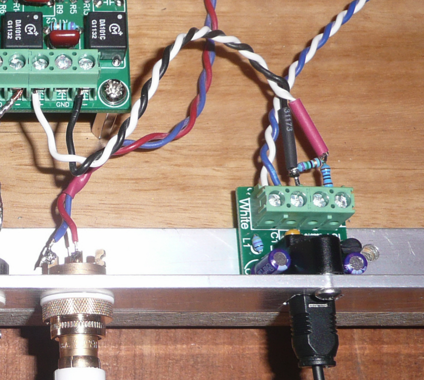

You have to make sure pin 6 and 8 are pulled up. (say with 10K) That is normally done by the controller. With a stock B3 this is done by the on-board controller. You your case you need to be sure *your* controller does the same thing, or do it externally.
Where exactly do I put the 10K resistor? Although with my relay switching implementation I assume I dont need it?
As for the TOSLINK module - you may need to check that you are getting a good signal out of it. If you have the voltage divider working correctly the output should be equivalent to the consumer level signals.
Also make sure that since you are using the voltage divider you terminate the SPDIF-4 input you are using for that signal at 75R just like the other consumer level inputs.
I'll check the signal, I am using a 75R.
Thanks for the help
Thanks. The spdif input for the sabre32 should be rock solid. One idea is to directly connect the toslink output to the input of the BIII and avoid all the "unnecessary" level conversion. One way to do this is to tap the ribbon cable. Another way is to solder to the pins at the bottom of the pin header
I would suggest using grid connectors to simply connect the pins the way you want them.
I'm not sure exactly what you mean but let me go & ponder, it is early & the brain is still hazy
The lock on the Spdif is rock solid
