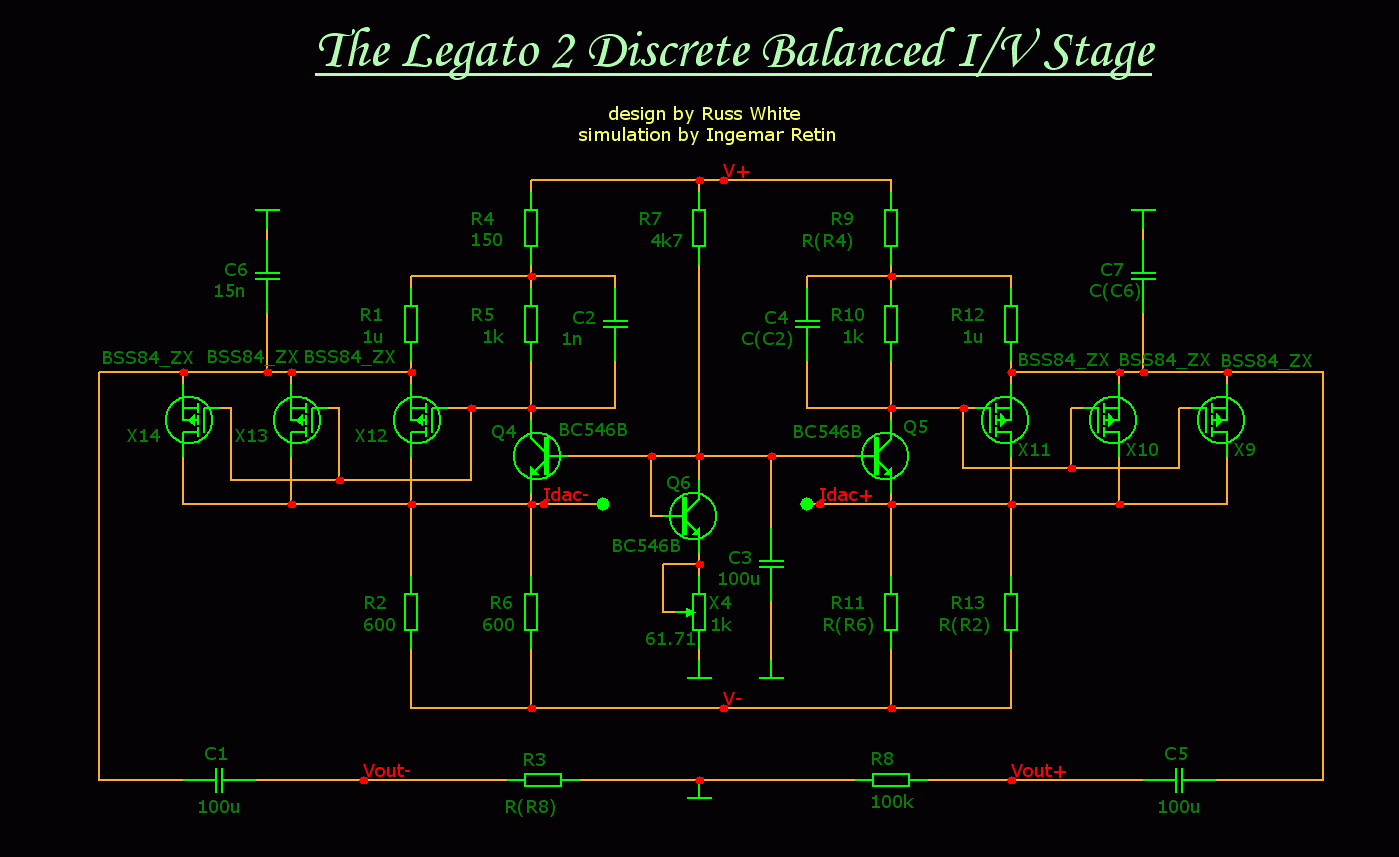

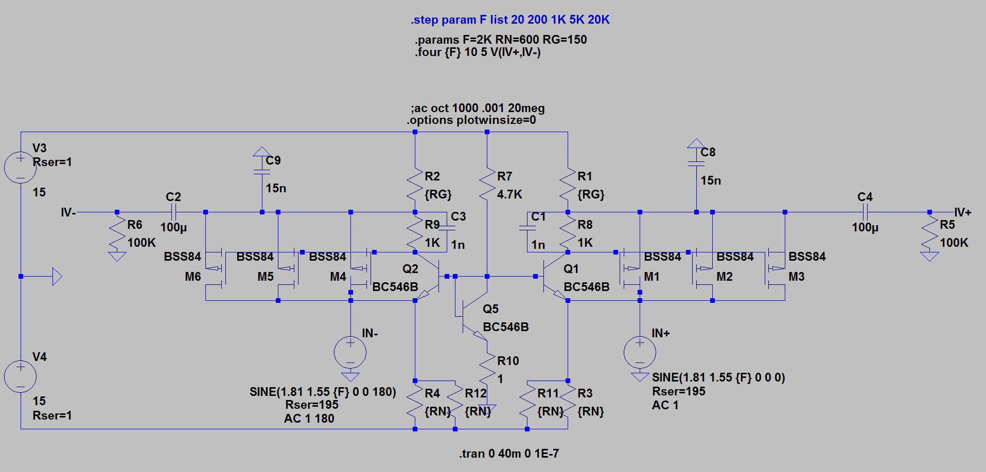

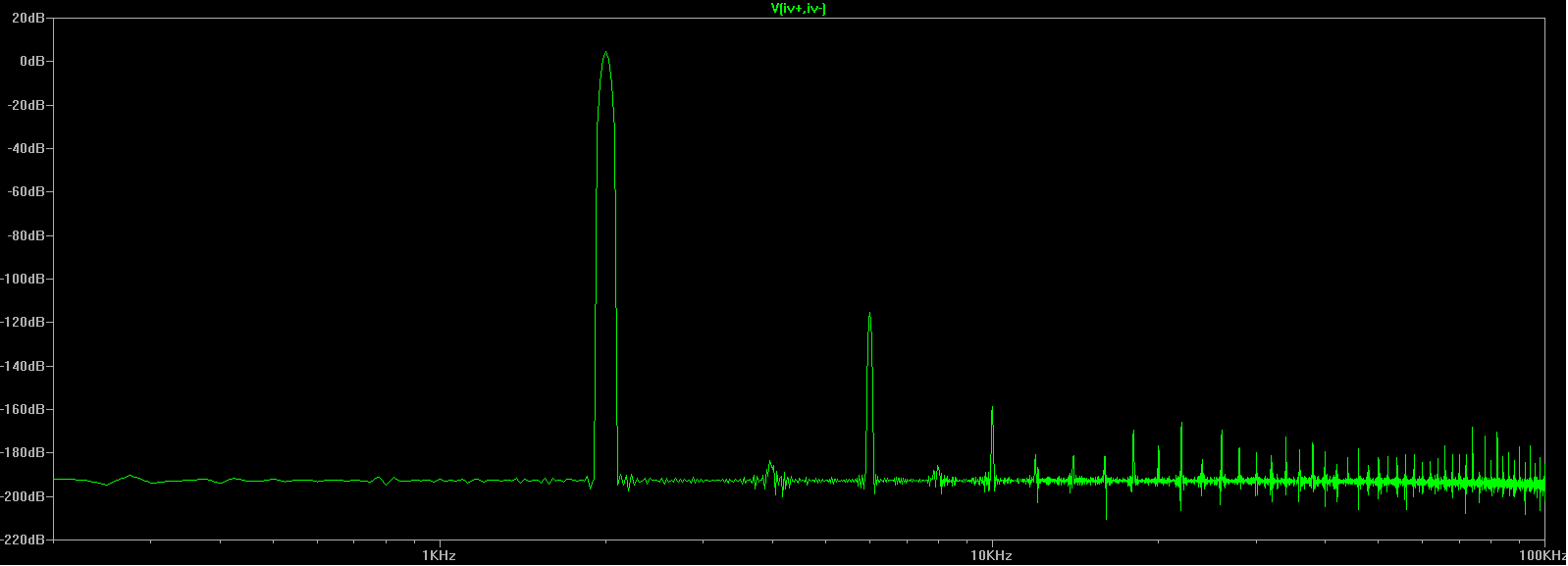

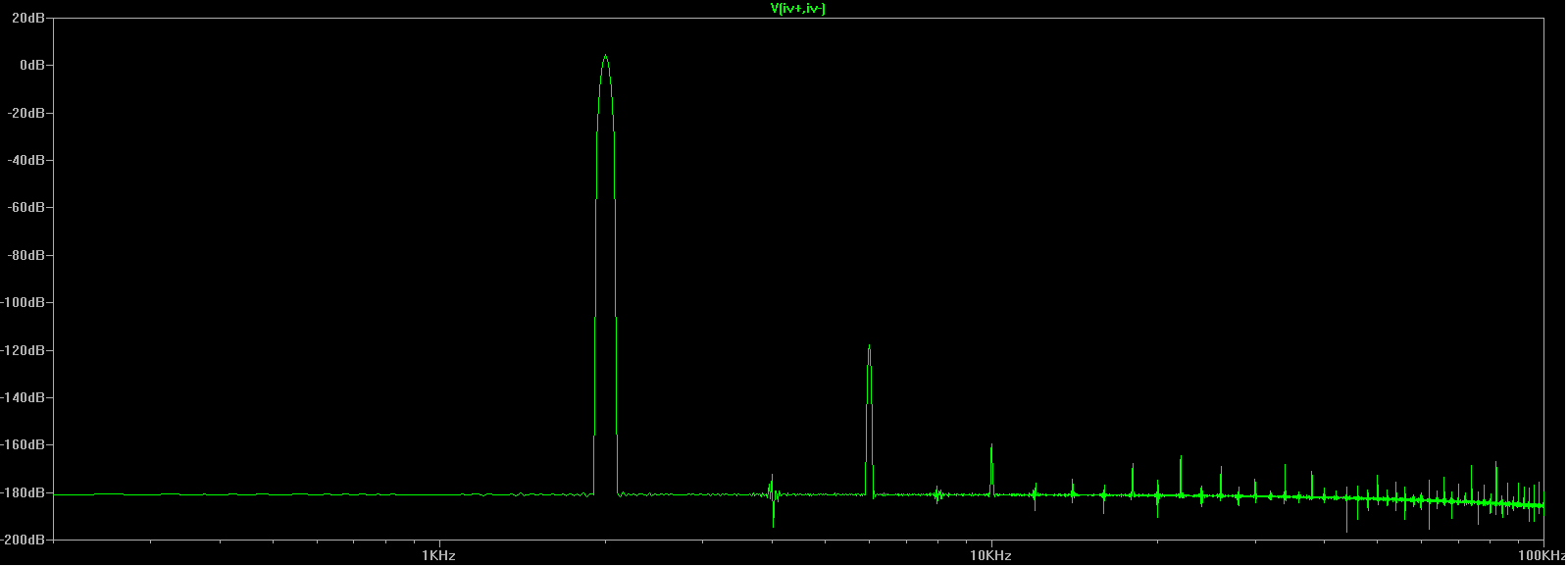

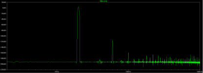

Here is what my Legato II simulation shows:
The first is dual mono with 75R I/V and 150R(2 x 300 parallel) CCS and the common mode set to GND.
The second is stereo with those resistors doubled common mode still at GND.
The H3 is -123db for stereo and -121db for dual mono both THD numbers are so low as to be equivalent. The only real difference is that the dual mono will have lower output impedance and run nice and warm(but still ok). :)
Cheers!
Russ

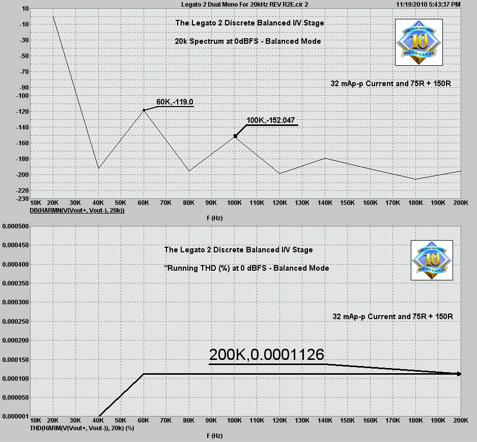

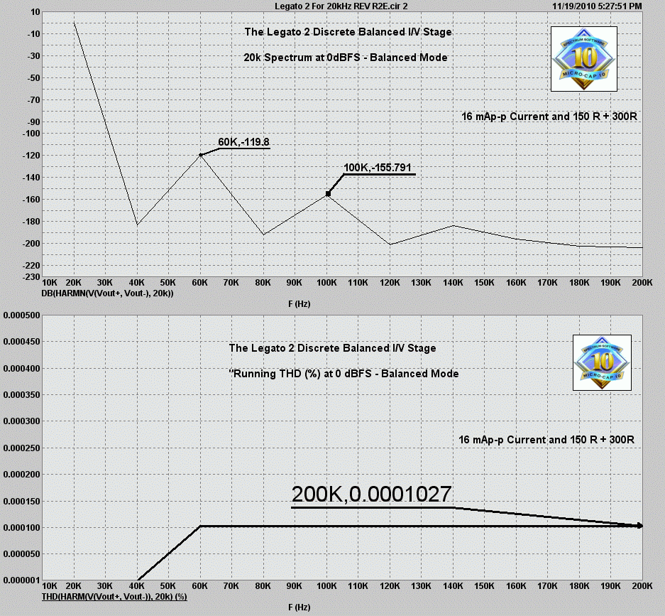

I also simulated the Legato 2,
and my result simulated in MicroCap10 for normal stereo balaqnced mode is as in the attachments.
Very similart to what Russ simulated in LT Spice. -120 dB at 3rd harmonics (60 kHz) at 0 dBFS.
/IR

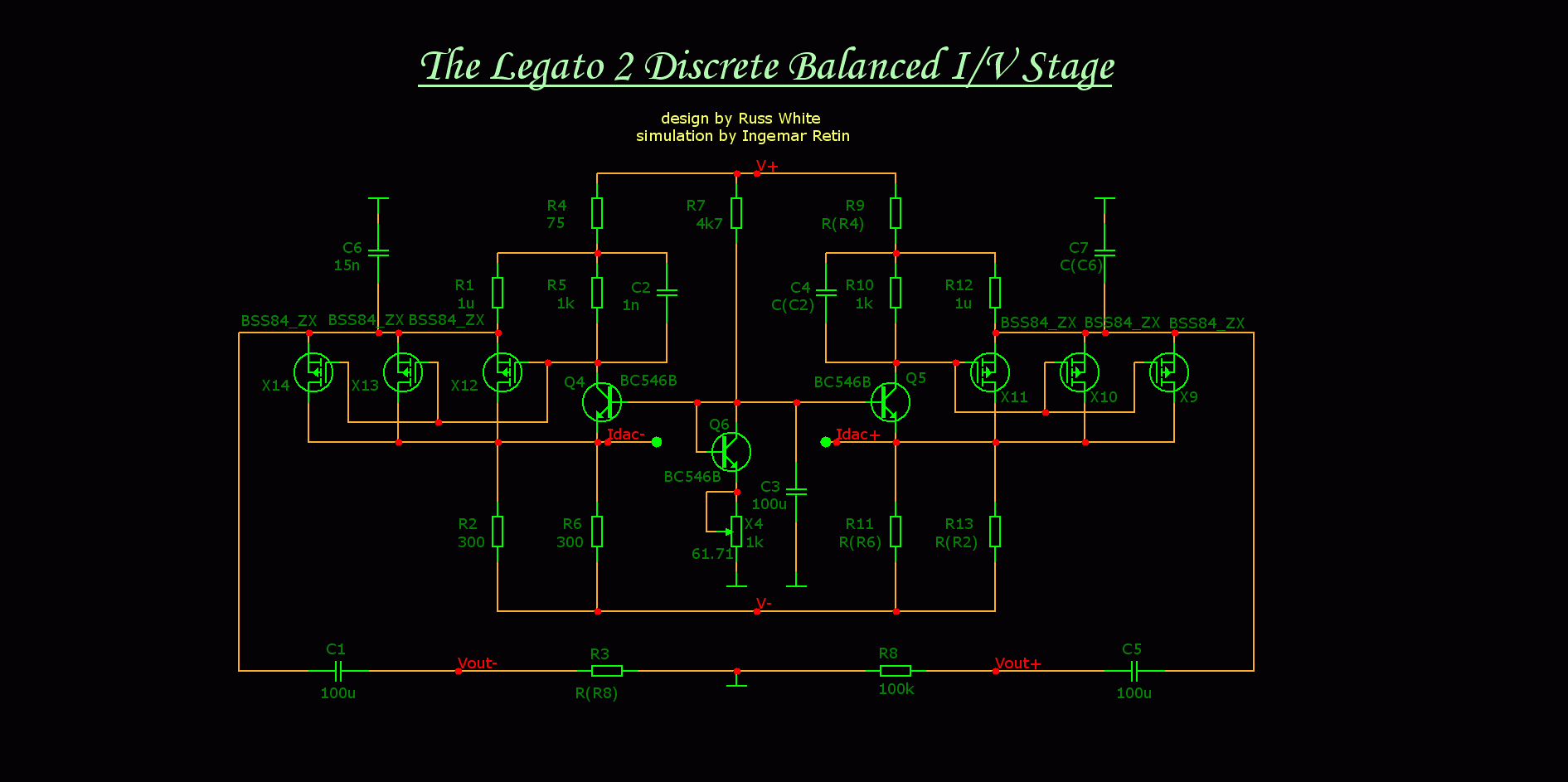

Here's my sim with dual ESS9018s feeding the Legato 2 with
75R and 150R.
-119 dB at 3rd harmonics (60 kHz) at 0 dBFS.
/IR

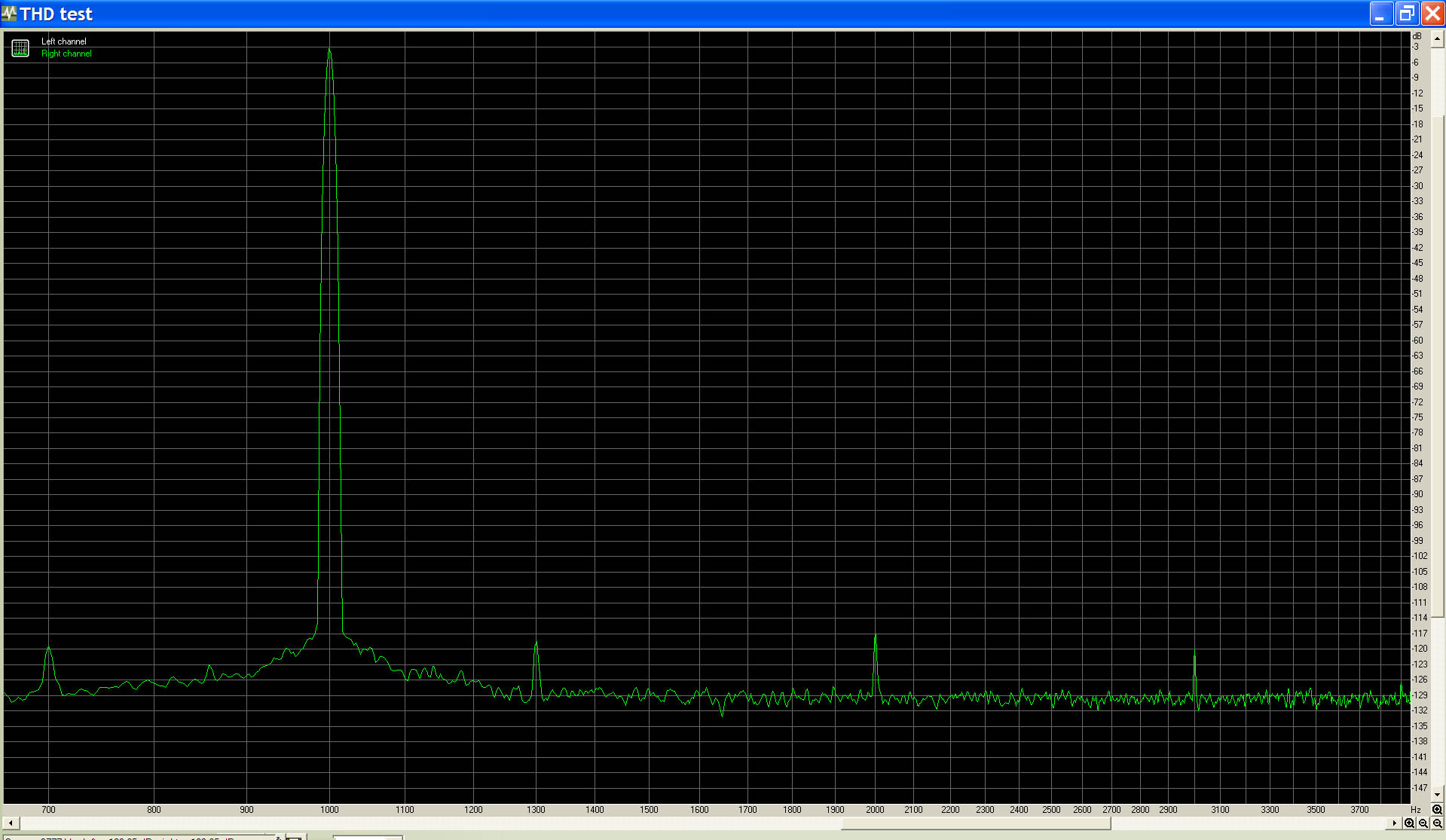

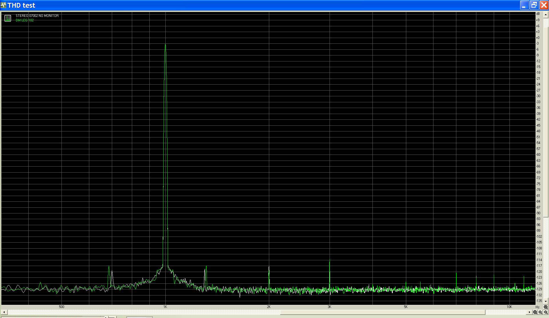

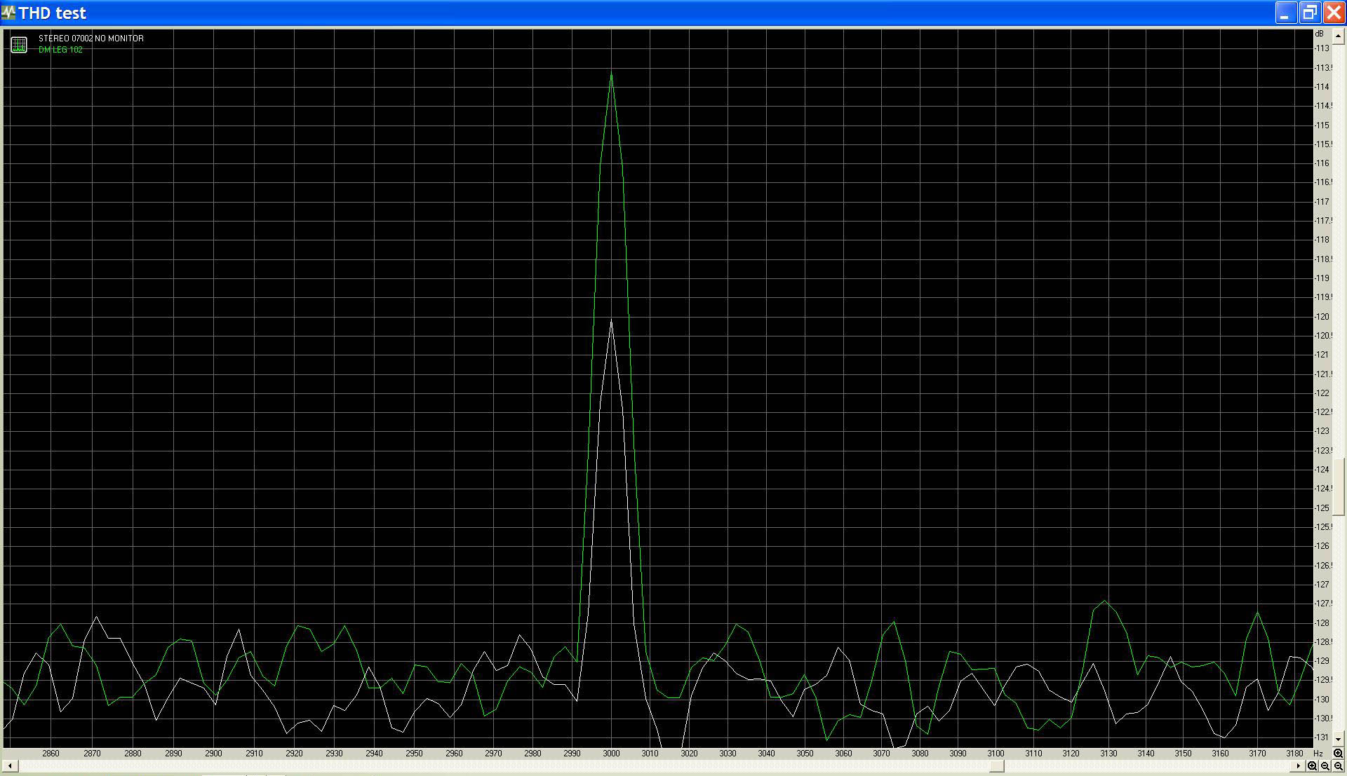

Hi Guys
It is not that I do not trust simulations ..well maybe just a little...
So having real measurements that confirm simulations have been really tempting... it took me some time but finally I have got something. Normally I would hesitate to post this kind of “measurements” but they "surprisingly" seems to be well correlated to simulations...
Please mind that as at the moment I'm talking about Legato1 ..
I hope some of You will find them interesting.
First few remarks:
All of measurements have been done with at 48kHz FS and RMAA6.2 demo version.
Using Laptop with WinXP ruining from batteries.
For demo version of RMAA 6.2 I could only use program default 1kHz THD signal.
Signal have been send to HiFace USB then with I2S to Buffalo and from Buffalo to Legato and depending on measurements in Dual Mono or Stereo set-up.
I did mount LM op-amp to have SE output from Legato.
First some system noise for reference:
Second Normal Stereo setup.
Third Dual Mono Setup
Fourth Both Stereo and Dual Mono at the same graph
And last close-up of 2-nd and 3 -rd harmonics.
CDN

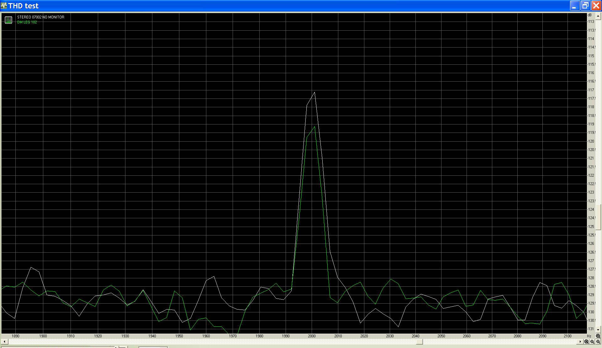

Hi
As for my measurements ... I hope they do load and can be seen...
Now there is a question If they are worth to be seen and how seriously we can treat them...
Well they have been made with 100USD EMU202 and we do look for sub -110dB changes....
So there are definitively not extremely accurate ..but... I did made much more of this measurements and they are repeatable with reasonable accuracy and they seems to be very well going on with IngermarR simulations...if not for the exact numbers, then for the system behaviour..
We can clearly see that with Duall mono setup third harmonics (3kHz) is definitely going up comparing to stereo setup ...exactly as in simulations....
This what can be seen and have been absent at simulations is strong presence of second harmonics...(2kHz)
....and now question is if this is effect of measurement setup or real life Legato is not perfectly symmetrical, well elements used to build it … And this is something simulations did not show us... Of cause Simulations did not include presence of LM opamp and this for sure have also strong influence on real life performance.
There is also important measurement issue that Dual Mono setup VS Stereo setup have +6dB output signal difference... well and at list few others things also.....
But as for proving the 3-rd harmonics increase with Dual Mono 1 Legato (!!!) setup this have done the job ….
Rosendorfer
HI Rosendorfer, your measurements are very similar to mine using a sound card.
There will always be some small amount of of H2 distortion. If you are measuring the single ended output (after BAL/SE stage) this will very definitely be true.
If you can, please try measuring only the balanced outputs (you will have to look at the difference between + and -).
All in all those are very good measurements by anyone's standards. Thanks for posting! :)
The reason for the slight higher H3 dual mono is because the input impedance is not infinitely low, so you get a bit more modulation at the input at full scale. But at anything 6db down or more there will actually be advantages. :)
Good work!

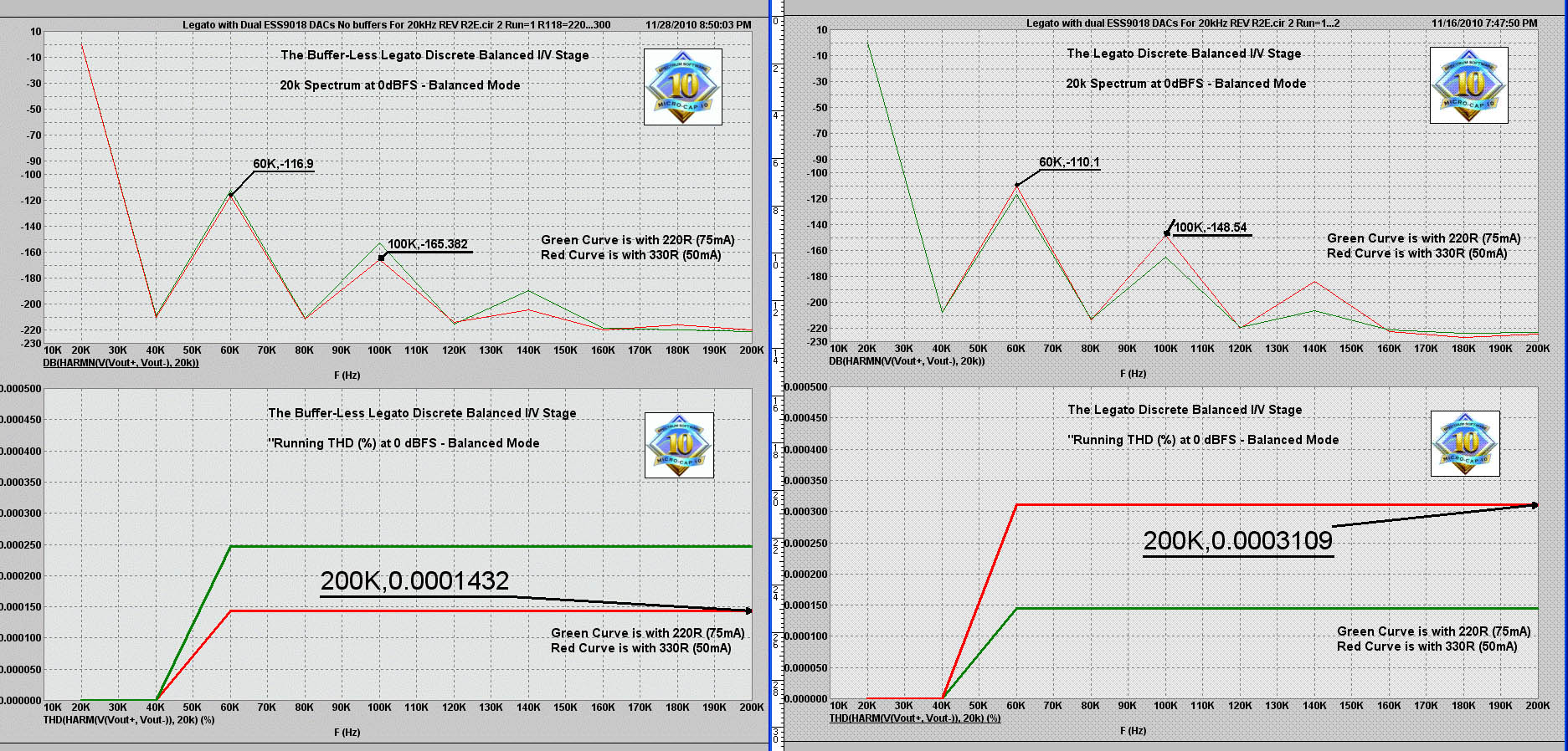

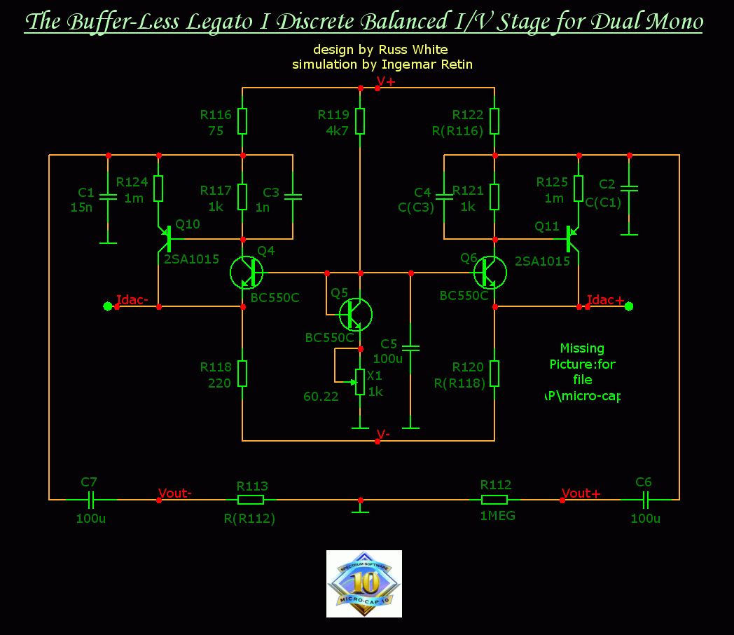

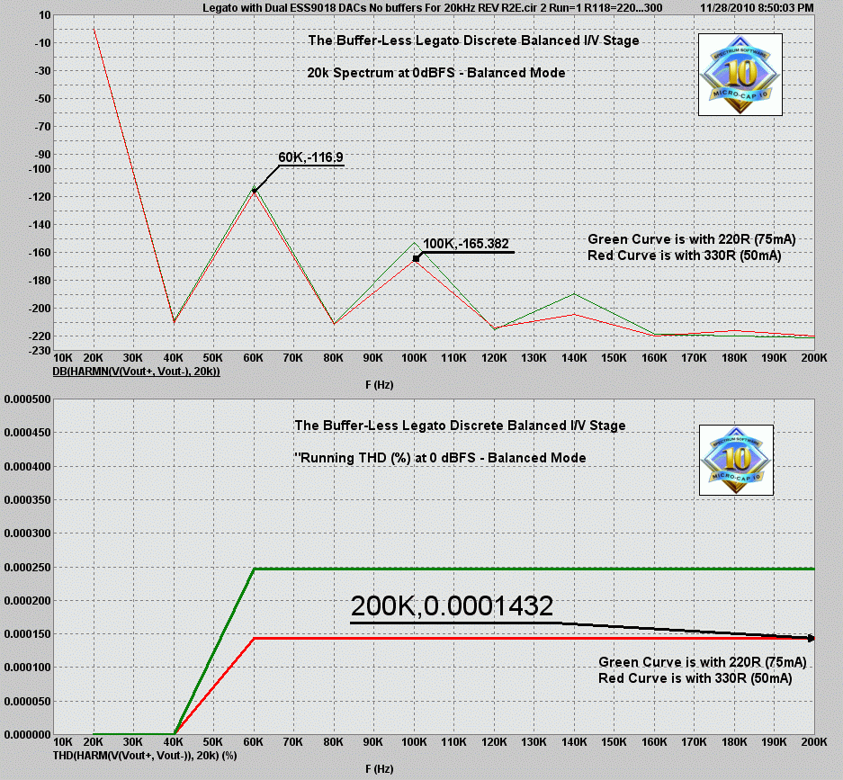

Rosendorfer, here is a simulation of a balanced version of a buffer less L1 used by two ESS9018 DACs..
IV-resistor is 75 Ohms.
Dual ESS9018s feeding a Buffer less Legato 1.
Vout_balanced = 1,64 VACrms.
/IR

Could You make simulation for single ended output and if possible also output without the buffer, so we can see if this is making any difference.
60kHz 3-rd harmonics at -110dB is absolutely great resoult ...:cool: but I'm bit puzzled why there is so big difference against normall stereo version @ -125,6dB, specially that it seems that this is not simply corelated with higher output level.
And any chances You could run Your simulation on "parallel mosfets" Legato 2 version....?
Best Regards
Rosendorfer

In simulations with balanced amplifiers like this, even order harmonics will cancel out as the semiconductors used are exactly identical, which will never be the case in real life. Thus, even order harmonics will not cancel out as in simulations.
Good work!
/IR

The initial design did use all BJTs and small signal types are fine here.
They actually work quite well.
I prefer the MOSFETs right now simply because the CFP just worked a little better in practice with MOSFETs. I just sounds better to me, but don't ask me to explain why. :) If initial measurements and simulations hold true, the change to FETs also produces lower distortion.
Cheers!
Russ

But I have been looking at Your Buffer Less Legato 1 simulation and comparing to Legato1 with Buffer and THD for 3H - at 60kHz changed from -110dB to -116,9 dB .. and totall THD from 0,0003109 to 0,0001432 and this could explain why Russ is telling that when not needed it is better to go without Buffer....
But why this change is only at 50mA CCS standing current, R=330 RED Line?? and almoust nothing or even worst resoults for 75mA, R=220 Green Line..?? . Any possible explanation ... Or do I miss something..?
For both sim I/V R is 75Ohm...
Rosendorfer

When I say that your measurements include BOTH distorsion from the ESS9018 (Buffalo 2) and the Legato 1, am I then correct?
Did you use the buffer on the Legato 1?
/IR
