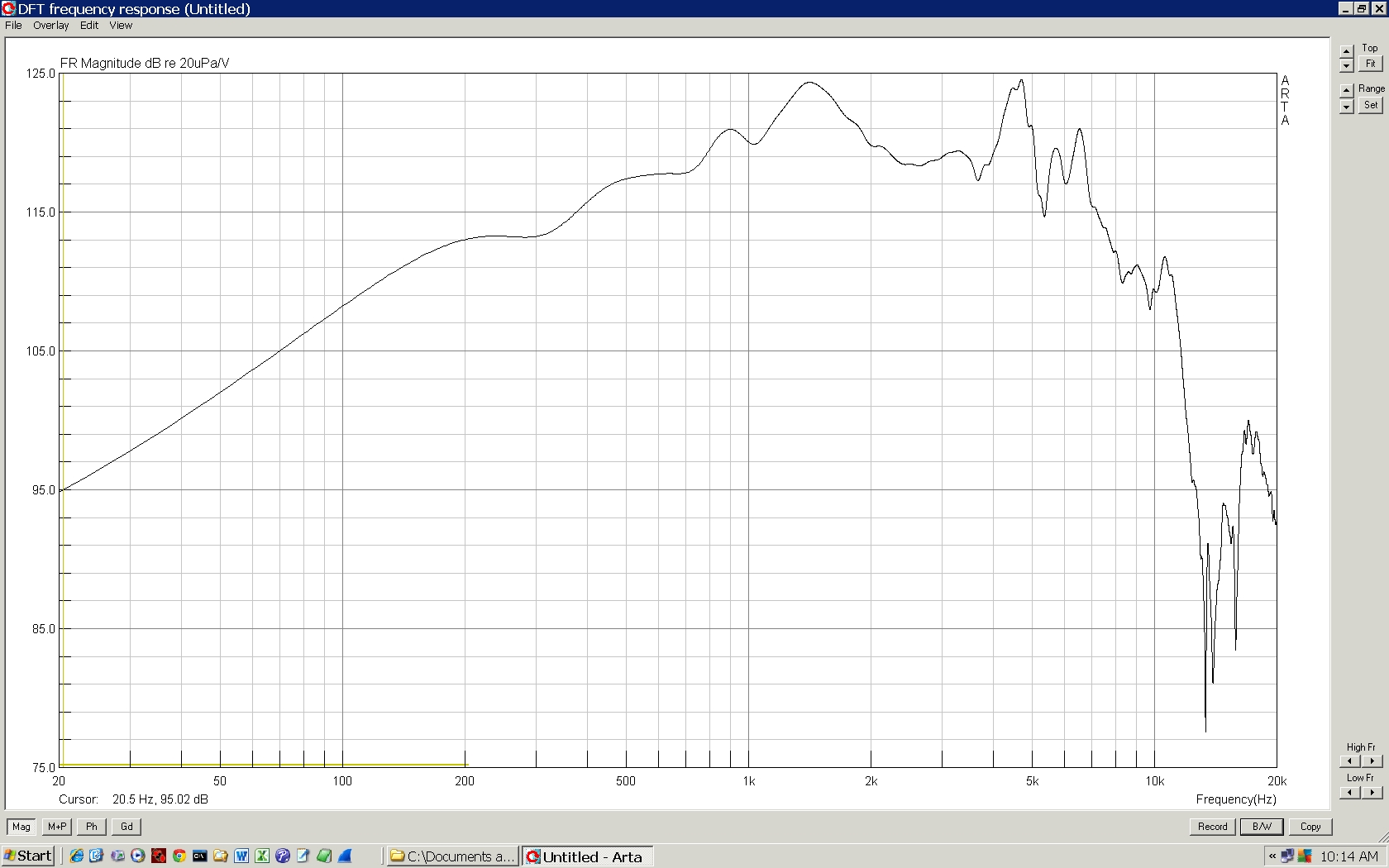

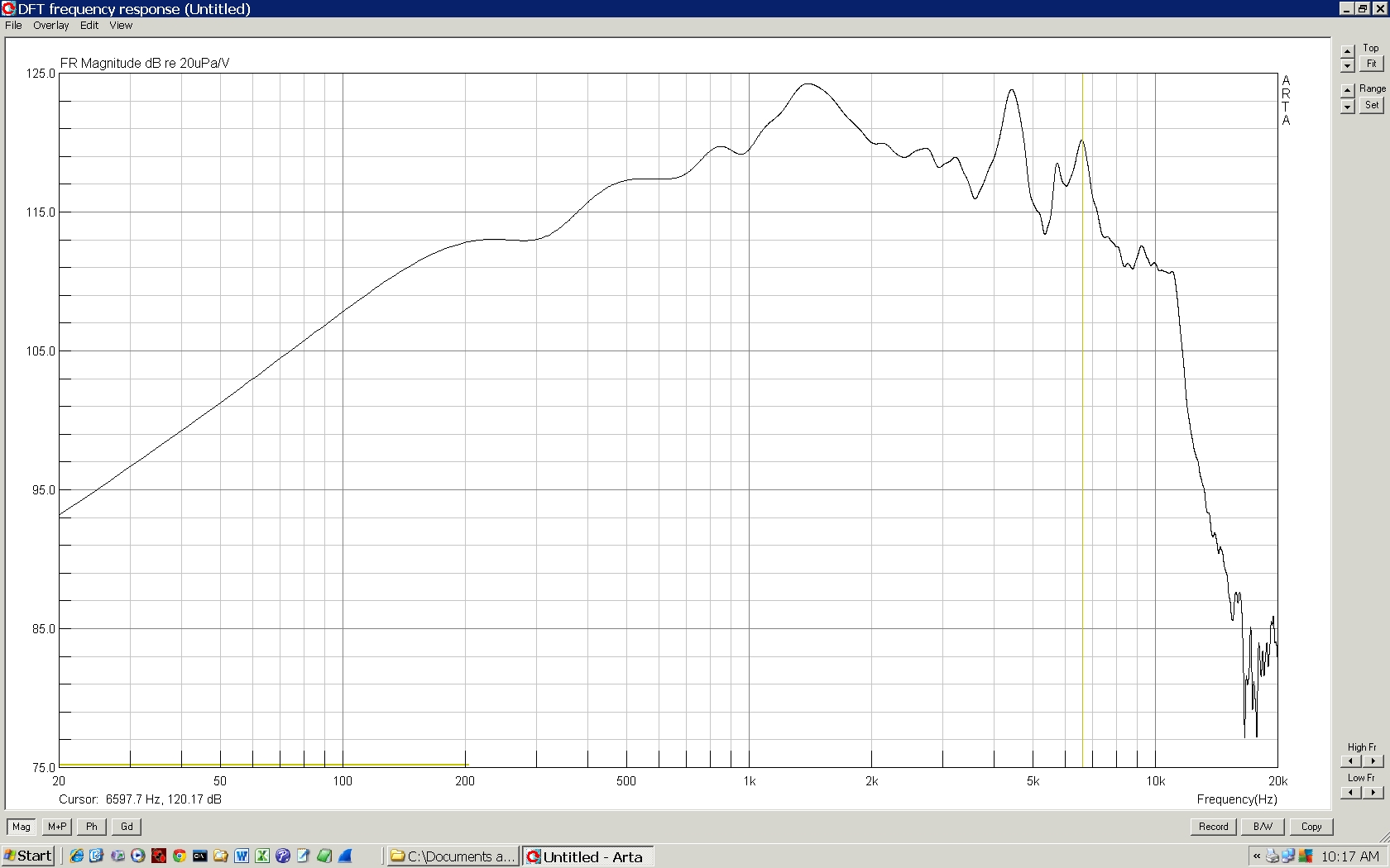

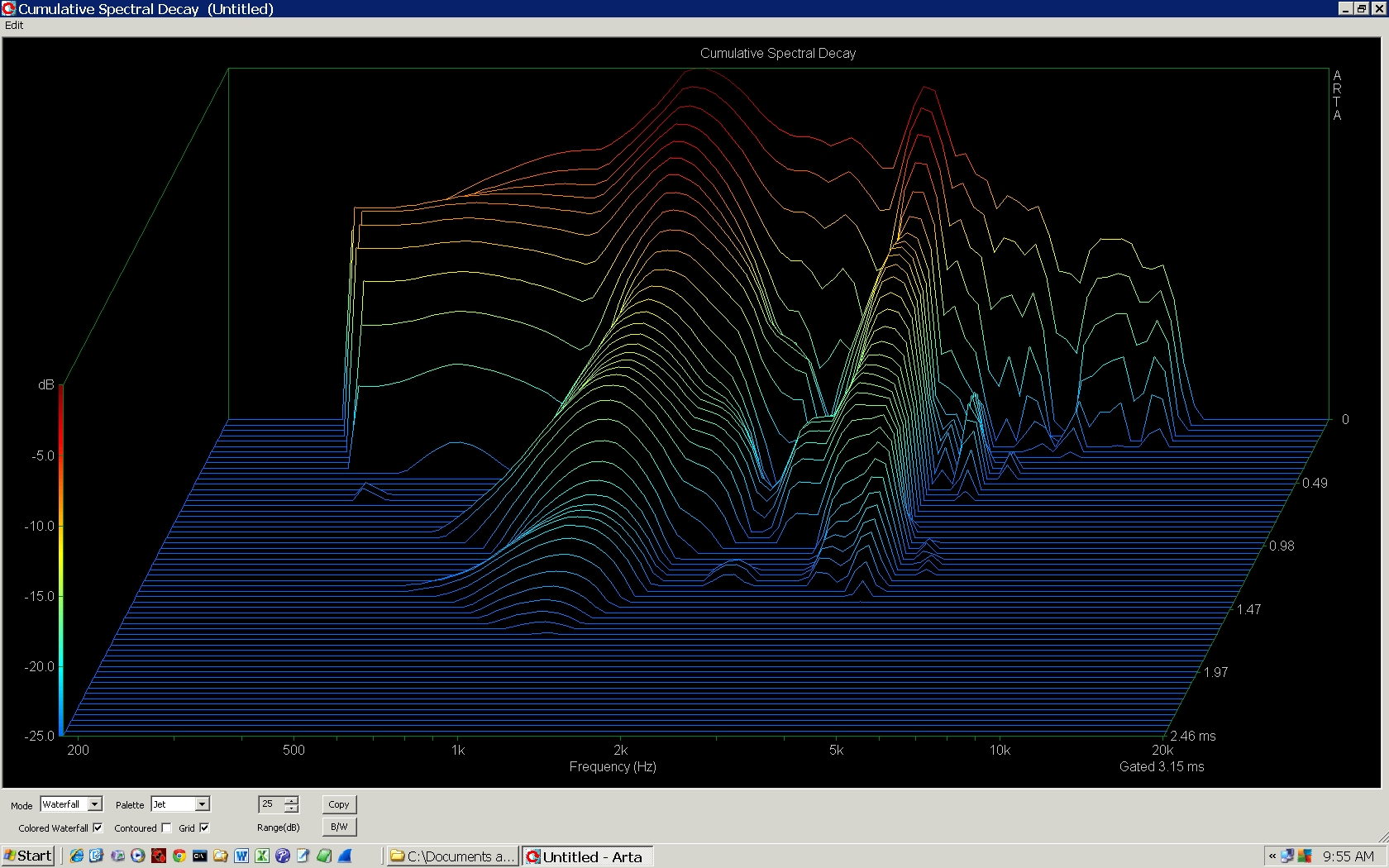

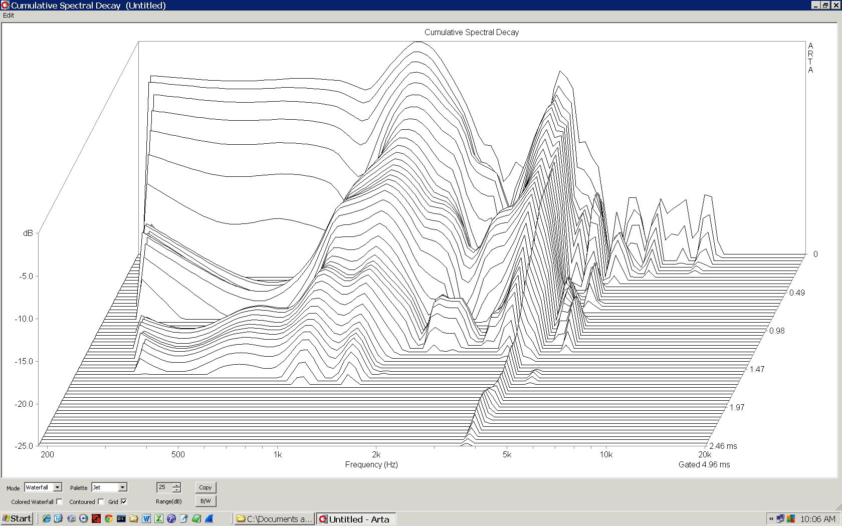

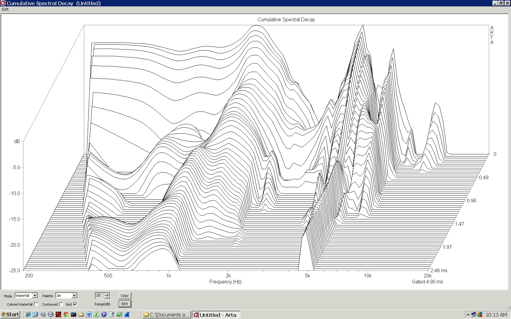

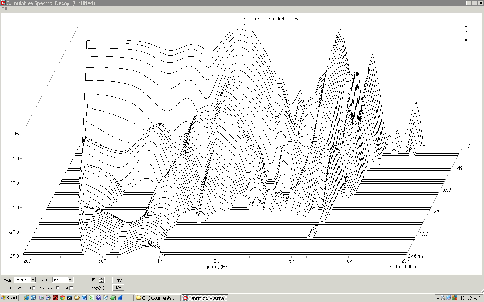

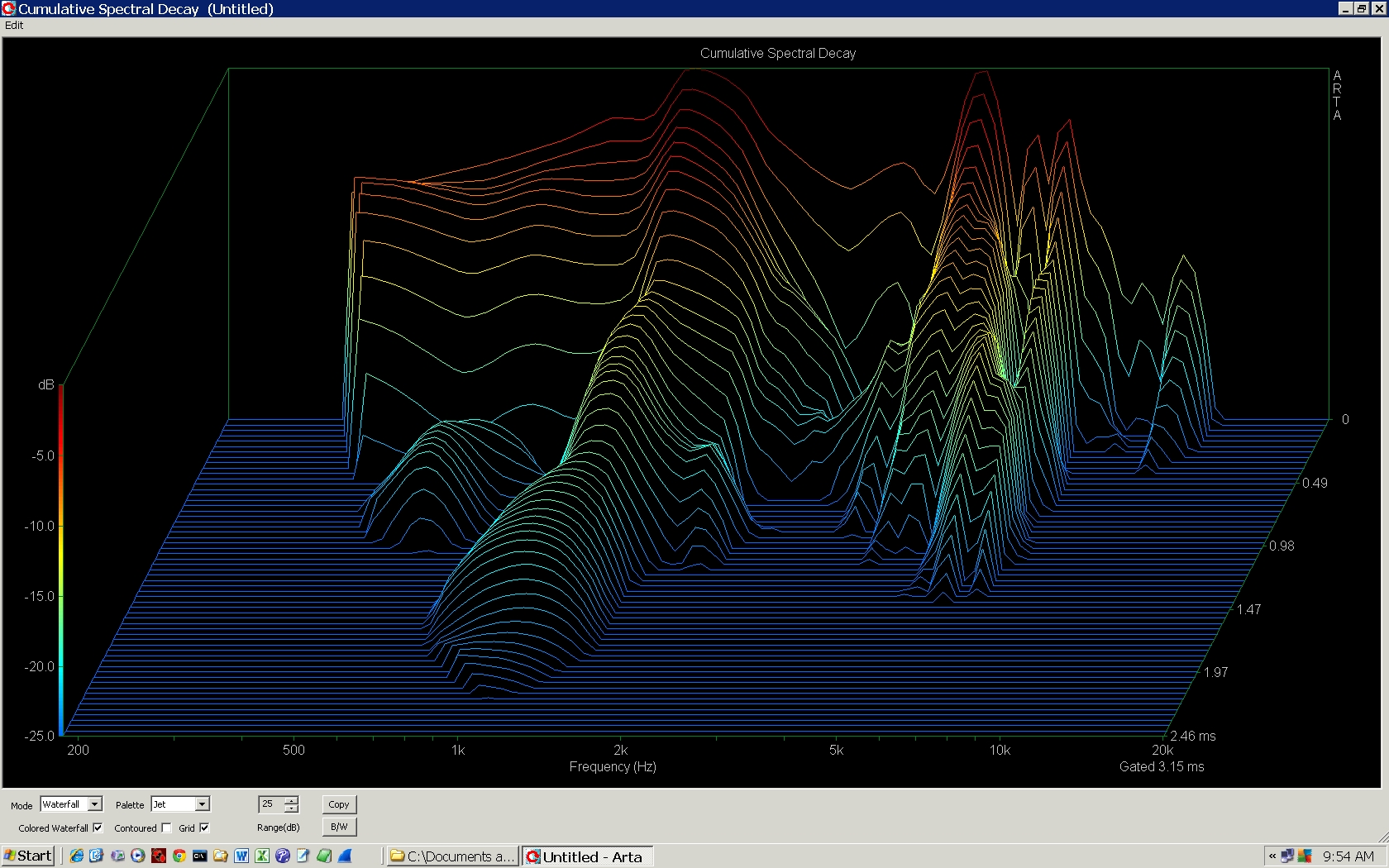

Easier to see. slightly more consistent. Easier to draw come conclusions.
Phase plug helped the bottom end a lot. Note, the cone is also doped on this one requiring about a 50% larger box for the same bass performance. If doing an AV/sub setup, not a problem. If a stand-alone monitor, yea.
Cap mod did not as much for frequency response ( another day curing?) but did wonders for decay times.
Raw driver rings till the cows come home.
From just this, the doped phase plug with a notch at 3635Hz would be a good bet. More to do. I thought the 900Hz hump was mostly baffle, but not so. I need to investigate it.

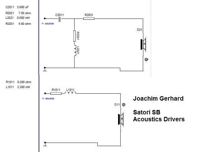

I really can't see much better than the simple left hand filter for the simple raw driver. Joachim Gerhard goes for this right hand filter for the extended frequency response SB Satori driver. Which may be where you are heading with your mods, but I think even Joachim concedes that Jeff Bagby did a better job in time aligning on a sloped baffle with his Satori take.

Looking at the waterfall and listening to the drivers sitting on the chair, the phase plug one is FAR smoother. I played them through my DCX with a 2.5K 4th order LP and the conclusions are the same. I made a matching plug today for the second speaker. My sim looks pretty good. Actually to get much better it winds up like the old LS3-5a with a dozen parts and 6 dB less efficiency. Not a budget build. Scope: Do better cheaper.

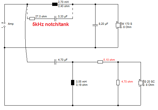

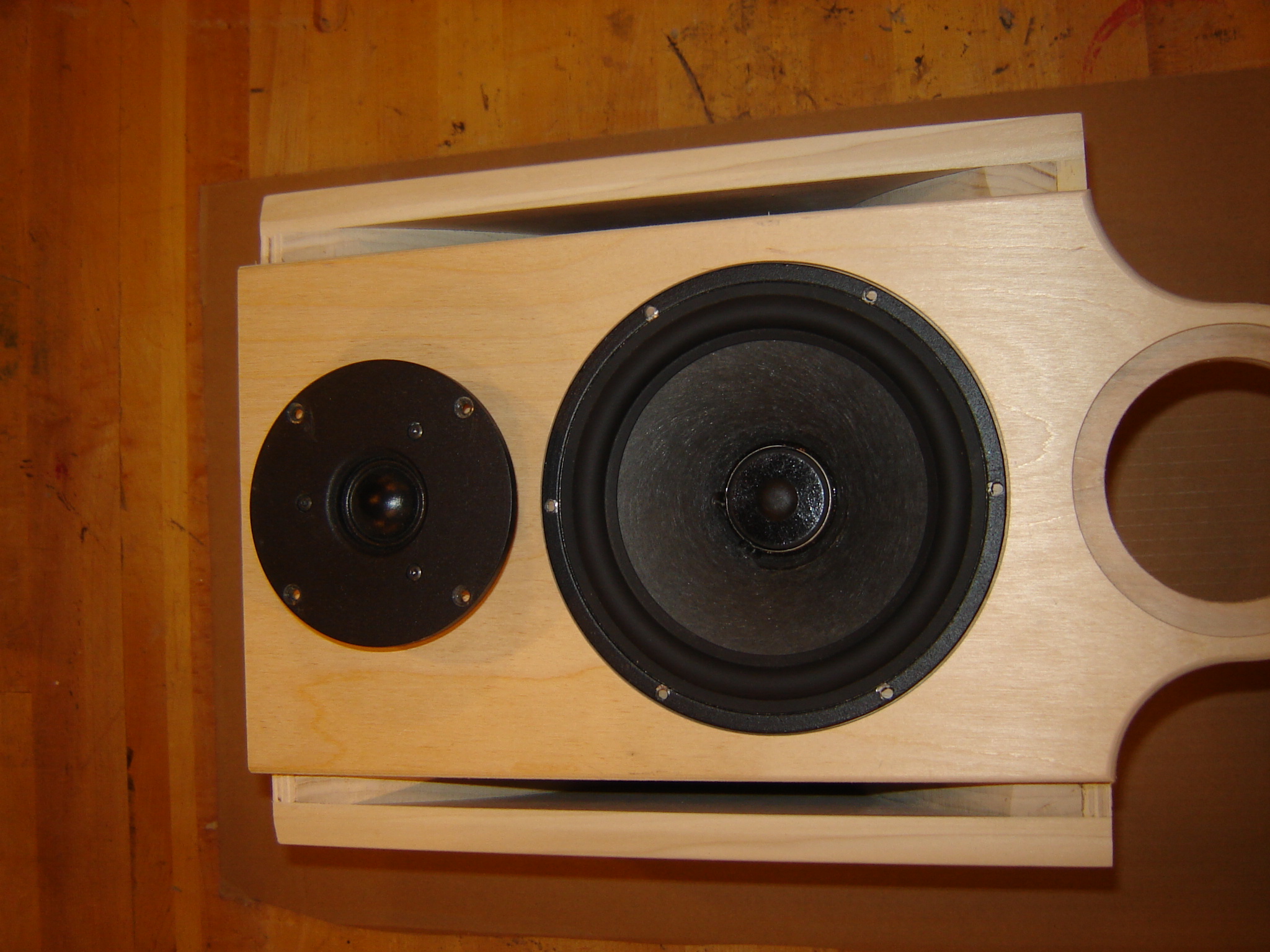

Getting much closer. Getting much better.
- Tilting the baffle for the other 10mm or so offset made no determinable difference.
- Testing showed what I was afraid of, much larger coil on the woofer was needed. 5.1mH seems to be about right. Efficiency down again.
- A smaller parallel resister on the tweeter and bypass the series resister with 2 uF for a little "air". I don't really like this as it drops the impedance at higher frequencies. I may have to add a input series resister and re-do the L-pad. Listening may say if I need the cap or not.
- Did some quick listening. A monumental difference.
I can build the real boxes, as large as I can tolerate them. Order yet more coils and be into final voicing by ear with a pair.
