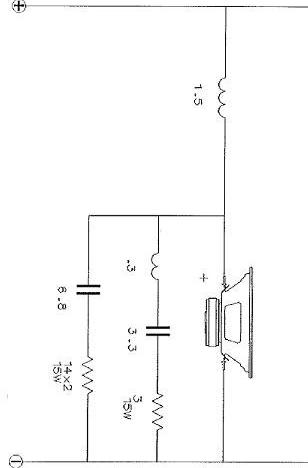

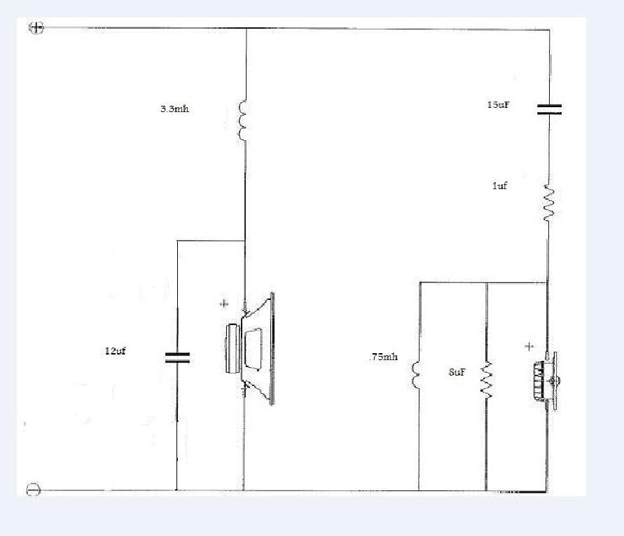

The crossover I ended up with is a second order electrical. Not quite symmetrical. Woofer is a 3.3mH and 12uF. Q is about 1. Tweeter 15uF, .75mH with a 1 & 8 Ohm L Pad.
What I see here is too much bafflestep and heavy bass, too low a crossover (what, 1.5kHz?), and no attention to phase alignment above 5kHz.
I'll skip the elliptical/Cauer stuff here along with all the other gibberish I have read in this thread, and just do a simple tank on the bass and crossover at 3kHz, since we are keeping it simple. I think that will work much better. Red components are driver dependant, but 0.82 will be about right for the silver flute 4.5 kHz peak.
System7.
Dead on analysis in all accounts. I agree totally with what is not optimum. When I say how bad they sounded to me, I am used to at least mid-line Seas or Dayton RS drivers with the best crossover I could design at the time. Total cost is usually several times this project. This project is to build something CHEAP. With that in mind, they are pretty good. I know they can be better. I for sure have built worse in the past and have heard many a speaker in the store far worse. Here is no way these drivers will be a $1800 Vanderstein killer. Can they beat anything built in a store under $400 a pair? They probably do now in the first box. Not good enough.
Note, it LOOKS like too much baffle step, ( 2.7 originally) but in reality the 3.3mH was needed to smooth the midrange in Dougs box. The actual measured response is within a couple dB right through until the tweeter gets ragged above 5K or so. They are not bass heavy. Reducing it always have me a lifeless hole in the mids. Think the opposite extremist of an old JBL. As I had 2.7's on hand, you better believe I kept trying to use them and not spend $60 out of pocket on the 3.3's!
Starting with the SF, I picked a tweeter that could cross as low as possible. I usually target about 2600. This one is starting at 1500. Turns out it is just plain too low. I have to do something else.
I selected a second order crossover as it is CHEAP. Not optimum. We all know that. I am trying to not have to add additional notch filters and contours as they are expensive. I may fail at this.

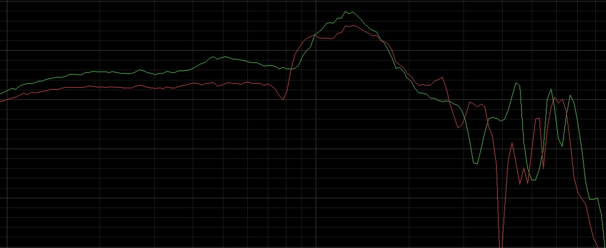

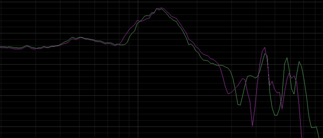

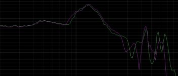

Nearfield testing of SF:
Note that these are two different samples, and there will be variation one to another.
Dopping the cone reduced the efficiency by about a dB. Expected (more mass) but not good.
It pretty much killed off the 5700 and 6600 resonances. Good but probably not important.
It did nothing to the 4400 primary breakup. Disappointing but not surprised.
By adding foam blocks, I believe the primary culprit is the dustcap where the plateau across 2 to 3K is the cone edge.
I could remove the dustcap and add a plug.
I could slit and re-dope the dustcap to raise its breakup frequency.
I could increase the stiffness of the cone in hopes to raise the breakup frequency.
This requires another cup of coffee. Any other ideas?

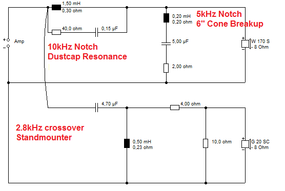

TVR, my personal opinion is that to add a notch or convert to Cauer filter is not difficult.
Just a single inductor in the shunt path of your lowpass. Like i did with the crossover in my visaton build. It worked well in my case (2.2mH series, 5uF and ~50uH in the shunt path) and despite what System7 reckons, it actually improved phase. I wound the inductor on an M10 or 3/8 unf bolt, something like 40 turns of 22 gauge. DCR isn't a huge issue here, i got ~0.5 Ohm, which tames the notch a touch, but also the rise after the stopband.
The highpass is perhaps another story.

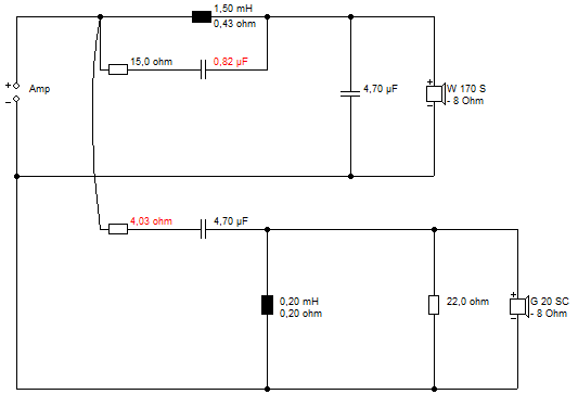

mondo, my friend, I can do Cauer filters along with Mr. Zaph and the rest of them. But I don't think the man on the Clapham omnibus would know what I am talking about. And nor do most of the people here.
My feeling is that a simple 15R/0.82uF tank/notch placed on the bass coil at 4.5kHz here will do 90% of the same phase and frequency response goodness for less bucks. Never underestimate the tank!
Quite right mondo; not difficult at all to add a notch. SOP for where performance is more important than budget. Done it many times myself ( I have used several Dayton RS 150's and 110's)
I still contend, an elliptical filter is of no real advantage as the steeper rolloff is only right at cutoff. An octave out, no difference. It requires a third order so is said but my understanding is a fourth. Not a budget design.
Don't know how the market is on your side of the pond, but over here, it is cheaper to buy ready made coils for PE than to buy bulk enameled wire. I don'd get it, but that is the way it is so I don;t wind my own coils. I unwind a few to get exact values of course.
So, I cut out the dust cap. It is very heavy. Eliminated the 4500 problem. Of course with a big hole, there are a few others. I have two approaches to a phase plug. The first is a piece of drain pipe is exactly the correct size, 1 1/2 inch. I will fill it with something and cut tapered slots to make a slotted plug. The second approach is gluing up a stack of MDF and turning it down. I don't have a lathe though. So, I roughed it out on the router and am going to see if I can make some sort of crude lathe and sand it to a nice bullet while it spins. Total guess on shape. All this is far cheaper in dollars than filters.
