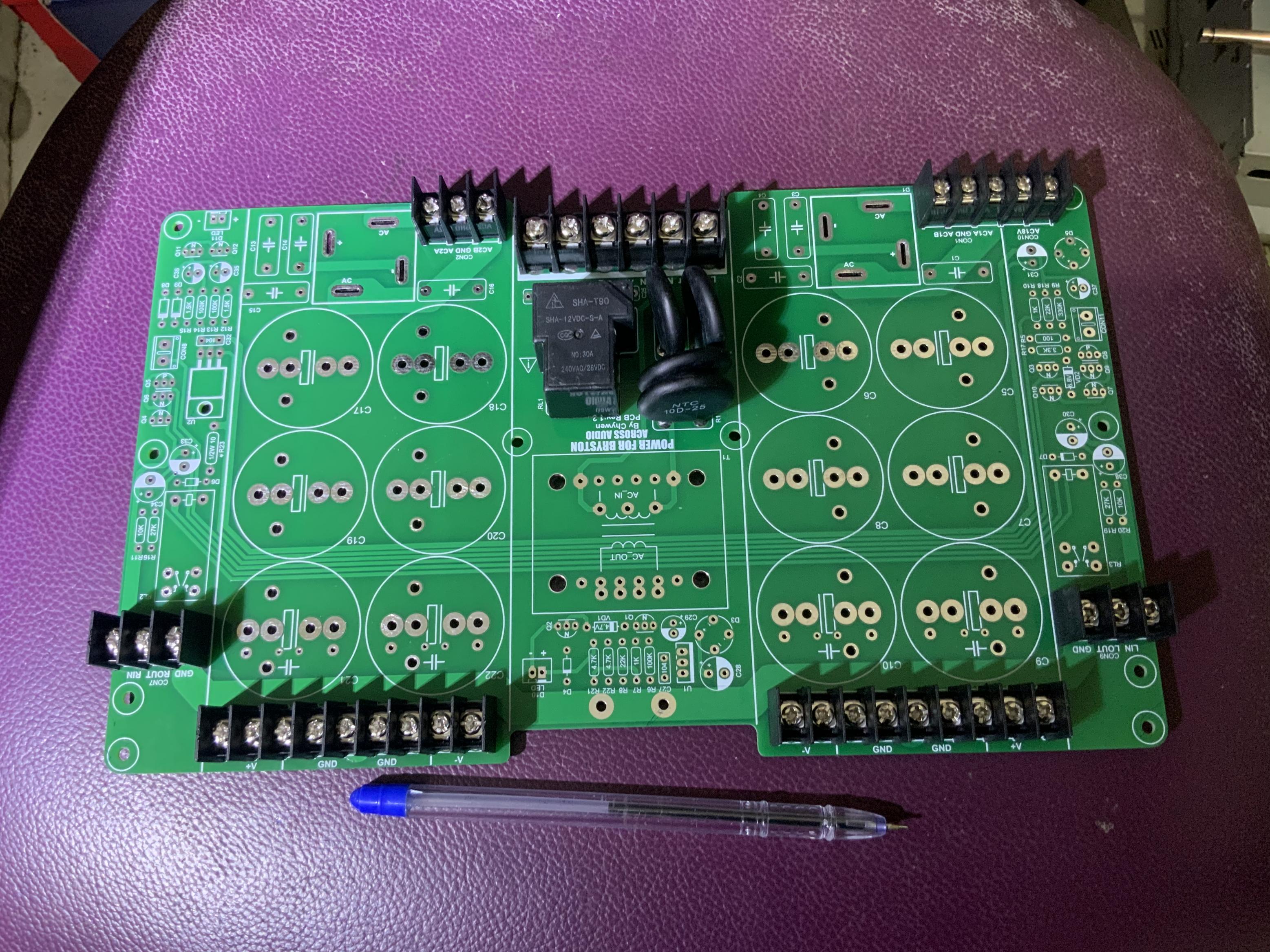

I'm in the process of collecting parts for this project. At the moment I am considering the selection of capacitors for the power part. Can I use 10000uFf 80v capacitors instead of 100v? The problem is that I can use a capacitor with a maximum width of 35mm.

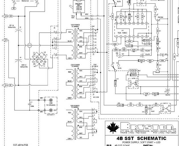

Does anyone know which original capacitors are used in 4B? (brand and capacity) I am also asking about other capacitors with smaller capacities (if someone has this knowledge)
Thanks in advance for the hints

Depends solely on your power supply.
It can easily run on 60 volt, .
It is more logical to collect 3b SST at low power.
