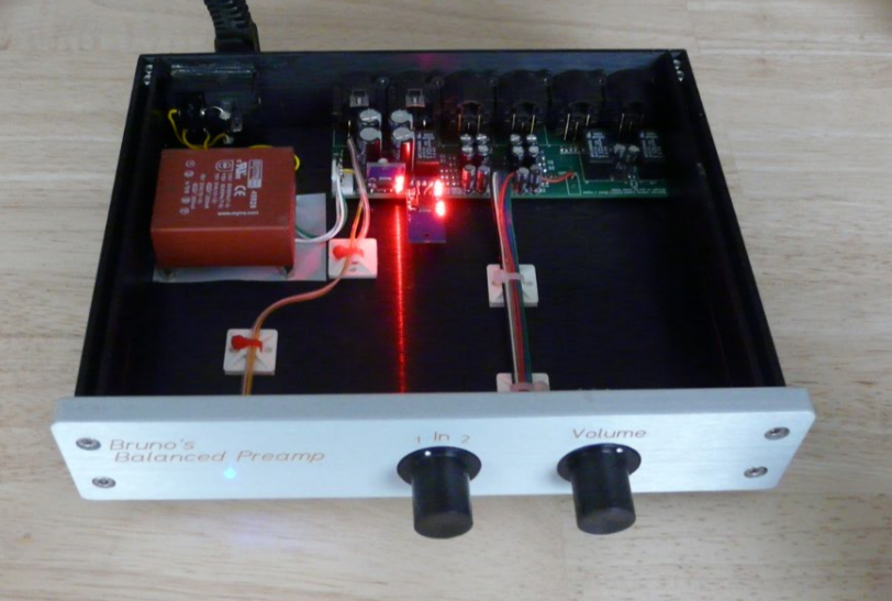

I have a completely assembled unit that I no longer need. € 200 + shipping will get it.
I'll see if I can post a few more pics later.
Regulators are high-performance from XEN courtesy EUVL.

Still loving my BP Pre.
However I was wondering if anyone has tried altering the power supply.
I get some hash from my Pre at around the 9 o clock position (BOM Pot.)
I notice Jan has used different voltage regulators, different ? worthwhile ?
I also wondered whether using a linear DC supply into the 3 pin power connector would provide improvement, if so what voltage should I provide 13/14 V ?

Do you think the pre hash comes from the BPBP supply? Do you also get it with the input shorted?
I used the regs I had available at the time. With this kind of circuit it doesn't really make a lot of difference what you use, provided the grounding and distribution scheme is right, which is inherent to the PCB.

Hi Jan, not tried that but I will.
Can you recall what VAC output you have/had from your TX ?
Do you get any hash on the output at high volume ?
It could of course be my amps, so I will try reinstating my N-Cores.
Thanks.
Try with shorted inputs to know where it comes from. If the volume is high then of course you are also amplifying any noise coming into the input.

Placing different power supplies one after another may make sense, because you get double regulation and - most of the time - variable and adjustable input voltage to your liking.
I do use switched power supplies feeding the two linear Hypex power supplies, which are supposed to be excellent. There are two filter stages in front of the linear regulators already cleaning up the signal to a certain degree.
I don't think your noise "problem" comes from the supply side, but from the input noise either of the first stage and/or input signal and its corresponding amplification stage.
