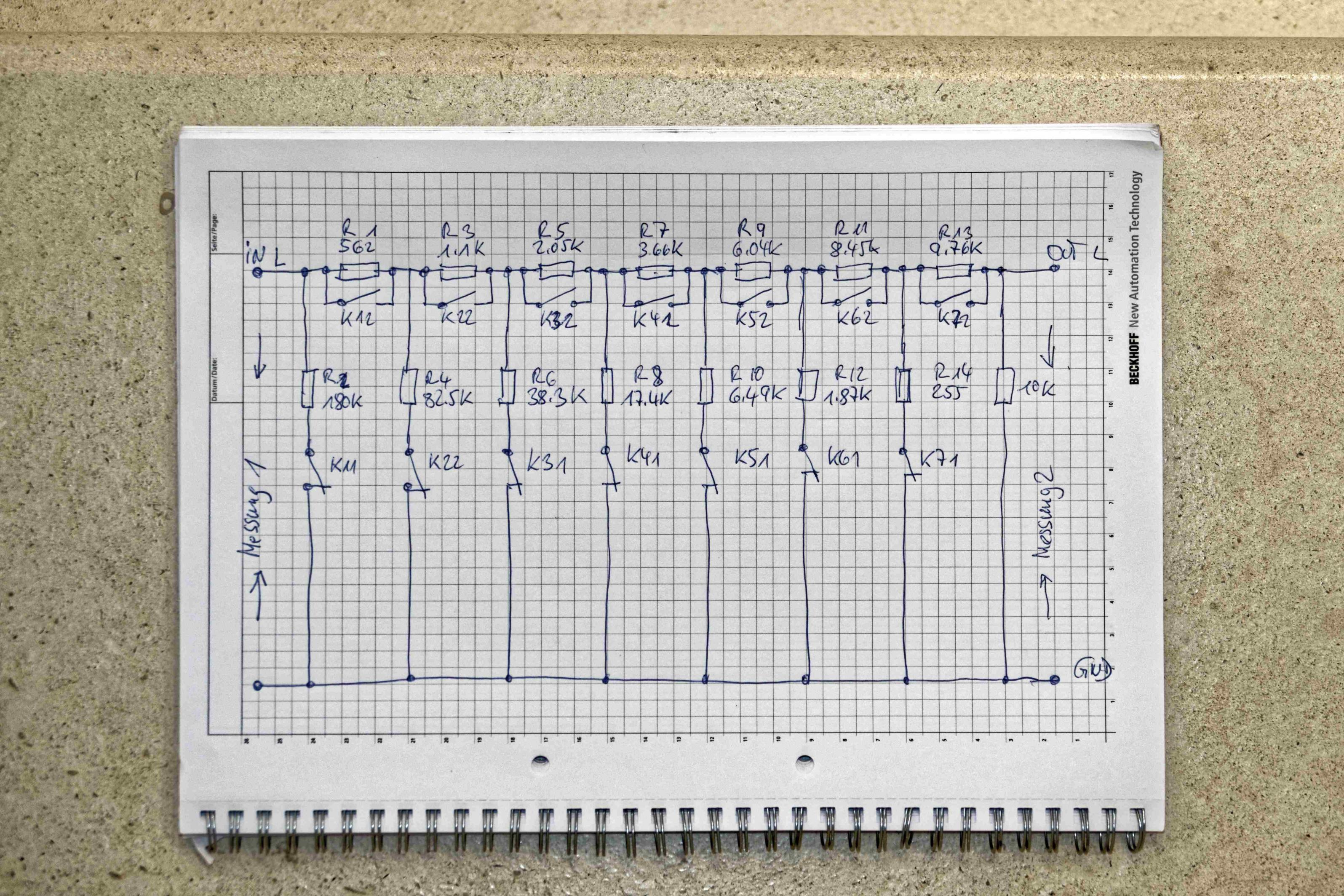

Just did some further measurements on that Chinese passive attenuator board today as promised and have drawn a (preliminary) schematic of that board (see pcitures, no mistakes hopefully but don't trust it yet ).
Additionally I added to that *.TXT file of mine the results of those measurements. Not sure yet how to interleave it to the BPBP instead of that linear 10k pot because of some - at least to me - visible inconsistencies. An additional resistor has to be added in line to the ladder probably to prevent the gain rising to "infinity".

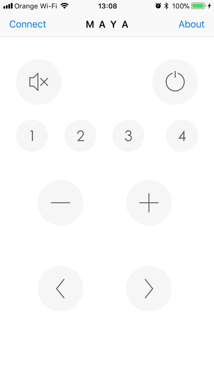

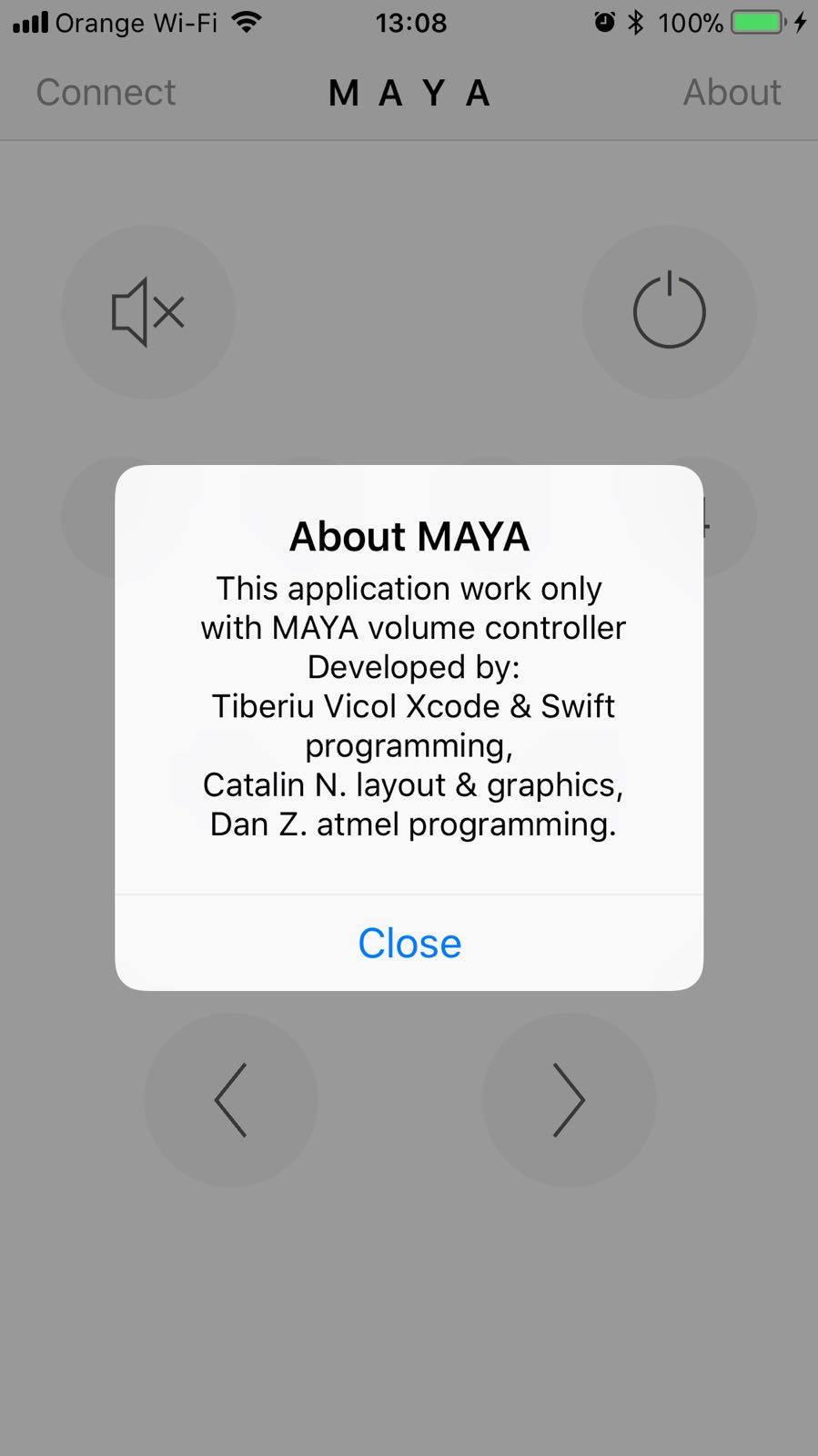

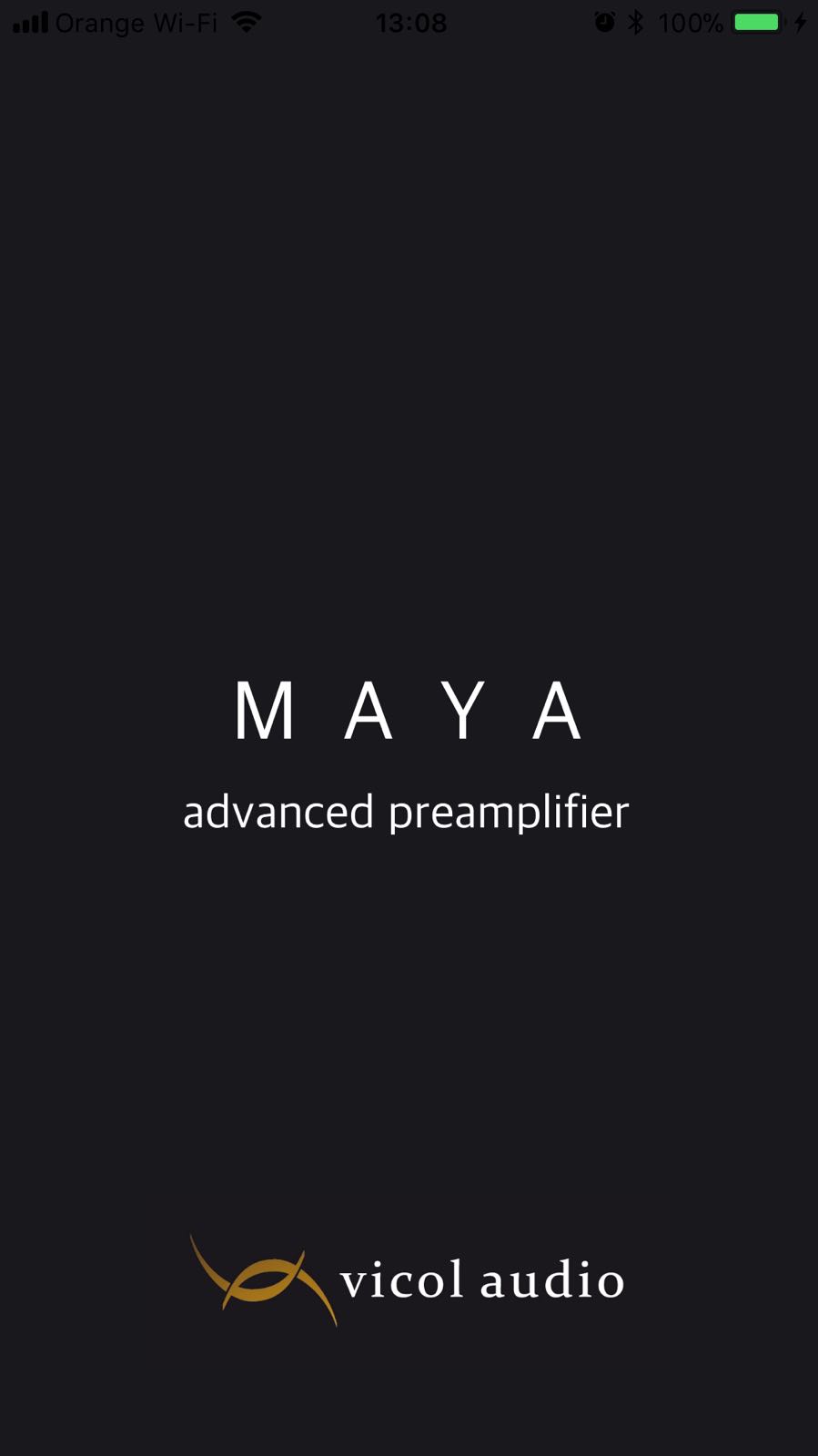

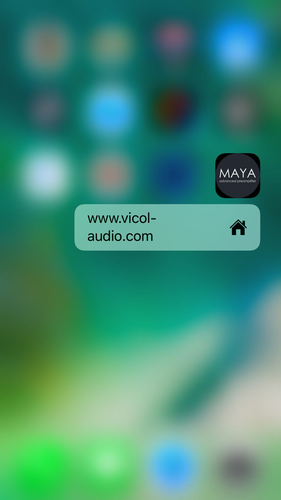

MAYA with BLE for BPBP will add IOS support.
After a long journey we have added IOS support to MAYA, so you may control your BPBP pleamplifier from your comfortable iphone.
Tibi
Tibi
