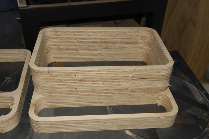

ScottG , Do you mean somthing like this ?
I never seen anyone build a cabinet like that before ... But it appears to be solid with 30mm wall thickness and all the gluing that needs to be done .. but , well it's weird
Anyone approves ? The problem is I dont see a way to chamfer the inside circles , Only by sanding it by hand a bit .. also incorporating braces that interlock with the design is a pain.
Also building it like that would require 192 "flanks" for 2 cabinets ... can you say labor cost hehe
Yes, that's it - but it should be 35mm (good ply).
Lay-up the baffle first on your bench (without glue) using bracing, and do your routing.
And yes, it would be a lot of labor. It would also be expensive if you use a router for the cuts, (use a table saw), OR you have someone else do it. (..if it were done on a production run basis a high power laser cutter would probably be in order.)
Again, forget the bracing - done this way it doesn't need it (..but it should be 35mm).

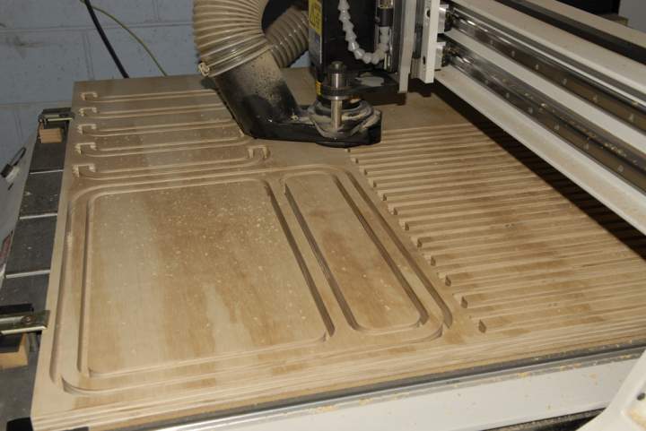

I'm making my tube amp case's in similar fashion .Cuts down the ply wastage .A mate in Sydney done the CNC work ,he will do on off jobs for people .
