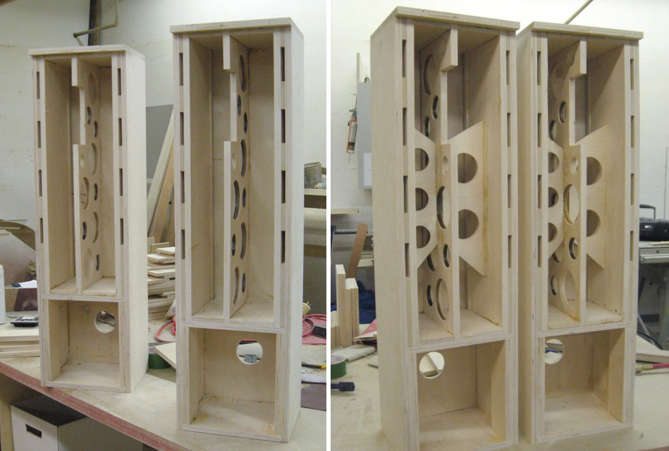

So according to this , Would you think this design is better and more rigid ?
Also , I'm thinking about using birch plywood 18mm instead of thick ( 27-35mm ) MDF , What do you think ?
Yes.
Yes. A general equivanence commonly used for stiffness between typical quality multi-ply and average MDF is 18mm ply = 1.25" MDF (both these materials have a fairly wide deviance from the average)
dave

Planet10 , The funken enclosure you pictured above seems to have front ( baffle ) to back bracing on the left portion of the picture , My design calls for side to side brace as i understood is better from the AES picture you linked in page 3 .
Are you sure that is OK ?
Should I brace front to back more instead of a single round brace
Or is it all not such a big issue as long as I brace heavily ,
Use 18mm MDF + 18mm birch + 18mm MDF on a single wall ? isn't that a bit overkill

ScottG it appears that what you described cannot be done with normal means and basically all conventional DIY ways are "wrong" .
I really cant use the birch the way the magico mini's are built "trans-lam" as you call it because it wastes alot of material .
I cannot decrease panel size.
Panel thickness will be 25 mm birch and I think going any thicker is a waste.
So how would you brace it ?

They aren't necessarily wrong, just not terribly effective and often even less effective. There are however OTHER issues that might make them more "wrong".
Actually the Mini's "bracing" is almost redundant (particularly if you increase panel thickness). This means that a birch plywood "trans-lam" is still an excellent way to increase rigidity.. and just skip the notion of bracing at all. IF you do that then you aren't really wasting material (beyond the cutting process), AND you can determine the wall thickness to your desire. Plus, (because it's a lamination), vibrations along the length/width of the lamination panel are more "discontinuous" and damped as a result (..the glue you will be using in particular will present a "loss").
The only real down-side is increased planning and a hell of a lot of cutting (..but most pieces should be fairly uniform so even the cutting shouldn't be to bad).
35 mm thickness for a good plywood "trans-lam" and an enclosure similar in size to the one you are proposing should do the trick - rendering it largely "inert". Even the dimensions shouldn't change that much considering that you can *reduce* volume because of the absence of cross-bracing displacing interior volume.
You can also "stagger" the pieces in the "lam" at the corners, rather like a box-cut joinery joint.
