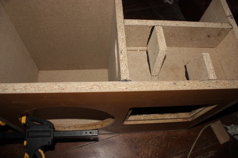

Back to the subject of bracing and damping, what do you guys think of this stuff?
The last few days I've been brushing 5 coats of this liquid latex rubber onto the inside of the current batch of 4 cabinets, on interior walls and even braces etc. It goes on very bright pink and dries to very deep red.
RedGard 1 Gal. Waterproofing and Crack Prevention Membrane-LQWAF1 at The Home Depot
I don't know whether it will actually make much difference beyond the addition of weight lowering resonances. I don't really know whether the rubber will damp or just rebound. In the past it helped damp metal braces, and it helped damp tempered masonite matrix braces, but on these speakers the center brace is 1" thick MDF and the others are 3/4 plywood. I just put it on because the cabinet walls are thin and I had the RedGard laying around (though I ended up buying more). I used about 2 gallons on 4 cabinets.
It would be interesting to use something like this between plys or to throw in even wood scraps as braces, to constrain the rubber layer between stiffer materials. But it remains to be seen whether it makes any difference. Unfortunately, I don't have any "control" cabinet without the rubber, no time for a meaningful experiment so I won't really have any good data to share. But it is an interesting material and the price is not too outrageous as it's intended to be brushed onto concrete floors.

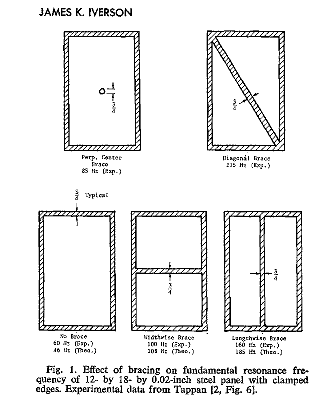

Okay to further push this idea: Has anyone used (Phi) ration 1.61803399 to place the Nodes in a non-resonate divisions through bracing Diagonally? In my next project I will try this method! I hope to divide the remaining LARGER panel space again into this same ration in hopes of placing any stubborn resonances at an acceptable harmonic! I would not leave out Damp-ing the braces and consequent panels with some sort of non-toxic binder like (Flex Seal + sand). Added acoustic fiber materials to take care of the mid-range/upper bass resonances also!
Note that the higher the panel resonances the better. The diagonal brace is not as effective as the vertical brace, but i believe that a "slanted" brace that creates 2 unequal trapezoidal sub-panels would.
I have used golden ratio spacing on braces. Can't say whether it was better, certainly one does not want to place a brace such that it creates 2 equal subpanels.
