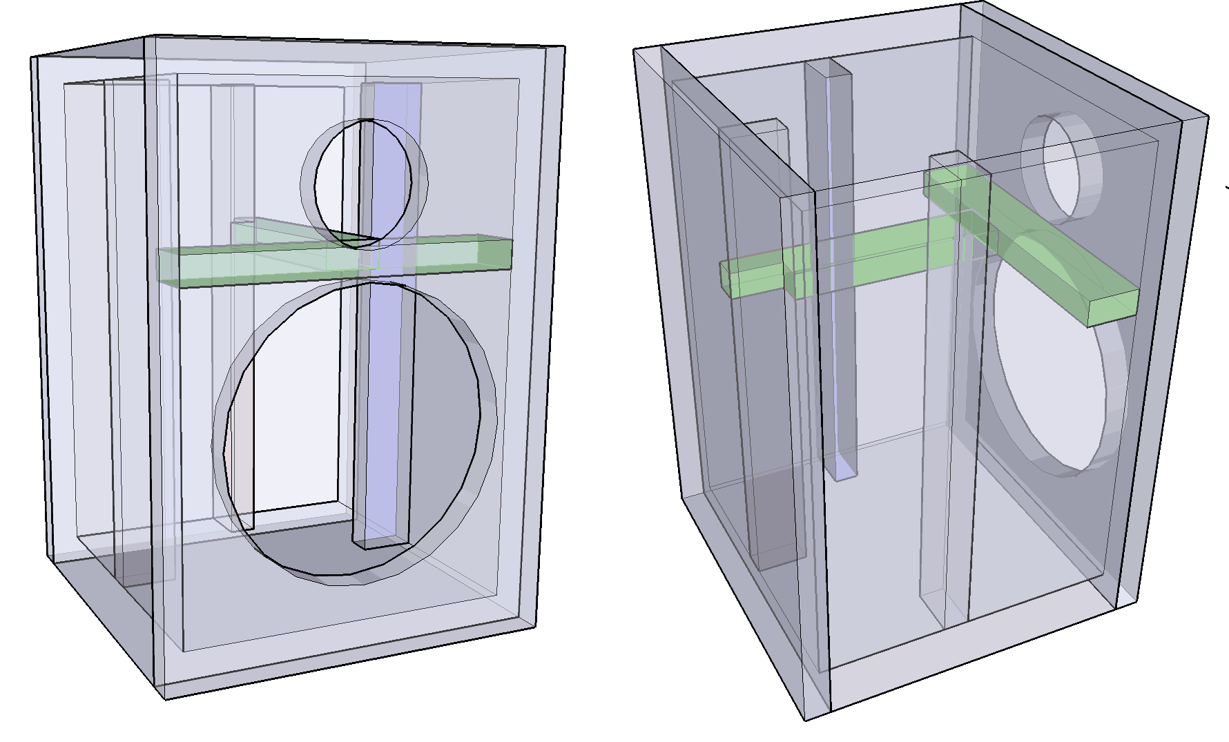

Not going of topic...you asked for how I would brace cabinet. That's what I have submitted.

The baffle and drivers are missing their braces.
Would be better if the braces reached to the other side.
Drawing does not fully show brace placement.

For this design, nothing is missing. No modification or additional bracing is necessary or recommended. The drawing shows the entire project. Sorry you can't see it. Crossover 2112Hz.

Ah, sorue, yes, the link! Things getting heated here. Let's chill a bit, eh? Now you guys are NOT helping me with my problem of bracing my cheapie chipboard box!

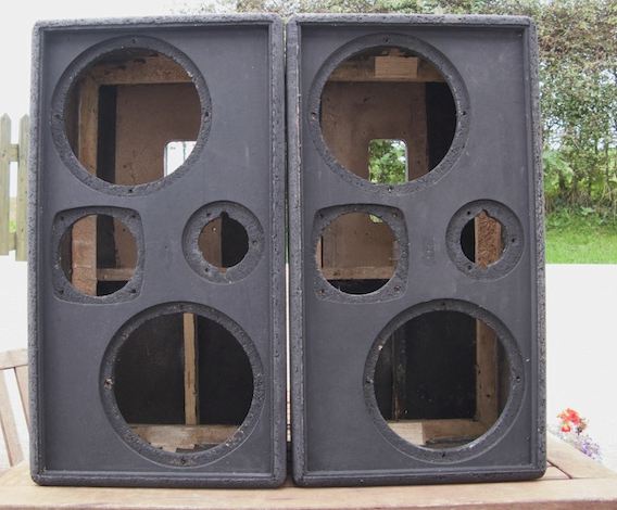

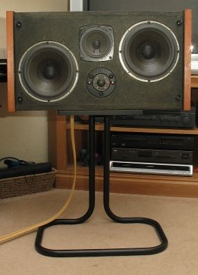

I've found some inspiration in Mr Tibbs' lovely Gale GS401A restoration.
I need to brace across the weak point caused by the driver cutouts, hugely brace the back panel for mass and strength, and brace from front to back with a single hard strut to couple the mass of the bass to the back panel! OK, some issue with how it's gonna be mounted best, because the Gale's rested on their sides, but essentially sorted, eh! What do you think?

It would take less work to build an entire new box than build my bracing system. I would suggest getting some 3/4"x1 1/2"(or so) hardwood strips. On back, and sides run them vertically just off centre. Not much place to get traction on the baffle, so run a horizonal strip across the space between the tweet & woof. Then turn that into a T such that you can secure it to the brace on the back. If you can the same from the back of the bass driver to the back of the box.
Much like tha Gales, but rectangular braces edge on make more sense than square ones.

Based on the photo of your design, there is no need for additional bracing as there is no "weak point". Standard 19mm (or thereabouts) bracing along the length of all interior corners will be more than sufficient. You could include a brace horizontally across the interior face of your design between the two drivers, to intersect with the side braces, but it would absolutely not be necessary. I would say, be sure to compensate for the interior volume but as this appears to be a sealed enclosure, that would be less critical.

By "corner bracing" I mean interior bracing running the length of all interior dimensions, vertically and horizontally. Based on the estimated dimensions of the enclosure by viewing the photo, and even though this is chipboard, this type of bracing, while not only easy to implement, will also serve to render the enclosure dead. Just trying to help here.

The Cabinet is 18" H x 12" D x 10" W. Its gonna be impossible to get braces along the height into the cabinet, because I have not enough access. I'm wondering if I should just put two braces across the front either side of the woof, two similar across the back and two from the centre of those braces on the baffle to the back to link them. Like an H shape, if you follow...

Ah ha! Now that changes things quite dramatically doesn't it! No access from the back? If that is the case, then your proposal is probably the best solution apart from planets10's suggestion to build a new box. You may however be able to fit the bracing in (2) pieces, from the front, through the woofer opening, for the back, vertically and horizontally. Then use your idea for the front bracing. Glued and screwed if you have access to the proper tools to get in there. It's not that large of a cabinet, so you should be fine.

If you brace the entire long dimension, then horizontal braces will not have much if any additional benefit.
One of the "rules" of bracing: a brace should create sub panels that have a higher aspect ratio than the panel being braced.
(sketch not to scale)
With access only thru the the bass driver hole, you'll hav eto get creative. This is the scheme i described and could still be executed, but the long braces would need to be 2 pieces or shortened. I'd just overlap them and glue them togther. The braces are placed such that one edge is on the middle, so long braces would be height/2 + overlap (1 couple inches). 1/2 of the brace has one edge on the centre, the other hs the other edge on the centre. In the middle they overlap.
Some persuasion and rounding on ends, required to get the shorter braces in.

Darn, can't get that image open, Dave.With access only thru the the bass driver hole, you'll hav eto get creative. This is the scheme i described and could still be executed, but the long braces would need to be 2 pieces or shortened. I'd just overlap them and glue them togther. The braces are placed such that one edge is on the middle, so long braces would be height/2 + overlap (1 couple inches). 1/2 of the brace has one edge on the centre, the other hs the other edge on the centre. In the middle they overlap.
Strange forum issue? I could see the pocture in my post, but it wasn't showing up as an attachment and if i tried to open the pic in a separate window it couldn't be found. I reattached it, you should be able to see it now.
