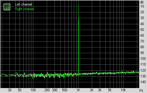

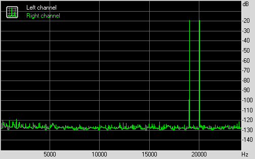

I didn't follow this thread for quite some time, but I can see that there is still a lot of confusion around pots.
Without going into any detail or commenting on different topologies, I have included THD and IMD images below, showing the immaculate performance of the "Hans" volume control board.
