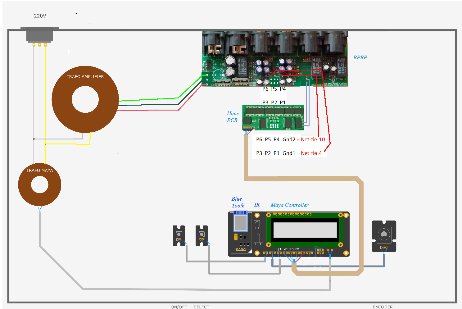

for the avoidance of doubt: "left" when looked at from the rear of the Controller i.e. the ones marked SST, SPK and STD - yes?
Red wire is on the right on both PCB's. The three blue Maya wires on the left are not used.

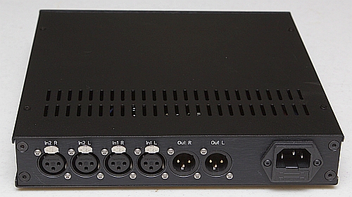

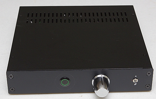

BPPBP case
I went with the DIY store case, 1U Galaxy w/steel covers. Like you I don't like drilling close holes. Someone on the forum had a DXF drill pattern. I took it into FPD and added my IEC cutout.
The CNC and lettering basically doubled the cost, but made life so much easier.
  • putzeys back - rename to fpd.txt

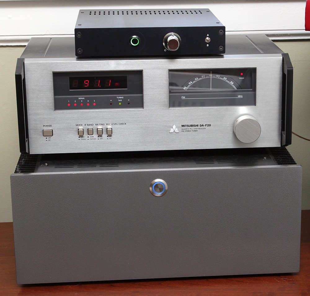

Here is my take on the BPPBP. I have taken the minimalist view, just all I need. Case from the DIY Audio shop.
I have been listening through it for the past few days, audio files are .flacs and the amp is a Pass diy F4. Dead quiet, very neutral to my ears, sparkling highs. My other preamps are a Pass diy BA3 and Doug Self opamp pre.
I am happy to add this BPPBP to my collection. Thank you Bruno and the other folks that brought it to fruition.
David
How does it compare to the BA3 would you say?
To my ears the BA3/F4 combination is more tube like, probably due to the ability to tune the second and third harmonics to taste. Seems more warm than the BPPBP. This to my ears is not bad, the BPPBP /F4 combo is very clean.
I have just paired the BPPBP with my Pass F6 with a Mitsubishi DA-F20 tuner. To my ears this is a winner for me listening on FM. Haven't tried it with another signal source yet.
This is a bit from the fmtunerinfo site regarding one reviewers thoughts on the DA-F20,The Mitsubishi's midrange was very focused and believable. In comparison, the sound was a step more forward. It definitely kept me interested in the music. The DA-F20's highs were more extended while still sounding like a real part of the music. Stereo imaging was precise. The midrange seemed just right with a nice open quality. Everything seemed just about right, to such a point that I gave up looking for flaws between the two. It was seductive in a toe-tapping, not sleepy, sort of way.
So to my ears this is a win win.
