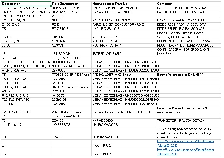

Dear All,
I intend to assemble the board I received with Linear Audio. I want to see if my reading of the article, plus the thread was fruitful:
The BOM I intend to use is attached: is it correct ? I think it incorporates the Oops from linear audio.
I will use a 12+12 V transformer and the Hypex regulators.
I will make a run of Hans boards (Not the ones for the controller) if nobody has a spare for me.
As I understood Hans board is controlled pulling low or high four pins from 0000 to 1111. I was thinking to do this with an arduino and rotary encoder/remote. Is there a smarter/simpler way ? I understand that the value of high depends by the relay used, so I should be able to control directly 5V relay with a 5V arduino.
Anything else I am missing ?

I reworked my BOM starting with the original article. In the file previously posted there were some expensive resistors where apparently were not needed.
Are the gerber for Hans Polak board (published on LA website) available ?
Did I get the controlling strategy correctly ?
Thanks,
Davide
Thanks,
Davide

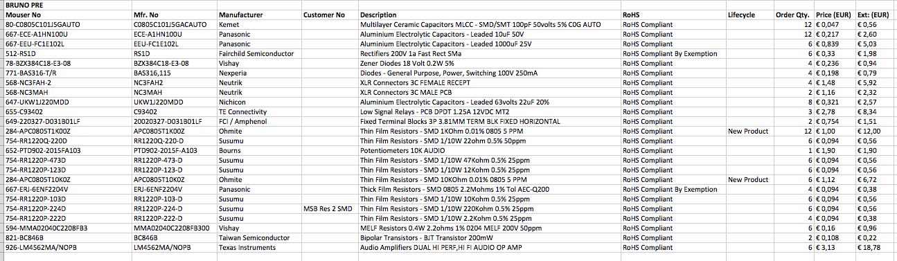

hypex-preamp-Bom.pdf - I can't remember where I downloaded this document from, but I'm sure it was from this thread or one of the group buy threads. It lists the capacitors like this:
C10, C16, C26, C27, C28, C29 C12, C13, C14, C15 - Electrolytic Capacitors ‐ Leaded 22uF 100V 20% Audio SILMIC II Aluminium Electrolytic
and
C12, C13, C14, C15 - Capacitors ‐ Leaded 1000uF 25V 20% Audio SILMIC II
I ordered these from Mouser, and they are all very large, and don't really fit the board. I've made them fit by "flying" them above the adjacent relays, and hanging them from the edge of the PCB, and leaning the regulators over at a crazy angle. It's all connected, but its far from pretty.
So, when ordering the capacitors, check the physical sizes carefully.
and

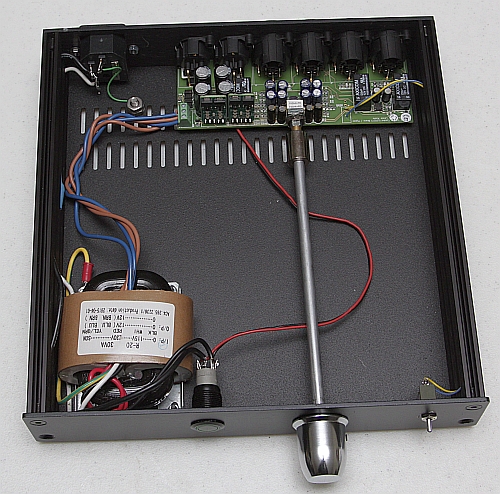

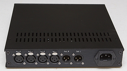

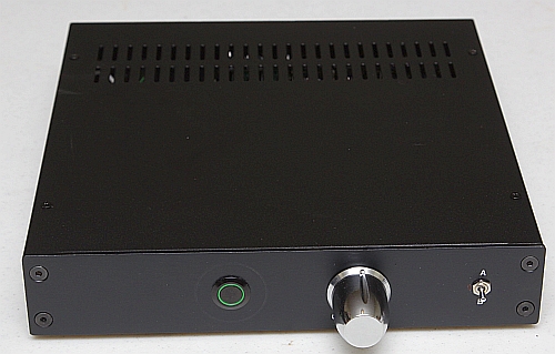

Here is my take on the BPPBP. I have taken the minimalist view, just all I need. Case from the DIY Audio shop.
I have been listening through it for the past few days, audio files are .flacs and the amp is a Pass diy F4. Dead quiet, very neutral to my ears, sparkling highs. My other preamps are a Pass diy BA3 and Doug Self opamp pre.
I am happy to add this BPPBP to my collection. Thank you Bruno and the other folks that brought it to fruition.
David
David
