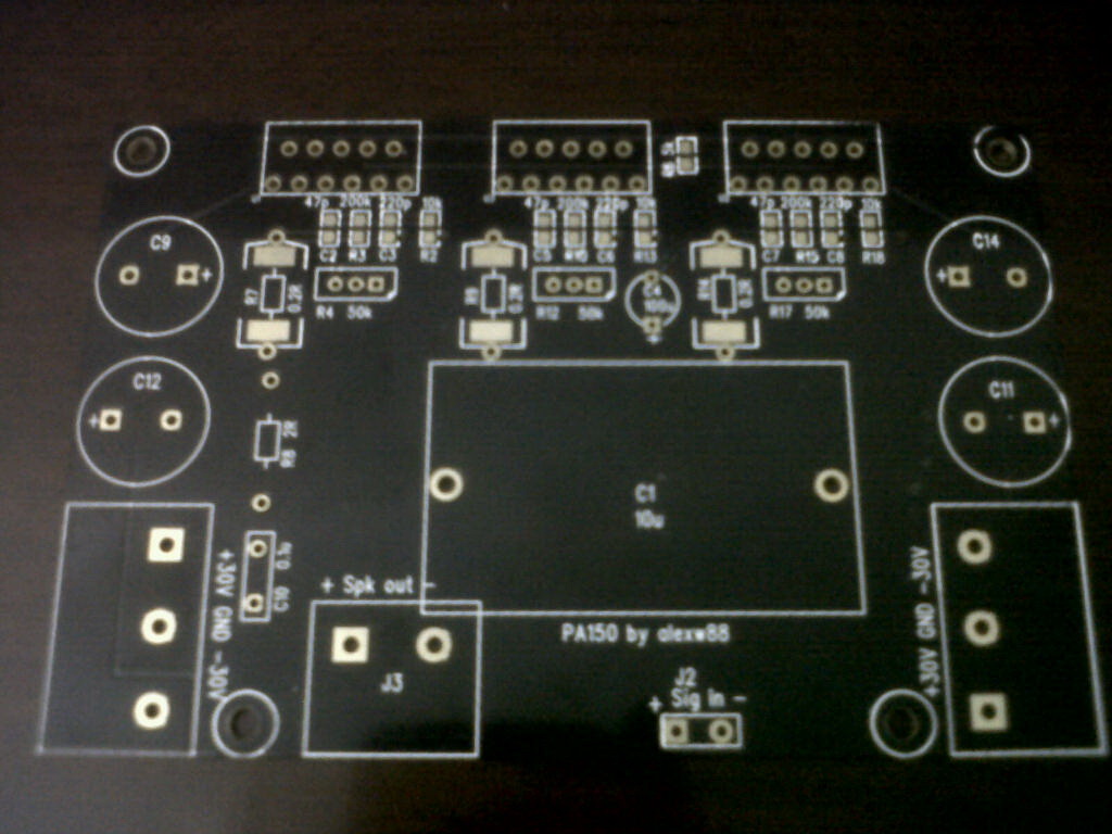

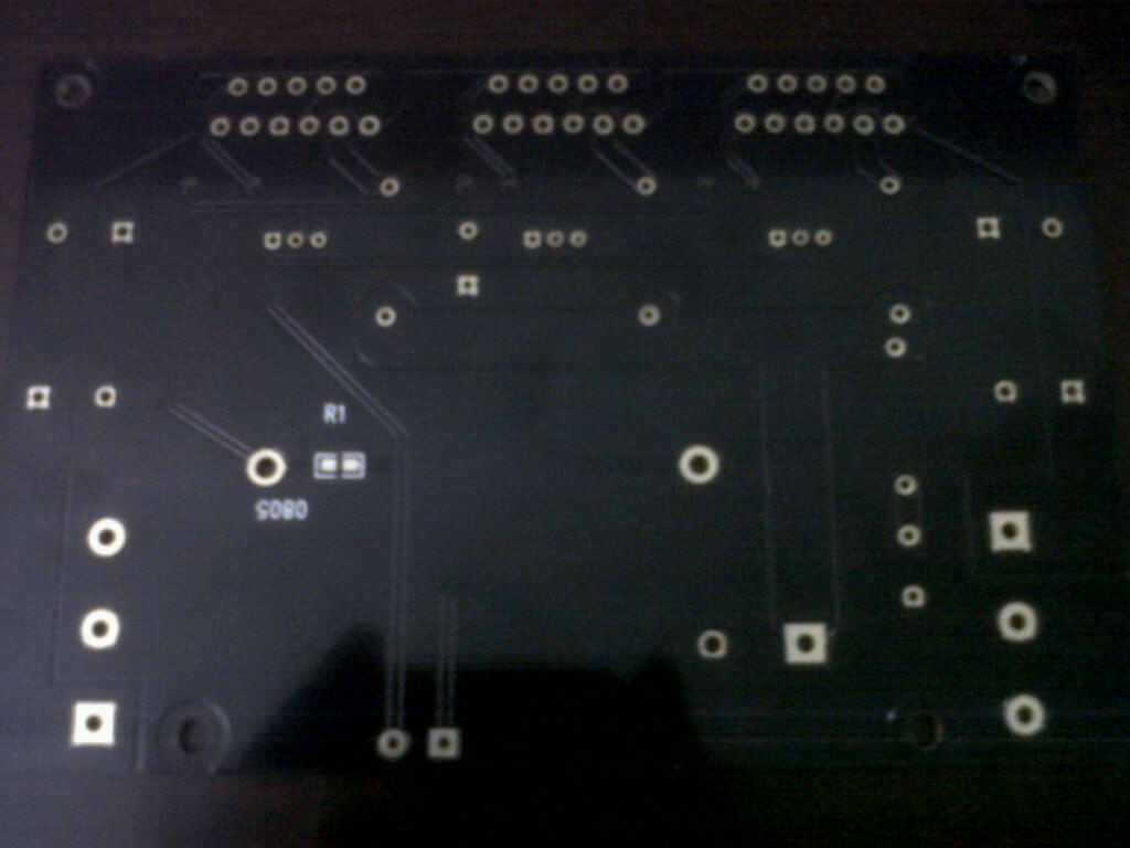

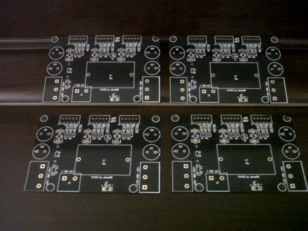

From alexw88 First group buy, this boards maybe first prototype
honestly i want keep this board but if i think once again this is not ok
cause alex the creator give him afford to us to get this beautiful amp
I hear another lm 3886 board, from local store, hand made, local gb
even from china. Looks like this material of copper rail was very good
if no one interested i will sell it in swap meat or ebay letter
I am trying but not really being able to understand you. Are these boards from the first alexw88 group buy?
Hi
yes they are came from 1st gb bpa300 by alexw88
from boards we received 4 is black colour the others is blue
