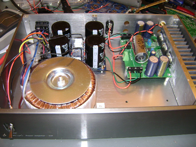

Because in Alex's design, the AC ground/safety earth is connected directly to the chassis and the choke+resistor are between the amp ground and the safety earth.
Putting a resistor between the safety earth and the chassis can act like a fuse, blowing the resistor and leaving the chassis live and potentially deadly if a fault occurs.
Guess I didnt read Pocoyo post carefully. Thought he was talking about putting a resistor between pcb ground and chassis, like Alex have done.
Even I, with a significant limited knowledge, wouldn't put something between safety earth and chassis.
