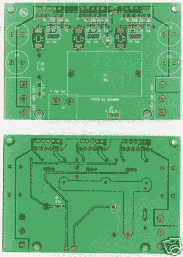

Buildong
Hi all, I'm new in here, but I'm building these amps at the moment.
will make some changes on the pcb (some parts are more easy to find here in a different size)
The conductor will be silver, and with 100um thick (each side)
Would like to ask some questions from Alexw88, but I'm blocked -PLS check your mail on www.shine7.com
P.S.: I could send PCB-s naked and filled as well in about 3-4 weeks if it's needed 2 someone (Hungary/Europe) !!!
First of all, I would like to know what's changes if I use a biger (10 pF) capacitor? It's hard to find this 8,2pF at 200V in SMD.
he other H2F is dhe Dale WSR resistor. What shall I use??? wirewound?
I would like to know, why did you choose the LL 1545 A?
I would like to use the LL 1690.
I`ve tryed 2 understad the differences between them, but I`m not good enough for it.
Could you please check it for me, and give me some suggestions in it???
I don`t know what kind of pre-amp will I use with it, but if Good
helps me I will buy a tube thing from www.transcendentsound.com
I would like to deliver 2X150 Watts (on 8 Ohm) per SIDE
So I build a dual mono push-pull amp per side for biamping.
I`m not shure how shall I connect these audio transformers in this case?
just simply split the signal after the transformer?
or I should get 2 transformer per side? (this would make me a bit unhappy a bit)
10pF should be fine, the value is not very critical.
For the Dale WSR resistor, you can use any 3W resistor instead, wirewound would be fine.
I use LL1545A because it is available from the online stone that I used to buy things. LL1690 would also work, may be even better as it can handle higher level.

Hipchek: I will have a lot of board.
Made with 100 micron silver, but some thigs must be changed (input, output and power connects, becouse I could't find those thing at that size here)
everyting will be the same
will cost about 10$ plus P&P per board, but I'm not shure yet.
And It's will be available all (or olny the SMD parts) insalled. 4 another small charge.
