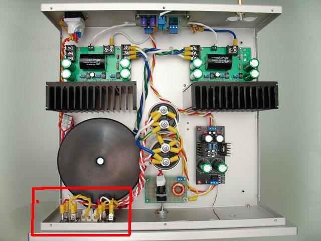

johncmng said:
Sorry for the newbie questions.
But, do you just connect the outputs of the transformer (+/-30V) directly to the 47000uF caps?
Thanks in advance.
John
The Bridged rectifiers are fasten to the front panel
No. Transformer output >>> bridged rectifier>>> capacitors

alexw88 said:
If you use transformer you don't need input cap.
More about gain -
If DRV134 is used, the BPA300 gain will be 40.
If a 1:1 transformer is used, the BPA300 gain will be 20.
If a 2:1 transformer is used, the BPA300 gain will be 10.
