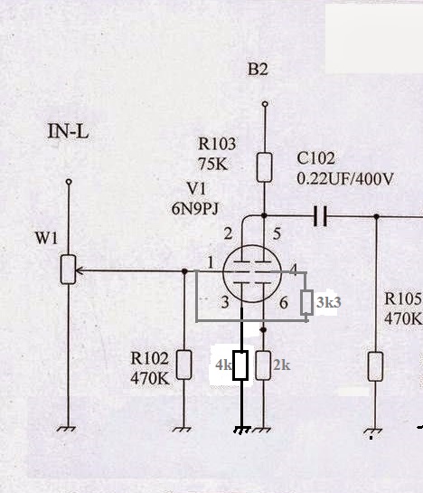

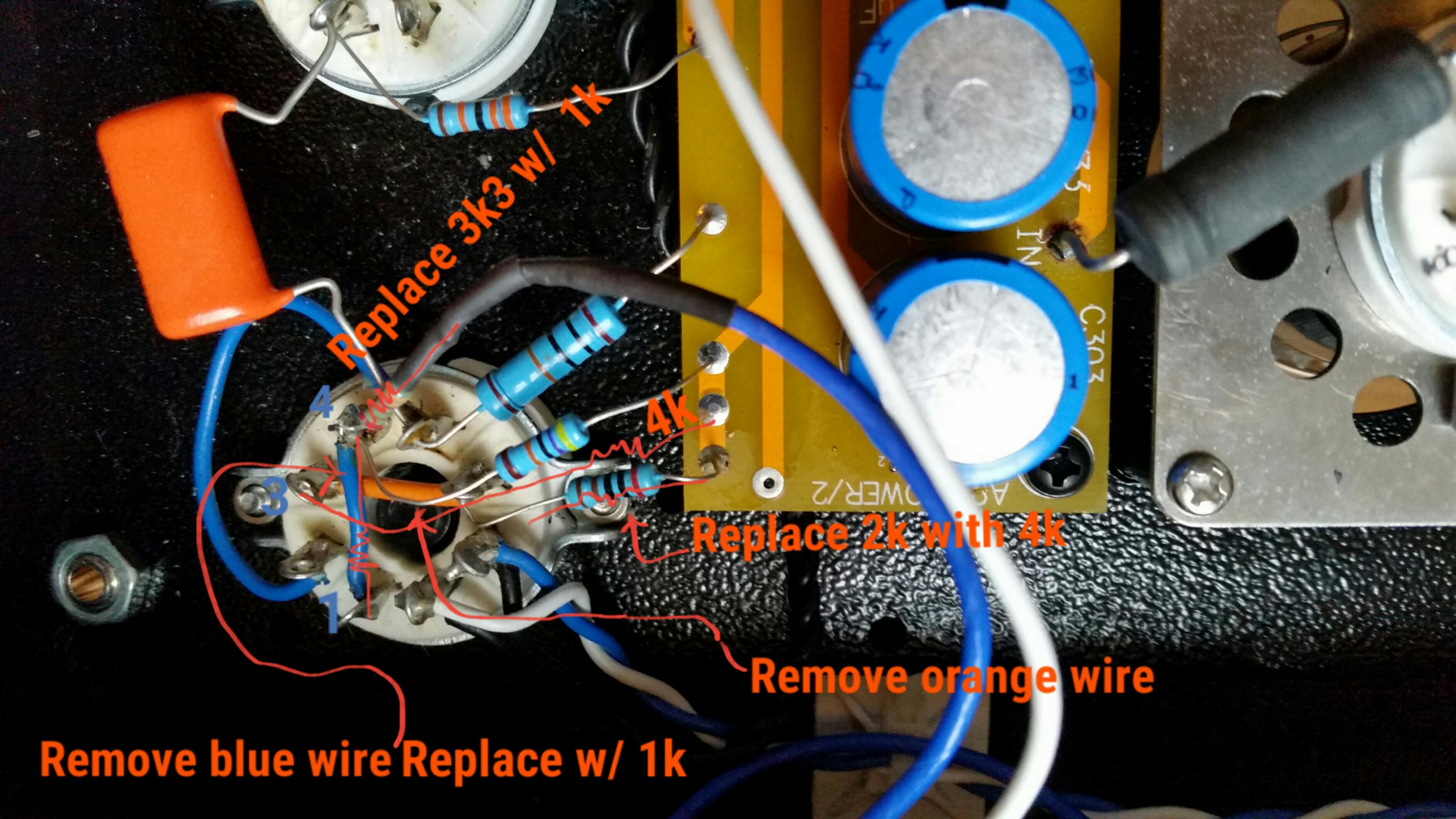

I think this is what you are saying. Replace the 3.3k grid resistor with a 1k resistor on pin 4 add a 1 k resistor on pin 1. i have it going from pin 4 to 1 remove the orange connection from pin 3 and 6 have a 2k resistor going from 3 and another going from 6 to ground
Can i not do it just as I've shown in the picture? why do i need a solder lug strip. I've never used one.

Sorry for the confusion. The the reason why I edited that picture with the proposed layout was so that you can see exactly where the new resistors would go to the circuit board. I've made a sketch it's pretty much the same as VictoriaGuy's sketch

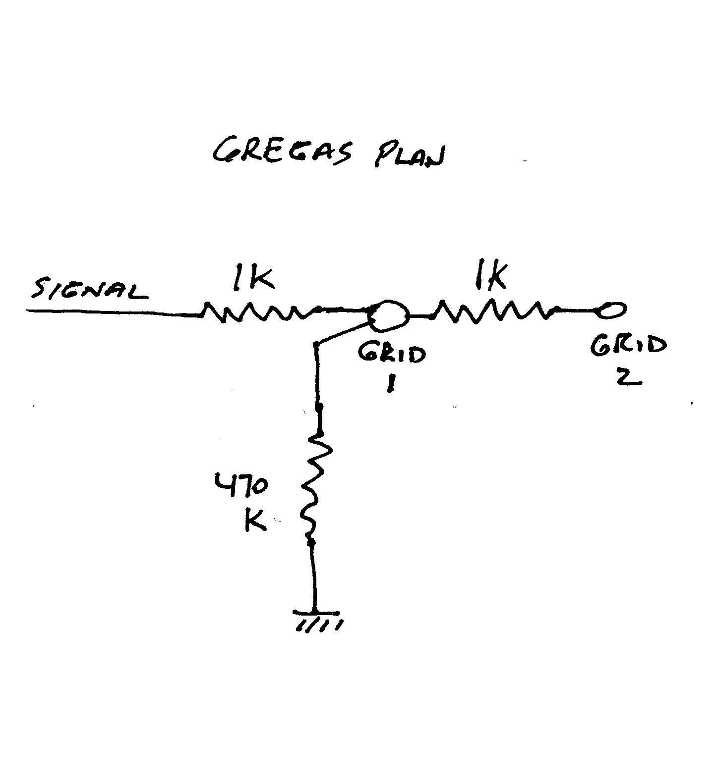

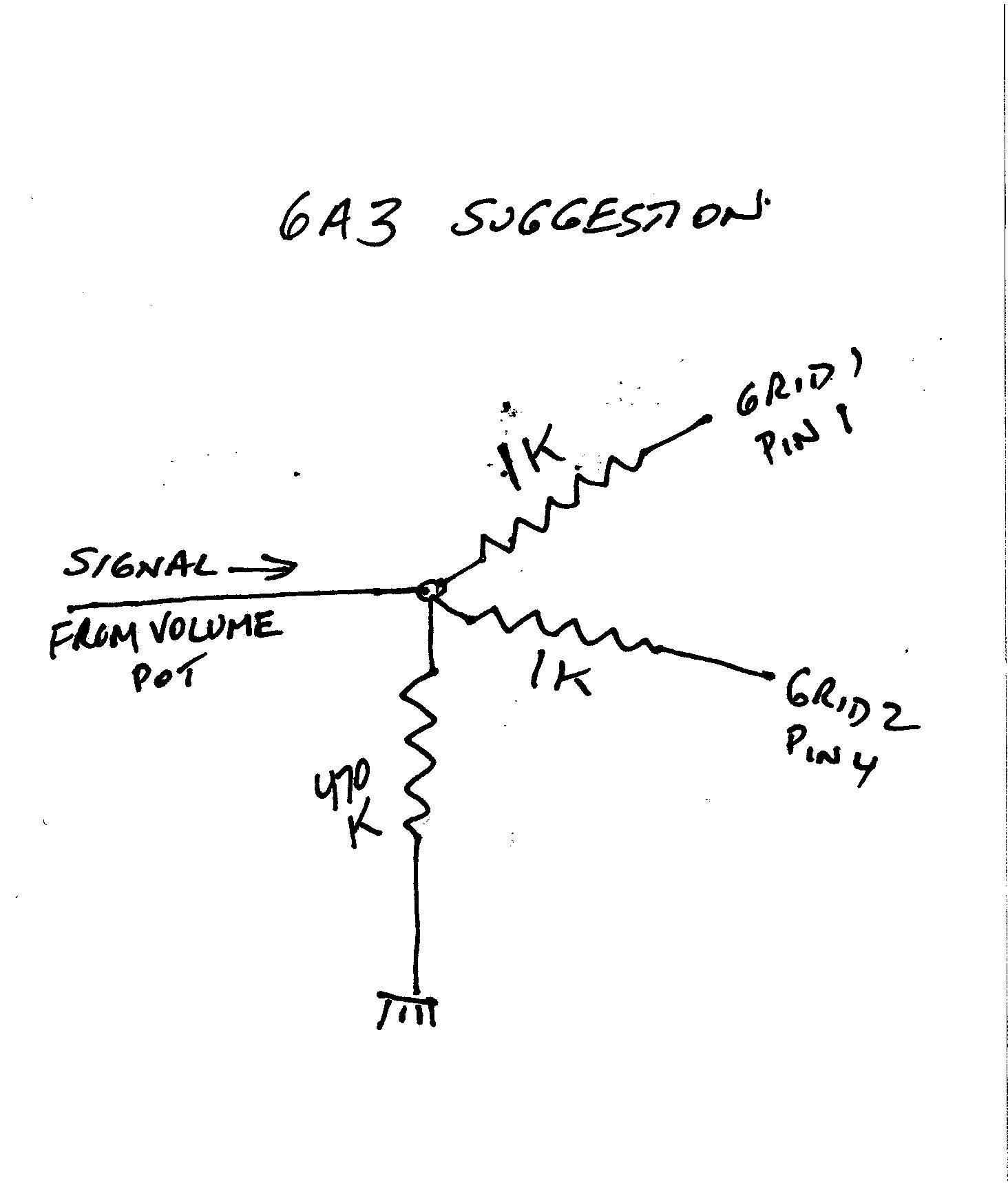

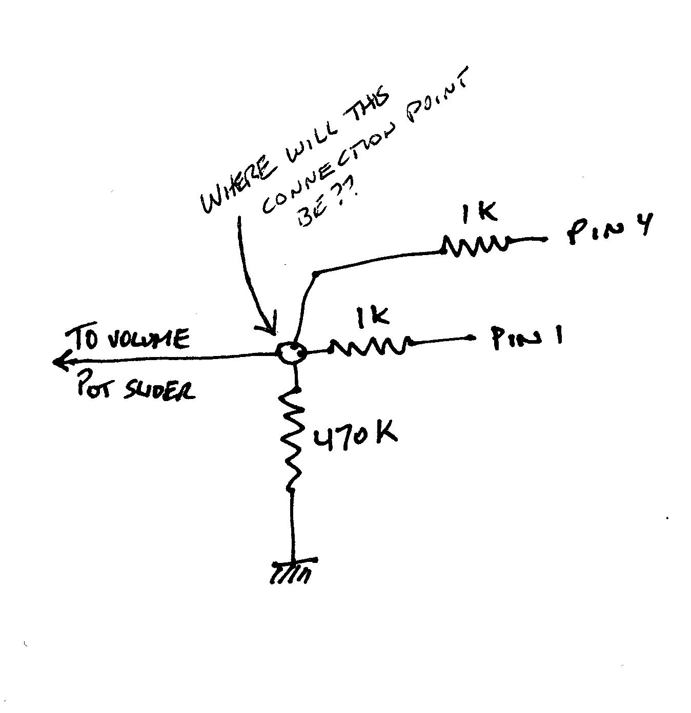

The 470k grid resistor should be moved from the tube socket, according to 6A3's suggestion.
That's why I said:
The important thing is that the grid stoppers connect right to the tube socket (close), and the 470k is not connected to the tube socket - as pointed out by 6A3, all the connections to the grid have to 'go through the stopper'. So you may have to find a new spot to join the two grid stoppers, the 470k resistor, and the volume control wiper. If the volume control is close enough, you could use it for the connection point.
It's not a good idea to make joints 'in mid air' but it seems to be done fairly often, so that could be a last resort. You may have a spot nearby to connect a solder lug strip with a couple of (non grounded) connection points.
The circuit will probably 'work' with several different wiring arrangements, but if you want to implement 6A3's suggestions you need to find a connection point.

I don't think so, and I don't think making all connections on the tube socket agrees with your last sketch either.
Sometimes it's useful to try drawing the same circuit in different ways.
Part of the idea here is that the two grids should 'be the same'. Think of how the 'signal' gets from the volume control to the two grids - the paths should be identical. Also the way that each grid connects to the 470k grid resistor should 'be the same'.

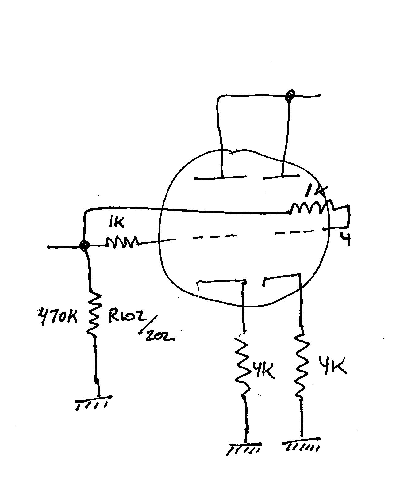

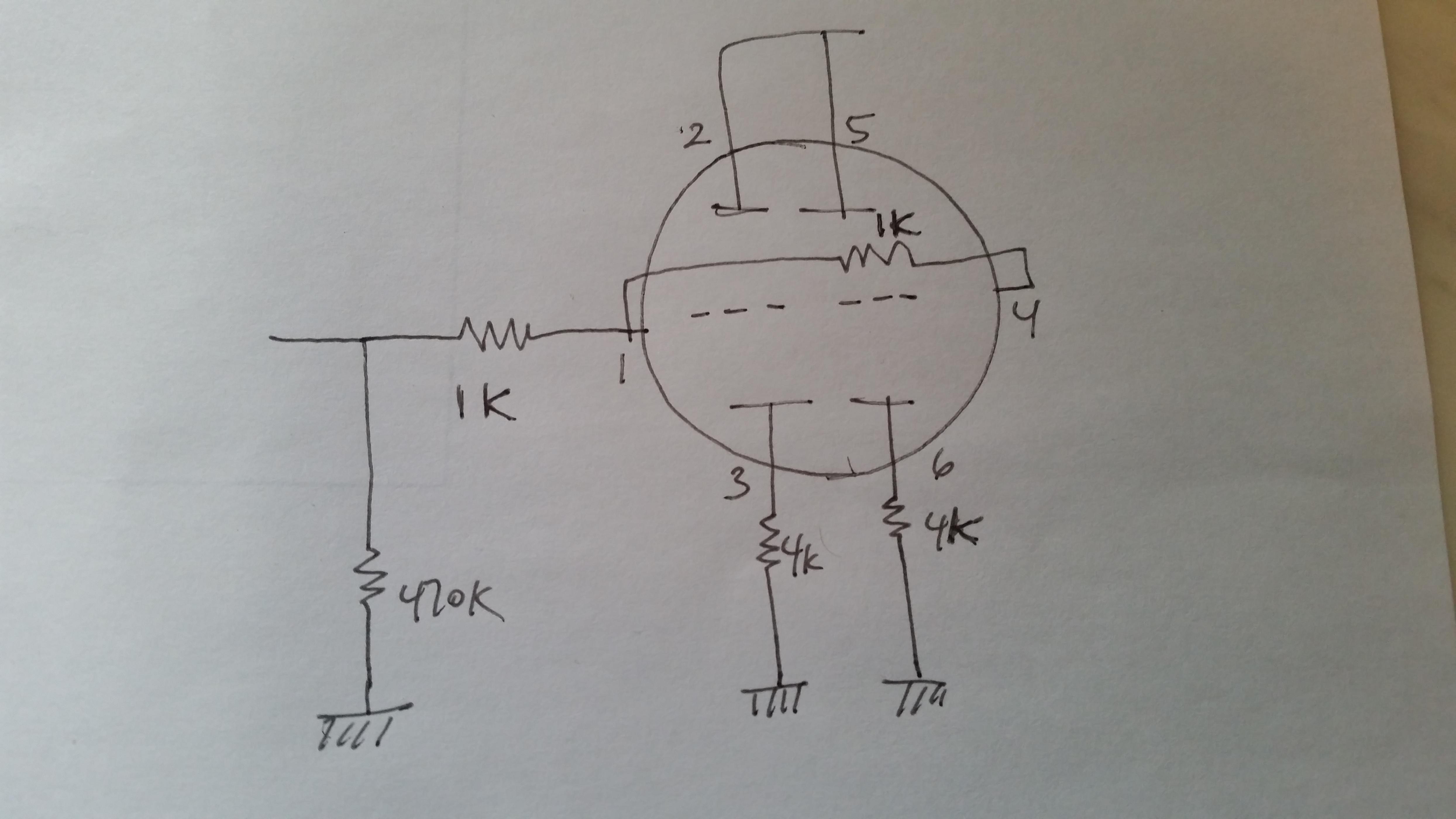

VictoriaGuy,
I. Thanks for posting a drawing of the grid circuit I wrote about, but I did not make it clear enough. Your drawing should make it clear to all.
II. Also, it should be noted that in the other schematics, the individual input triodes cathodes should connect through individual 4k Ohm resistors to ground (pin 3 to 4k Ohm, other end of 4k to ground; and pin 6 to a second 4k Ohm resistor, and the other end of that second resistor to ground).
Note: use matched 4k Ohm resistors.
III. Now, this input triodes circuit has quite good DC balance, without selecting input tubes. Because you have separate 4k Ohm cathode resistors, you can easily read the voltage across each 4k resistor, and see how well the two triode DC currents match.
Rather than spending your time to do IV below, there may be other areas of the amplifier that might be better to pay attention to, etc. Instead, if the DC currents of the input triodes is not balanced, just swap out tubes until you get one that is better matched. Do not worry about a 10% or 15% mismatch of cathode voltages, but do worry about a 30% mismatch.

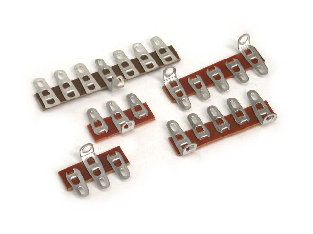

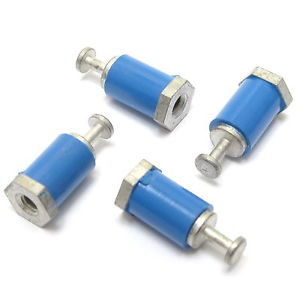

The usual way is with a machine screw (aka small nut and bolt) if using a metal chassis. Often one of the solder lugs is the extension of the attachment bracket - so it will be a 'chassis ground' connection. Make sure you don't absent-mindedly use it for a 'non-ground' connection.
Not that I would ever do that....:eek:
I will say that nowadays I often slip a piece of heat shrink on that ground lug as a reminder....
Solder lug strips come in various lengths and configurations, and are handy things to have on hand.
Insulated turrets and tag strips are also useful if you are stocking your parts bin.

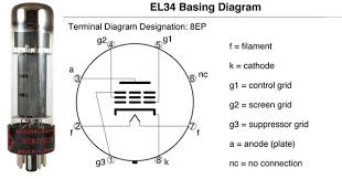

This might be a stupid question but I'm asking anyways!
Looking at the EL34's datasheet I noticed that pin 6 is not used. Can I use pin 6 of the valve socket as a solder terminal to solder R106/206 to the output transformer wire? That would avoid me to having to buy a solder terminal just for that.

You can use pin 6 as long as you do not do tube-rolling with other types of tubes that do have a connection to pin 6.
I believe that most other tubes with similar characteristics to the EL34 usually do not use pin 6.
A KT77 is probably closest to an EL34, except that the EL34 has to have a connection to
pin 1, which is the Suppressor Grid, and that Suppressor Grid needs to be connected to pin 8, the cathode.
The KT77 does not have a connection to pin 6, and does not have a connection to pin 1.
