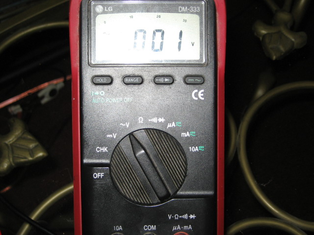

My noise readings are 1.7mV AC and 1.6mV AC. I removed one of the input GRD cables, then made a cut in the one left in the chassis and connected it to both amps, the noise reading now is lower in one of the amps than the readings I posted in post #312 but the noise can still be heard, in the speakers and in the chassis.
My multimeter is giving me those figures in the digital display, it reads 1.7mV AC and 1.6mV AC, it doesn't show any zeros.

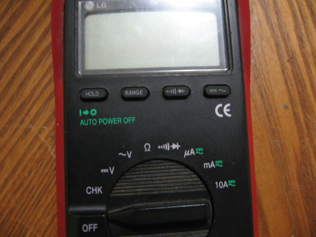

I am assuming it was an analogue meter?
What scale was it on, 1V? Or e.g. 10mV?
The specifications of the multi- or voltmeter will often tell you that the measurement has a certain possible error. If it had been a digital meter and you actually read 0.001V, the error in the measurement probably is big enough so that the actual voltage might be 0.00001V or 0.003V.

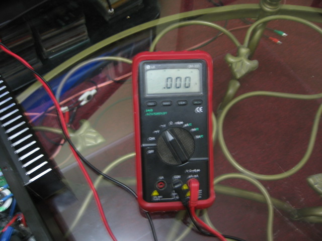

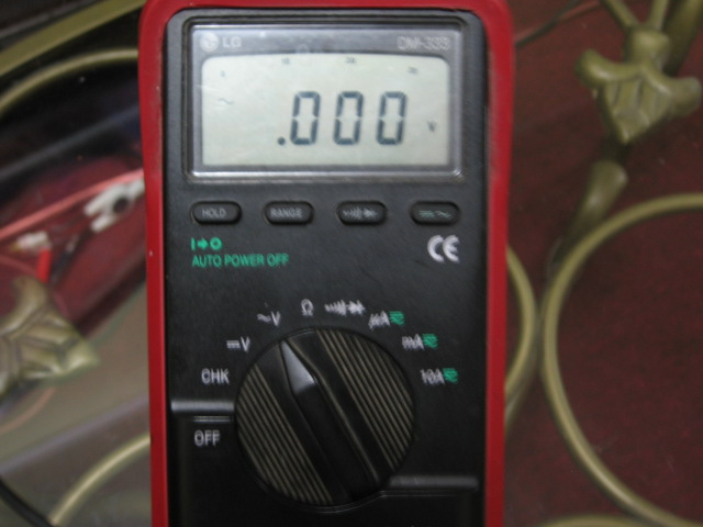

it is a digital one! As you can see here, it shows .001v and .000v

Try to push the "RANGE" button a few times, it might give you a range more appropriate for measuring mV.
EDIT: Nevermind... According to the specs here, it should have a 320mV DC range, but indeed only a 3.2V AC range. It's simply not suitable for this measurement.
As said, the 0.001 has no meaning. It's somewhat like trying to measure inches with a rod that only has a scale in feet.
I get confused by accuracies of meters all the time at work, so I won't try to teach a course on it here
But as seen in the specs I linked, the basic 1 year VAC accuracy of said meter is 1.2%. I'm assuming this is 1.2% of the scale.
So if the meter is 1 year old, it can already be off by 1.2%. The scale is 3.2V so the measurement could be off by 1.2% of 3.2V which is 32mV. So trying to measure 1mV with a meter that can already be off by 32mV, is understandably, not very useful.
I'm not even touching the base accuracy which can make this worst case scenario even much worse.

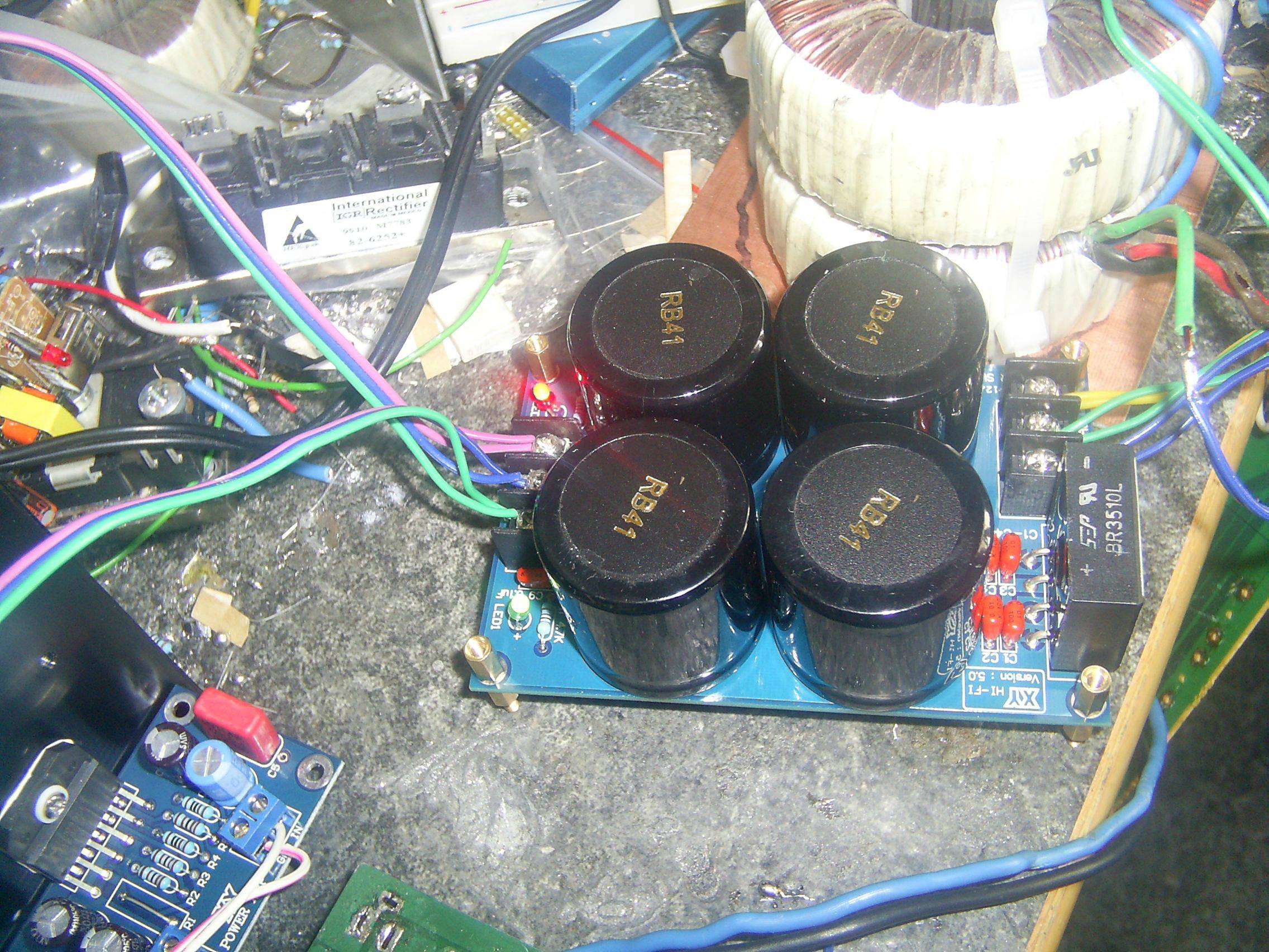

I found hum in mine was caused by wires running past the transformer.
Moving them reduced the hum quite a bit although there is a still a small amount still there.
That's what I'm going to do next, I'm going to relocate everything so there is no wires running on top of each other. Anyhow, this is funny, when I first put these things together, ALL my wires were a total mess but there was NO hum of any kind. When I removed the old amps to try the new, I twisted some wires to make it look neat, that's when the hum started....

One other point about the interaction of wires and induction.... When you do have to cross wires try to cross them at 90 degrees. That will help with hum issues too.That's what I'm going to do next, I'm going to relocate everything so there is no wires running on top of each other. Anyhow, this is funny, when I first put these things together, ALL my wires were a total mess but there was NO hum of any kind. When I removed the old amps to try the new, I twisted some wires to make it look neat, that's when the hum started....
Excellent points! Dining room in-wall light dimmers too. For those finding that's the only available place in the house for projects.May or may not apply - but also look for noise makers in the area. Fluorescent and Halogen lamps with rheostats are infamous for driving amp builders nuts.

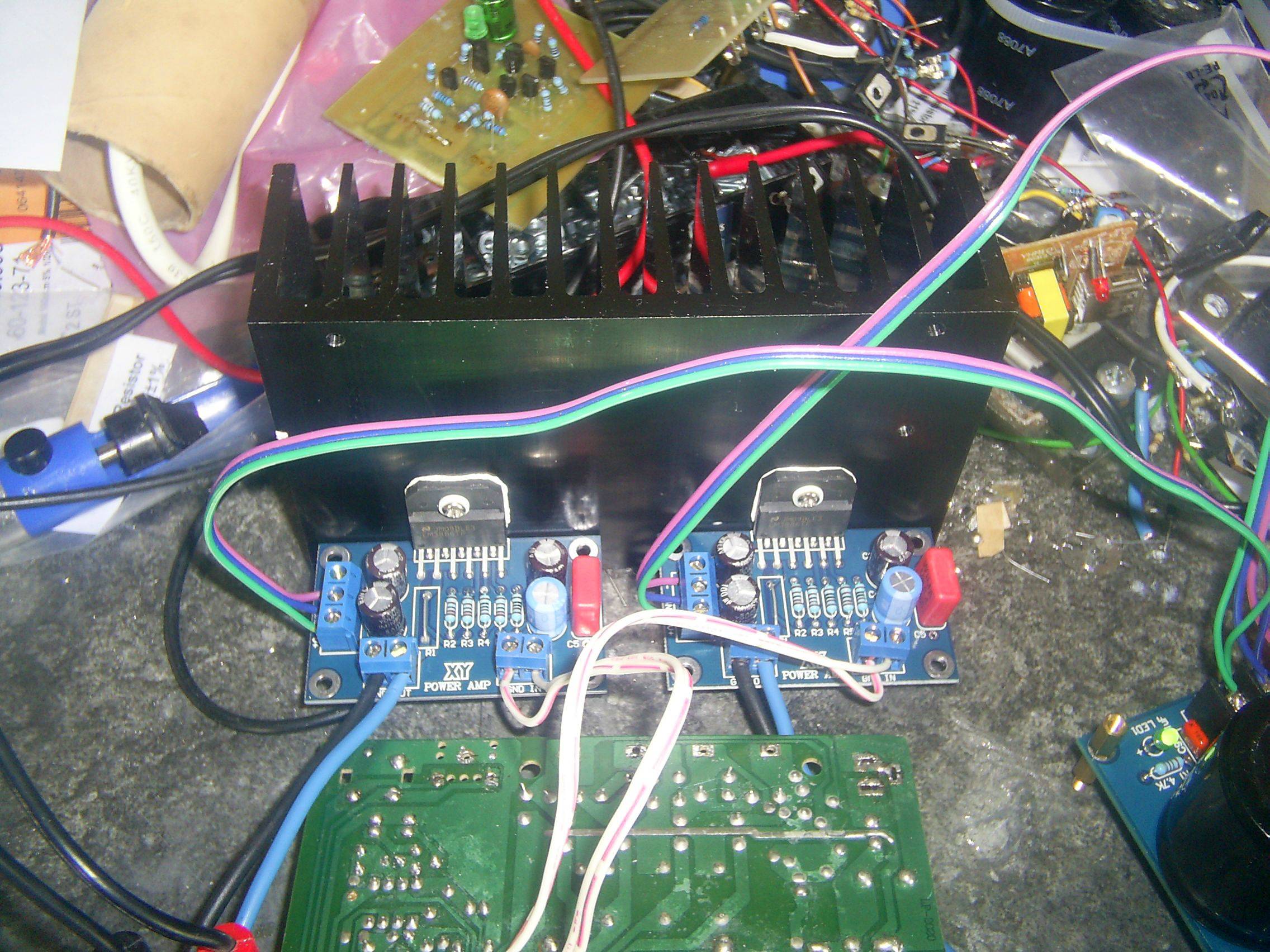

Lanchile, can you post pictures of your amp?. Specially the inside...?
