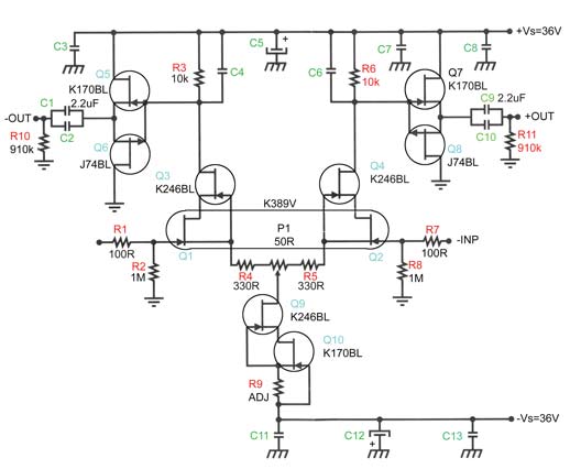

@stoolpigeon: I like that one; IMHO it has some severe compromises however. To get near ground potential for Q5, Q7 P1 is heavy loaded (10k) and again smothered with 330R degeneration resistors. I don't see why one should waste a 389V for that; au contraire maybe a GR with reduced degeneration would be more applicable if one wants to benefit from this dual jfet at all. With this heavy degeneration you could also use matched 2SK170.
Thinking about it, one could probably also rework the Q5-Q6, Q7-Q8 outputs to a current source with follower to get rid of the output coupling cap.
In that case the heavy degeneration could also be dropped.
Basically all doable, it's just a matter of taste
Don't complain, you asked
But I guess your version will do also
Have fun, Hannes
