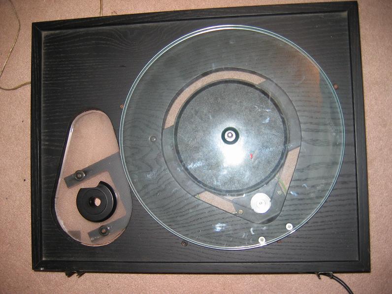

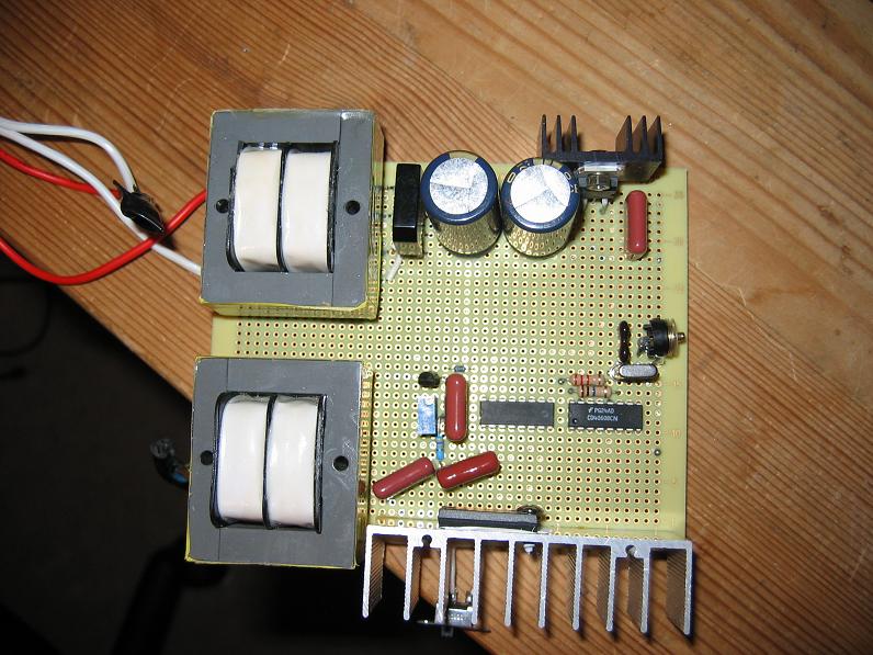

I finished the entire circuit yesterday. The amp and regulator got really hot under no load - nothing blew though. I did manage to get the motor running, but it seemed to stutter a bit. After analyzing the wave form I noticed some distortion. I'm not sure whats going on, I ran out of time. I will have pics including the waveforms later on tonight hopefully.
Here is the top and bottom. Don't bash too hard, this is my first 100% scratch build.
Raw rectified voltage is 16.5V, after voltage regulator 11.74V.
No dectible ripple present, Pure DC.
Tracing the signal...
3.200Khz right on the money.
Filtering and Counting...
Signal to be amplified (a little small at 54mV) - have to work on preamp stage
And the major problems...
At the trans primary (amp output) the voltage is ~4.56Vac (should be 6 roughly) and at the secondary, I'm only getting 123Vac...

Success (partial). The motor is starting up and spinning correctly. I changed the preamp bipolar to a "C945" that I pulled off of an old computer speaker amp - MUCH less distortion. I also connected the amp directly to the power supply. I believe it is picking up emf from the transformer though, because I still see some sort of distortion but no where near as bad as before. I believe I may still need another intermediate gain stage.
I put a bigger heatsink, but I guess it wasn't enough... I have no gain from the amp anymore I think I over-heated and blew the amp preamp stages are all fine. Can anyone suggest a heatsink good enough for this amp? One that will bolt directly on, I'm having trouble finding one. Also, I don't know why but the amp was heating up without any load - just the transformer connected and not the motor. Maybe there is something wrong with my circuit? I wasn't reading anything funny other than those distortions.

I tried the bipolar cap, no luck the amp wouldn't put anything through the primary.
I have added bigger heat sinks, bought 2 new chip amps and rewired everything. The turntable is running now, I can't tell if the speed is correct. The scope is showing a DC offset problem (waveform is jumping around, not stable) and this amp still runs really hot, any idea where I can get a bigger, but similar heat sink? Other than that its running fine. I think I was putting 6.4Vac into the primary, and 190Vac or so out of the secondary according to my Fluke.
