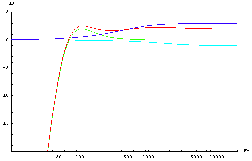

makes sense, lndm.. Anyways, a tapped inductor will let me play with this as well. I've simulated the baffle step in edge (speaker, no shelf) and it shows a significant HF rolloff, and the driver itself is down a very few dB above 7-8kHz.. The sum of this scares me, so would it you think be wise to bypass the BSC with a capacitor to let the high frequencies pass unobstructed?
I'm not sure about the source of your bump but I know that some baffles will display a bump just before they roll off. That is, the bump is just higher in frequency than the step, and potentially a few dB.
Sometimes moving the driver on the baffle can help. I use the excel spreadsheet, rather than the edge (no prejudice, just circumstance). I find it takes me a reasonable session (or three) of trying all combinations before I reach a useful design.
So, not being certain, I would suggest the highs are at the normal (reference) level.
lndm said:I'm not sure about the source of your bump but I know that some baffles will display a bump just before they roll off. That is, the bump is just higher in frequency than the step, and potentially a few dB.
That sounds like the 2.5dB bump centered around 1300Hz

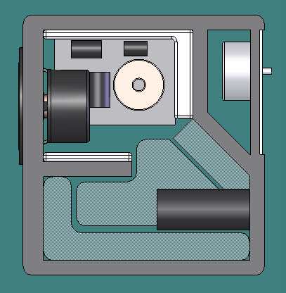

OK, it's time to sum up the game plan, I think my design are finalized.
The FR125S will get 7 liter tuned in the 60Hz range. It'll get a zobel of a resistor equal to it's Re (7ohm) and a 8.2uF capacitor, that zobel actually shows flat impedance from 1000Hz to 20kHz within +/- 0.02ohm of Re
Then the BSC: a 0.6mH air core 14AWG coil (0.12ohm DCR) tapped at every 0.1mH, a rheostat in the 6ohm to 10ohm range, I'll find a suitable one on ebay perhaps bypass it by a fixed R if need be. I will also include three cheap Solen caps on the crossover board so I have the opportunity to pass the highs outside the BSC, 2uF, 4uF, and 8uF. I will source ebay for a rotary switch that is bulky enough for speaker signal to control the coil.
But here is a neat part of the design I think: I've integrated a control panel in the speaker design: all control wires from the crossover board will end up behind this panel, so that, until I source the rheostats and switches I need, I can tune it by detaching the panel and connecting the proper wires. I am thinking 3mm aluminium for the panel, and a rubber strip around the mounting slot so it won't vibrate from the bass.
The damping materials shown in the picture is akustilux (the white stuff.. 2cm on the back, 1cm elsewhere) focusing on bass-mids, and the grey half-transparent stuff marks where to put 3cm high profiled foam designed to battle mid-highs. The side wall facing up (view side) will be covered in the 3cm profiled foam.
So, how do you guys like it?
