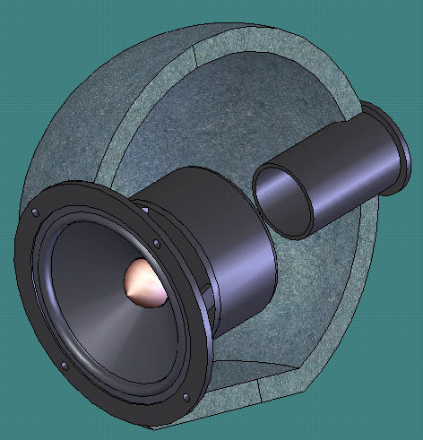

Yeah, and material is MDF. 22mm front baffle, 16mm elsewhere. Side panels will likely be something decorative like 25mm-30mm mahogany, since the MDF will be painted boring black I think. The crossover will be mounted to the side panel..
Any thoughts on adjustments?

I'll be watching this project with interest as I've built an aperiodic box for the FR125 (a little bigger than 7 ltr. total IIRC) and it works fairly well but misses out on the bass. I might drill a port if you have some success. The FR125's long suit is in the imaging. These little drivers throw out a great sound stage. I use them now for surrounds for HT and they do a good job but that's not the better use for them, IMO. Good luck with the build.
I'm in on this late, hope my comments don't send you for a dive....
If you use standard modeling to extract as much bass out of the FR125 as a quick look at the sim graphs indicate you will end up with too much bass instead of trying to extract everything available. Unlike any other driver i've played with, the WRs & FRs require designing to not have too much bass. I expect an FR in a 7 liter box with BSC will be WAY bass heavy. In my experience 7 liters is too small. 12-13 litres is the sweet spot -- turning your design aperiodic may be required, and if it is anywhere near a wall, you'll want to rip out the BSC (in the miniOnkens, even 4 ft out from a wall i prefer them with none)

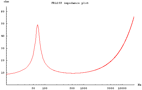

Any idea why this is? Since you seem to know this driver well, I would be curious if you have any in-room response curve of a non-corrected speaker using the FR125S?

Not sure... maybe a combo of the XBL & the design drive to see how much bass could be had out of a 5" driver. It really does produce bass.
But like is all to often done with subs, if you design to get the lowest flatest bass in your modeler you end up with too much.

Dave,
Do you think it might be the fall in the response above 10kHz that leads to the perception that it is too bass heavy (i.e. lack of highs)? What I did on it, after calculating the equivalent circuit of the FS125S, I imported the response graph from your webpage to an FTABLE in my Capture CIS, I ran an "Edge" simulation (the baffle step proggie by Svante), divided the results by 2 (3dB baffle step instead of 6dB) and placed these numbers in a FTABLE as well. I ran it in PSpice, composed a zobel and BSC, and while I got it flat up to 10kHz, I got a significant dip at 10kHz and upwards. I didn't get satisfactory simulation results until I added a 6.8uF capacitor in parallel with the BSC.

Rocky said:Do you think it might be the fall in the response above 10kHz that leads to the perception that it is too bass heavy (i.e. lack of highs)?
No. I've heard these (& WRs) XOed to tweeters of all sorts and it is just too easy to get too much bass.

Rocky said:OK.. would it perhaps be worthwile to try one of those "acoustic vents" that claims to emulate a larger volume for a closed box? My local DIY store has them, but I've never tried them.. I can't go any larger than 7l...
Yes... it has been our method of taming unruly FR125 BRs/ML-TLs, even the MiniOnken which is already heavily towards aperiodic benefits in some rooms.
I personally wouldn't bother buying aperiodic vents -- they are too easy to build (sandwich a 2 or 3" piece of fiberglass insulation between 2 pieces of mesh). Getting the tuning right is a bit trickier.
Not quite as effective, but it works is to build the BR and then play with stuffing the port -- in some situations an old sock has done the job.
dave
Thanks, Dave. I'll check into that. The shop I mentioned sells them relatively cheap, so I'll rather buy them. They are some 111mm diameter opening, 130mm outter dia it appears from their webpage.. made by ScanSpeak. How much can I expect them to lower F3 of a 7 liter "closed" cabinet?
12-13 litres seems the sweet spot... as close as you can get to that...
I note that in your drawing you are using 3/4 & 1" material. If you use ply 1/2" is suffiicent (just make sure that you have a brace running from the baffle/back of magnet to the back of the box -- if your box is taller than it is wide the brace should run vertically)

With Great Dave around I've prefered to lurk...
just wanted to point out that....
1. if the cabinet walls are bent/curved you can get by with 12mm as the wood is prestressed and hence more inert. The easiest walls to use this on are the side walls (then you might have to relocate your filter)
2. one place to relocate your filter wold be to the top of the cabinet. then on can remove the top and tune at will without disturbing the rest of the speaker.
