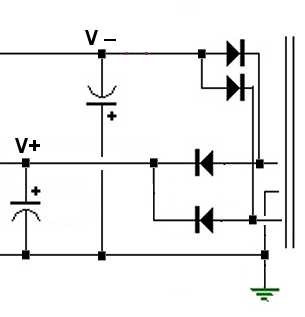

I would worry about the negative supply for the current source. At power up there will be no voltage there. Current can't flow through the return diodes from ground to the transformer windings as they are in opposition to the negative supply diodes.
Once everything starts conducting, there will be a current path through the current source, through the LTP and back, however I doubt the minus supply will ever function properly.

Now for the dumb questions. Why can't I just use the LM317 like the 334Z in this circuit?
http://www.diytube.com/st70/diytube_st70_B.pdf
No neg voltage required?
I found a current regulato calculator for the 317 and 90 ohms gets me 14mA.
LM317 / LM338 / LM350 Voltage and Current Regulator Calculators Just in case you want it.
Am I missing something?

No, you got it. 91 ohms = 13.74mA, 90 ohms = 13.89mA. No negative voltage required.
91 ohms is an off-the-shelf resistor value, which is why I mentioned it. 90 ohms could be made by paralleling two 180 ohm resistors. Whichever you prefer.
The problem with running the LM317 straight from the 6CG7 cathodes to ground is that the LM317 needs a couple of volts across it to operate. If the 6CG7 is overloaded and is driven close to grid current, the bias would go close to 0V and the LM317 would stop conducting. The distortion would be spectacularly horrible. So I like to see it used with more like +5 or +6V minimum Vgk for the 6CG7's.
Try the LM317 with a set resistor of 91 ohms and see what voltage appears at the 6CG7 cathodes. If it's higher than +4V to ground, then I think it'll be OK. If it's lower, then you should increase the value of Rset to 100 ohms. That will put 6.25mA on each 6CG7 triode (about 12.5mA combined).

RE: Getting positive supply and negative supply from a single secondary...
Once in the past, I used a center-tapped secondary with two diodes to form a full wave rectifier for positive voltage and two more diodes in reverse to form a full wave rectifier for negative voltage. This worked fine.
Could two diode bridges be used in a similar fashion? One bridge would have its negative side grounded, producing the positive voltage, while the other bridge would have its positive side grounded, producing the negative voltage.
If it works with a center-tapped transformer secondary, is there a reason why it will not work with two diode bridges, each forming their own "center tap"?
