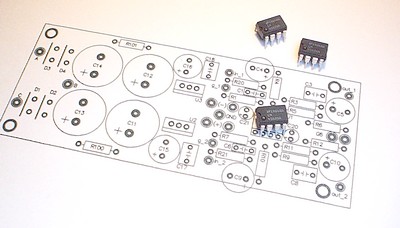

I'm also ready to make some test on the new LM4562 National op-amp especially as preamplifier for LM4702 power amp ;)
