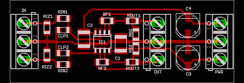

dine1967 said:Can anyone recommend preamp circuit to be used with these opamps? Iam looking to build one and have tried p88 and the buf634+opa627 combo. I want something better.
thanks,
Dinesh
Here is the circuit/layout I am using for some tests. It is all SMD. I would be happy to provide a DIP version with through hole parts if people want it.
Cheers!
Russ
