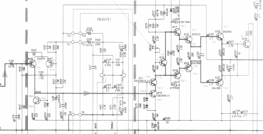

Hello,
could you advice how is possible to implement TMC to Yamaha AX400?
My guess is that it should be instead C130 using 5pF+680ohm+15pF
am I correct?
Maybe is another way to use TMC in this design?
However I wonder if is possible because tone regolators are coherent part of the amp...
I Like the Yamaha output stage, all the way from cascoded VAS to complementary output triple.
Shame about the 3 BJT input stage.
That is why I deciced to buy it as "failured"
I was thinking to remove tone regulator and use fet/bjt cfp input instead those 3 bjts
and use TMC.
Next step will be use MKP caps instead the electrolytics.

Hi Pawel,
As near as I can tell, this amplifier does not use Miller compensation. In any case, it is extremely difficult and risky to recommend changes to compensation of a power amplifier at a distance. In any case, I can't suggest that you try TMC on this amplifier.
Bob
On almost the same argument, is there any solid argument against implementing TMC on a bootstrapped VAS that drives a CFP output? I am speaking about a new project.
Thanks in advance
effebi
Hi effebi,
No, I see no argument against using TMC for such an amplifier.
Bob
