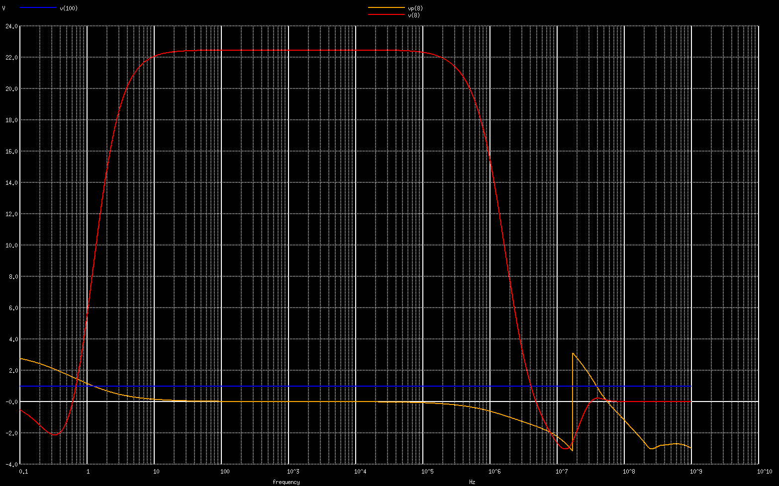

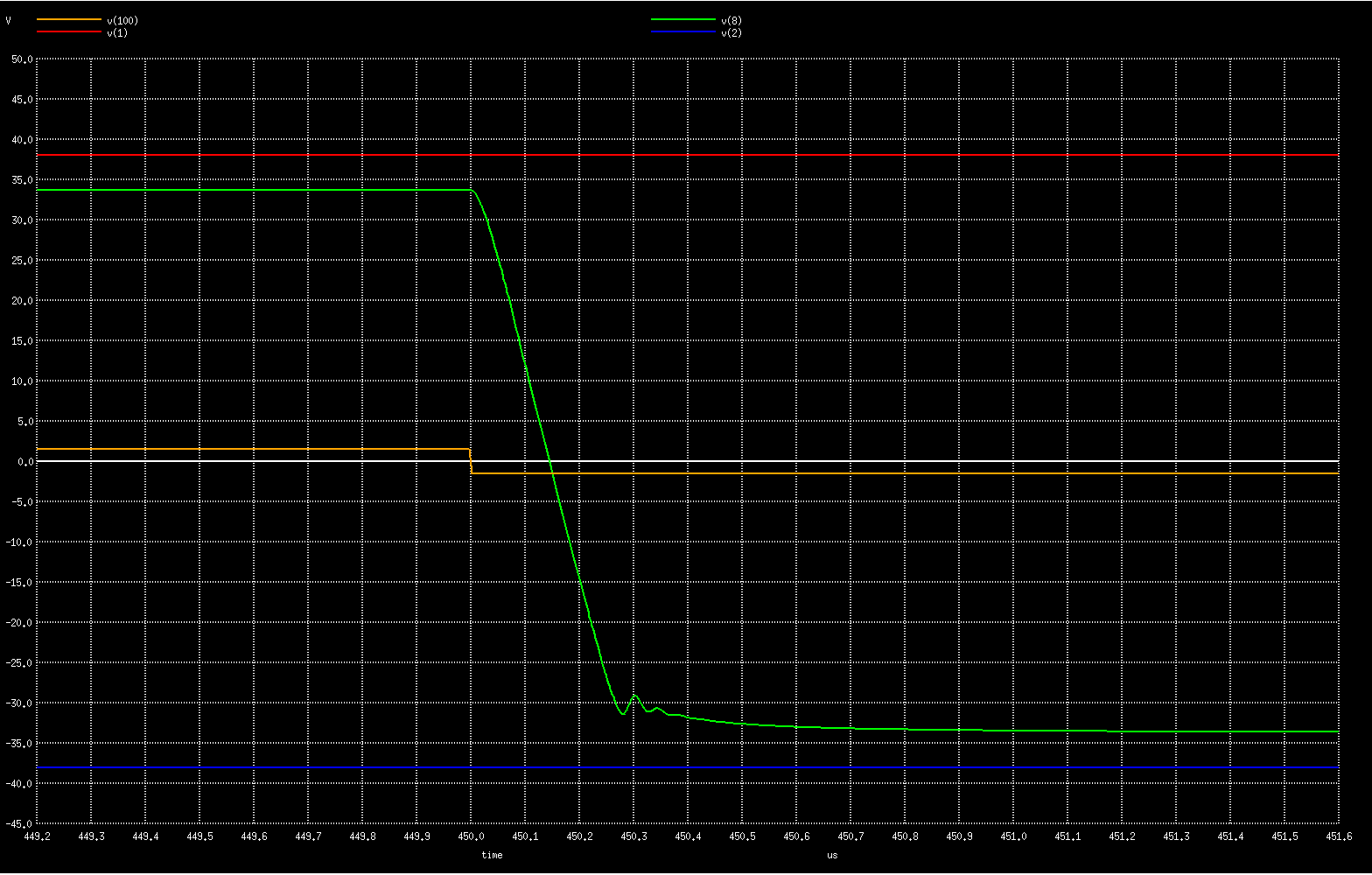

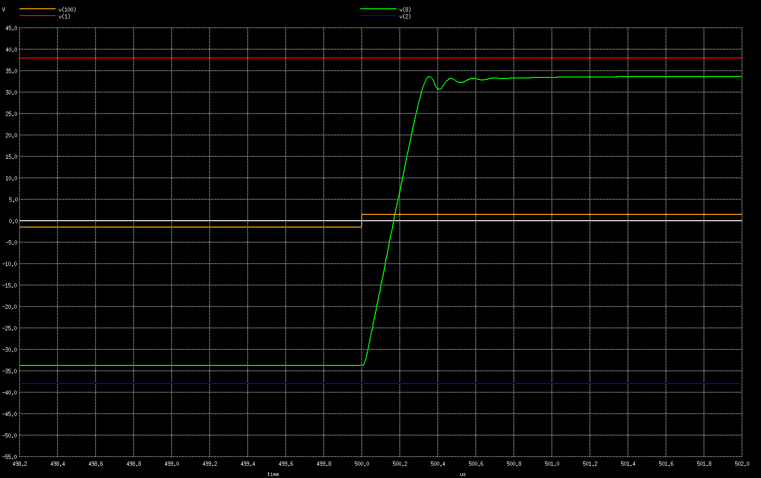

Thanks, Wahab,
It is obvious that you simmed a sightly different circuit, but
1) the input CSS's are somewhat 'floating' (without the servo) so the common node R29, R31 must be tied to GND (0V).
2) You did a different buffer + output but this should be of less importance, as you needed to adapt it to the output BJT's
3) This circuit also NEEDS the low pass filter C2 in my schem, and I've noticed that you used a order of magnitude lower impedance R30,R6, Mine is100R,1n cap and 75k in ||.
4) Ft is at 4 MHZ and the phase is about -1.45 radians ~ -83° wich gives > 90° of phase margin.
5) See the step response leading + trailing edge, a very limited transient, but it is > 200V/usec slew, so some important perturbation is expected. Ahh now I realise the weird response for step response, because point 1)
The input transistors dissipates ~ 130mW and the VAS ~ 410mW, BD's ~ 1.2W.
Cheers
Arturo

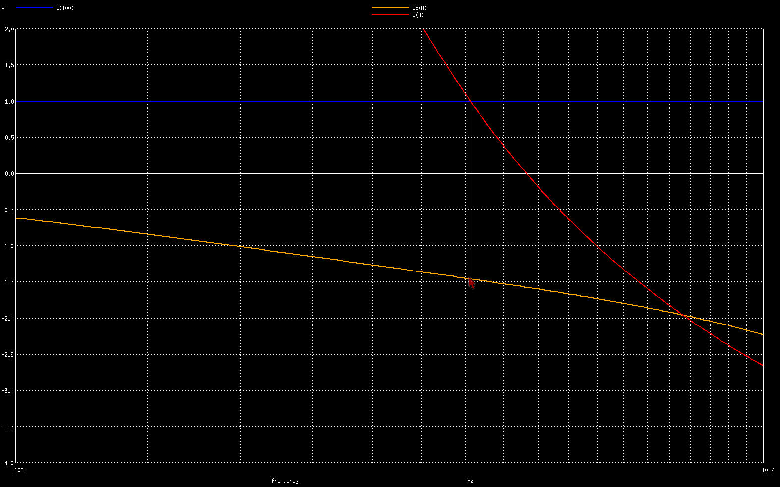

With the 3.3 OHM degeneration and the C5, C6 'dumpers', the phase margin is about 96° (f=4 MHZ). My goal was to stress as much as possible before reaching instability. If you strip C5,C6 caps the amp becomes unstable, no doubt, so in that case the need of a conventional degeneration is mandatory, and maybe also including the VAS degeneration as OS did in CLX. So why such little degeneration? because in part reduces distortion, but mainly it enhances the harmonic content distribution (empirically found), at a very high audio BW (exceeding 100KHZ), OS confirmed same results. The clipping is not as clean as OS CLX, but stable up to MHZ's. Anyway at first live tests I will start at much higher degeneration, and verify how much I can decrease it, and when reaching the final values I will test it with a 4GB HP spectrum analyser (with a friend that works at a telecom company), to see how much 'good' this thing is. The .68R are for stabilize the OPT darlingtons (4 totems which are very hard drived by the 0.8 OHM output impedance buffer) as much as possible to prevent thermal runaway (despite the thermal coupling), each one will be loaded with a current bias of 675 ma, so the total quiescent current wil be ~ 2.7 Amps. (Class A, at 100KZ a little bit AB). Yes you are correct the feedback network is TPC (a typo inherited from the previous schematic). As I said, I will have lots of room for experimentation, to tune the final values, and achieve as OS said a very good precise sound (I hope !!!)

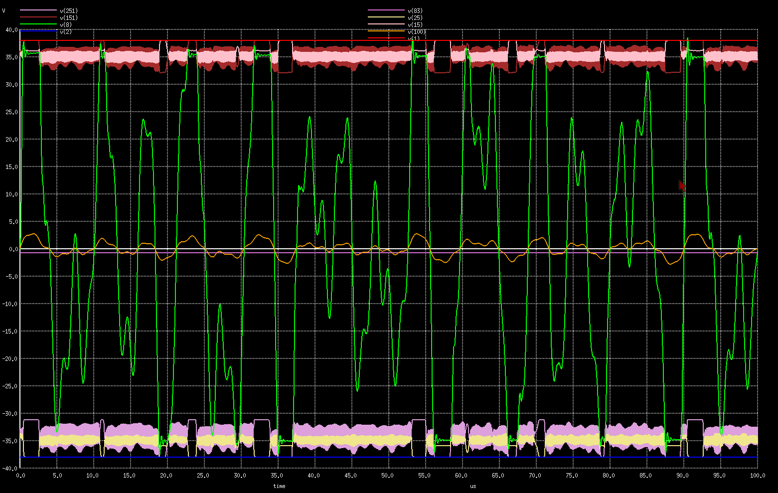

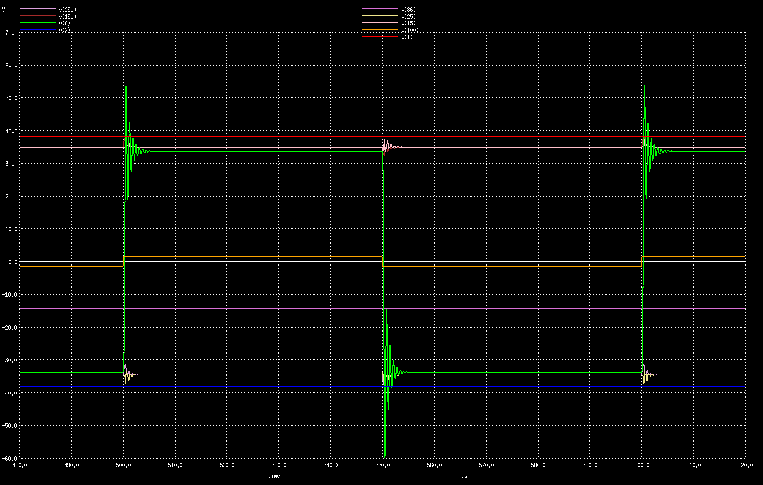

Hi Bob,
I have said many times that amplifiers sound different because they misbehave differently. They often don't misbehave in detectable ways on the test bench, so that gives rise to the disconnect between measured results and listening results in real-world situations. This is partly responsible for those who want to throw measurements out the window, also not a good idea.
I have a suspicion that a number of amplifiers out there are occasionally bursting into parasitic oscillation under certain conditions of program material and real-world environment, giving rise to poor sound from an amplifier that otherwise one would think should sound very good.

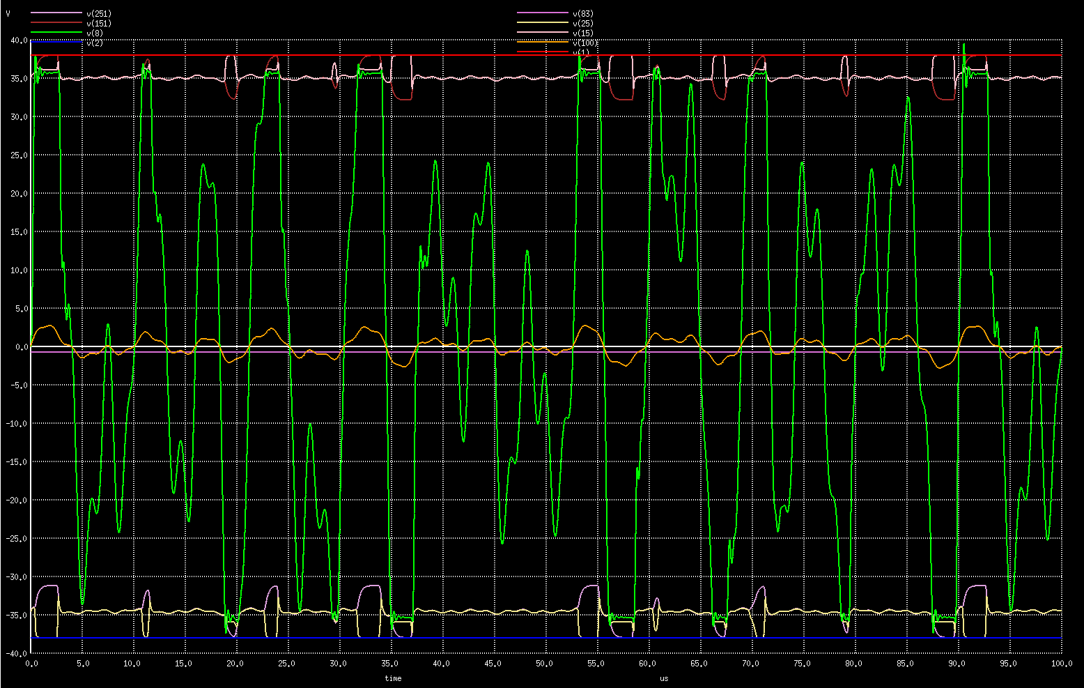

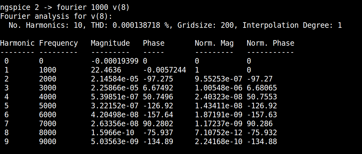

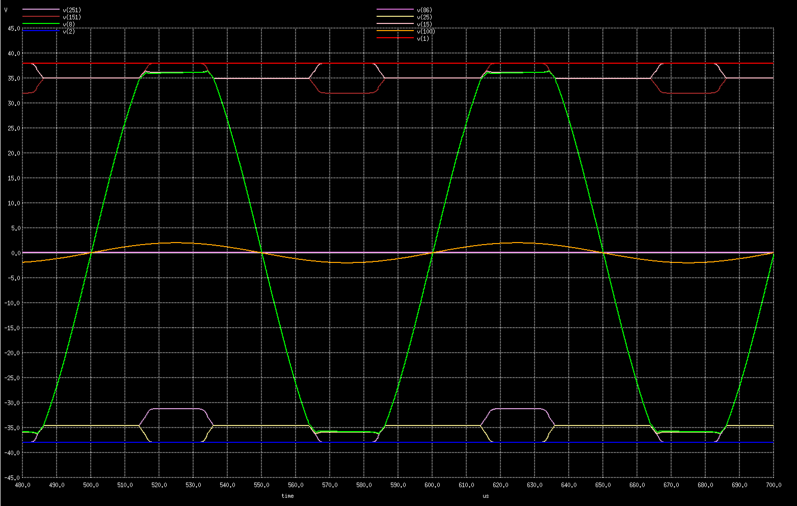

To put it more 'real' your assertions, I have done 2 simms. that shows the case. Both amps are the same (my design topology), without the LP input filter, signal DC coupled, the only difference is that one the 'unstable' runs without my compensation scheme (the values of the amp are slightly different from the original with a degeneration of 6.8R {enough low to show the truth of your assertion}). I've put a 'resonating load' at about 3MHZ to trigger the unstable condition (overshot while clipping is the resonance of the load itself). I've feed both amps with the same 'music material' at a rather high frequency (100KHZ), but it doesn't has importance (can be scaled to any freq.). So the input is asynchronous and has different levels of amplitude from low, medium, high, soft and hard clipping levels. Your suspicions are quite REAL as both amps are APPARENTLY reproducing the same 'music' while the unstable amp is oscillating at 20MHZ and music is modulating the oscillation showed in the first pix (RED,PINK,PALE YELLOW,PALE VIOLET traces at VAS input). Now with my compensation scheme (C5=C6=680pf) the stable reproduction in the second pix with the same 'resonating' load. I could say that this compensation scheme works pretty good as it not degrade slew nor distortion to any extent, I am very amused with this results. The third pix show FFT at 1KHZ 31 Watts RMS output of the compensated version.
Cheers
Arturo

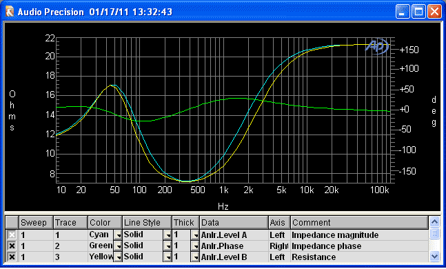

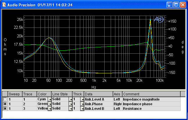

I coupled together the electrical model from Figure 18.1 of Bob's book, then used it, driven through the Edcor transformer. I just wanted to see what the tubes from the Millet Engineers Amplifier were looking at. First is just the load, second is the impedance which the tubes see:
I can understand that the LF load is reflected through the transformer to it's input. That explains the LF peaking and the lower Mid impedance of ~7k
But what is happening in the higher audio band? Why does the reflected impedance seem to hold fairly steady @ 7k and then at 40kHz it peaks?
