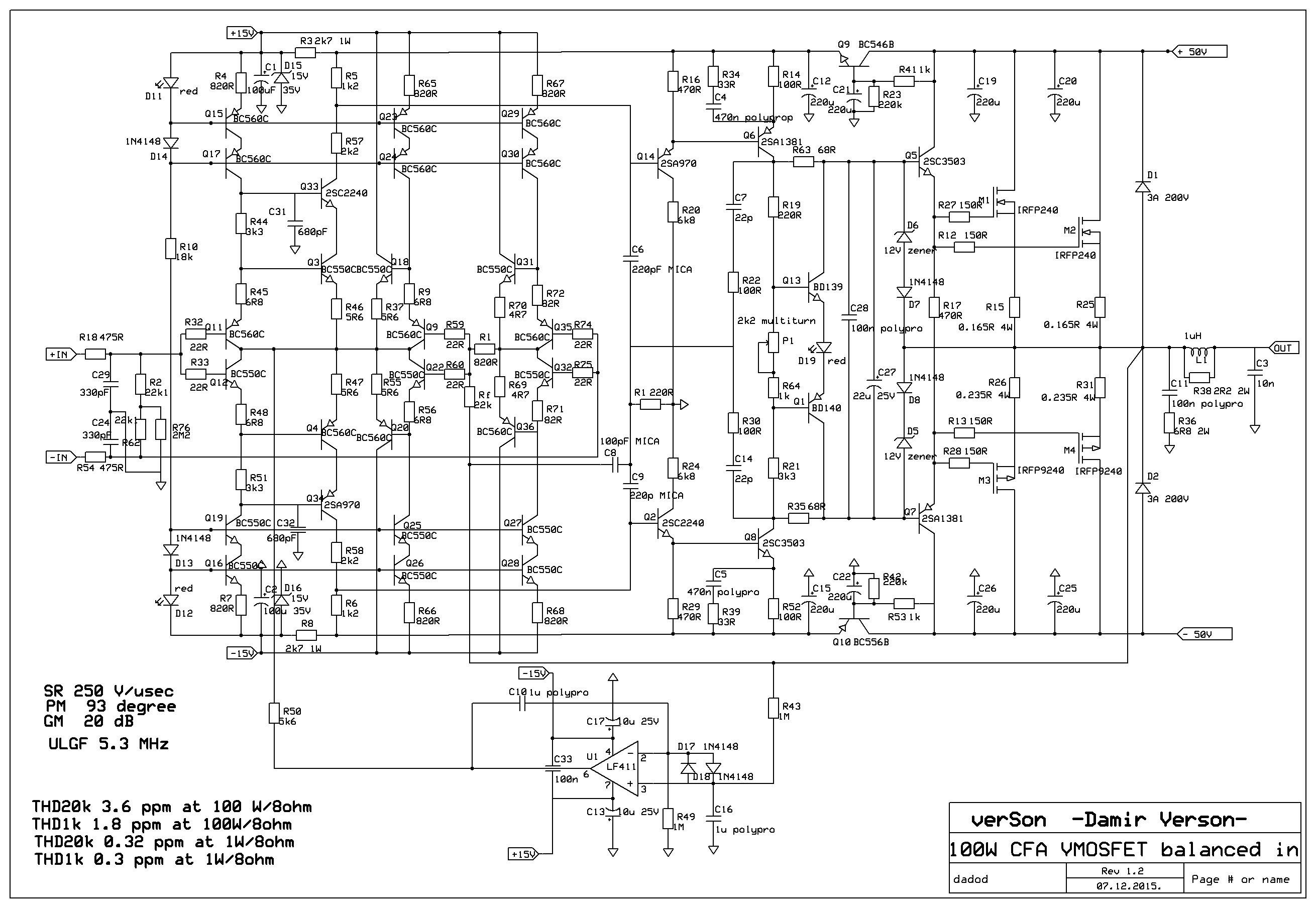

This is my CFA version with balanced input. Simulation showed no significant THD increase with a buffer at inverting input. I have yet to try it in real amp.
Damir
Damir
Looks a bit... complicated. I would urge you to build and measure it at the first opportunity.

Are-you the Douglas Self that answered to a member of this forum, telling-you that you cannot put CFAs under silence in a technical book about amplifiers.: "Yes I can !" ?Looks a bit... complicated. I would urge you to build and measure it at the first opportunity.
The asymetrical version of Dadod's amp has been build and measured by at least two different members, with amazing low distortion (40V, 0.002% 20kHz ?), high slew-rate results.
A bit complicated, indeed.

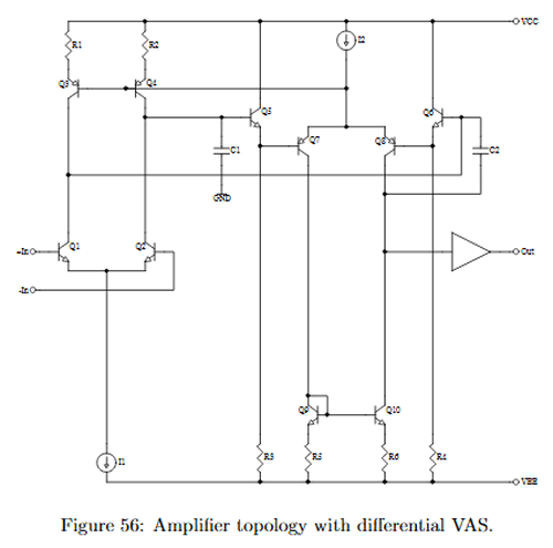

I am interested by the topology of common mode loops (using Q1-Q4 on the schematics below) in amplifiers having a differential VAS as they have been proposed by :
Bob Cordell in his HEC-MOSFET amp
Samuel Groner ( page #48 http://www.nanovolt.ch/resources/power_amplifiers/pdf/audio_power_amp_design_comments.pdf )
Could these schemes do some good against common mode distortion and how could they compare with floating cascodes in the input pair?

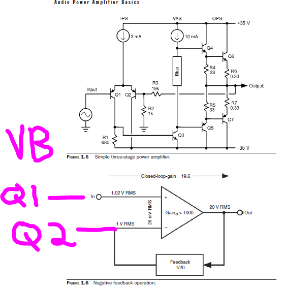

Hi All,
I just wanted to double check that the error signal that is use in the amplifier from the differential pair can be measured and taken directly from the base of Q1 and Q2. So the error factor is VB(Q2) - VB(Q1)? This number multiplied by the Aol = Vout
It is a little more complex - a bit. however --yesterday I measured with 2 Ohm load, 10KHz, .007% THD at 700W !
At <200W into any load or freq is well under .001%. Stable as a rock. 400 V/usec. Very quiet.
THx-RNMarsh
I thought you had built the SE version?
THx-RNMarsh
Yes, this is true, up until the unity-loop-gain frequency (i.e., the frequency at which the loop came is equal to 1), beyond which it gets more complicated.
- Bob Cordell's Power amplifier book
