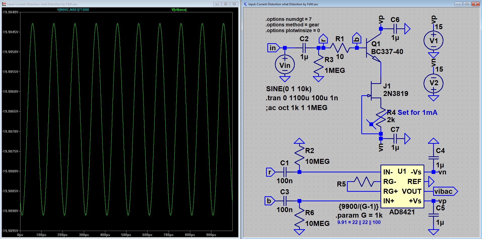

Regarding input current distortion, I remember years ago when andy_c was trying to get the
diff pair input stage distortion as close to zero as possible in simulation. IIRC he was surprised
by the level of complexity that was required, mirror the mirror, cascode the current
sources, etc.
He posted a simulation here where his schematic can be seen, not sure if this will shed any
light on the input current distortion question and I'm too lazy to dig into it again but thought it
might be of interest to others - nice work as usual andy_c:
http://www.diyaudio.com/forums/soli...nterview-negative-feedback-4.html#post1112619
Andy on the unrelated topic of PIM:
Extension of Gilbert

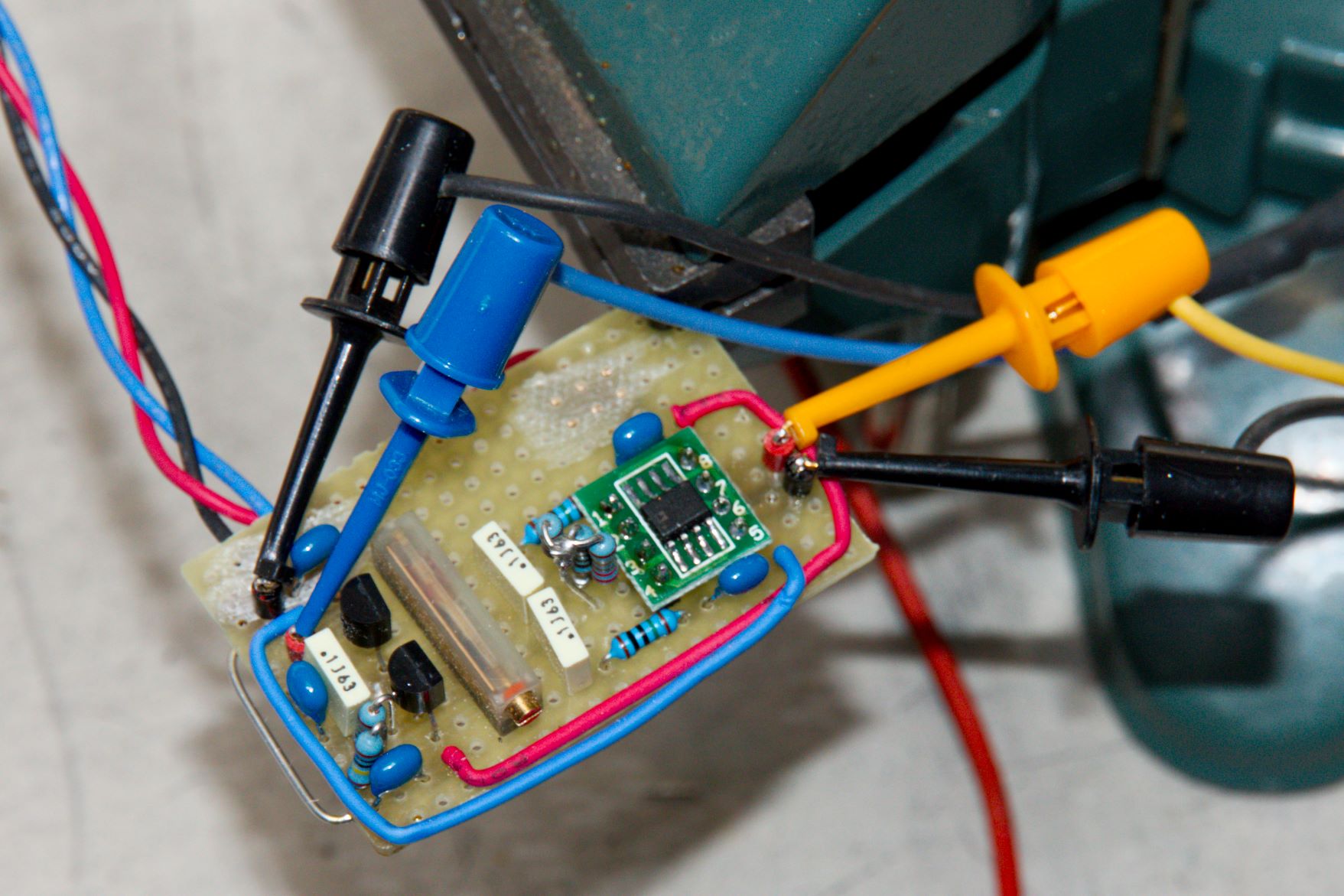

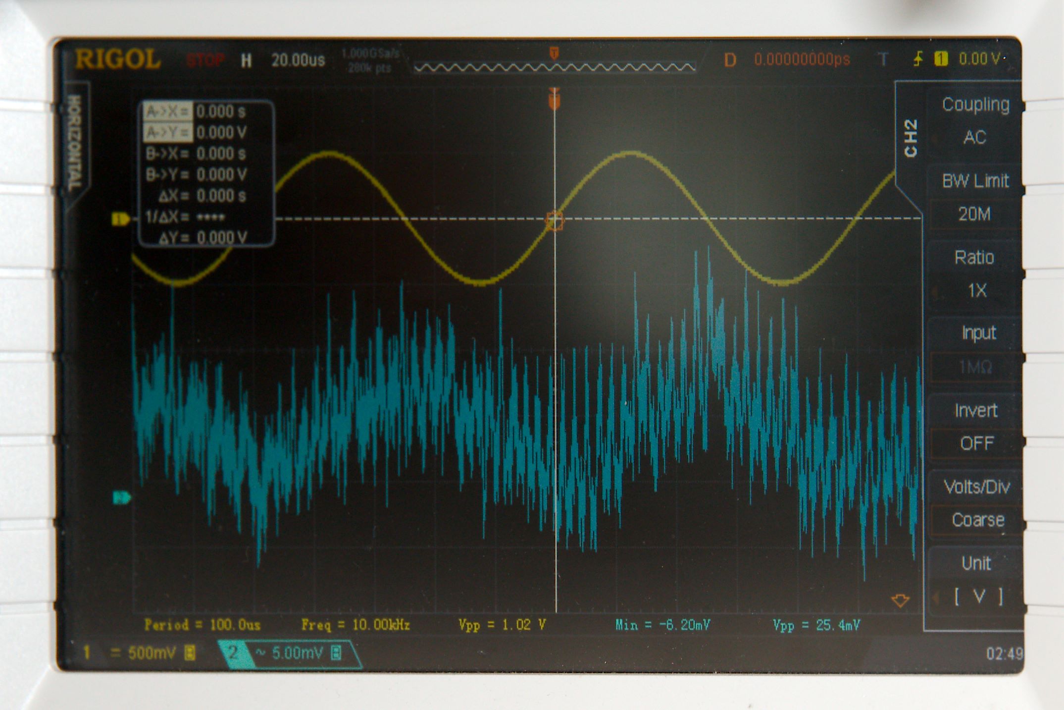

And here my results, actually my non-results, if there is anyone out there who can measure the distortion in a 10mVAC signal (my QA400 is not made for that) and want to give it a try, send me your address and I will send you the experiment.
The only thing that I can confirm from my measurements, the reality matches the simulations, and the AC base current is about 1uA (10mV out divided by 1000 is 10uV in measured over 10 Ohm equals 1uA AC or there about).
It also seems that my lab is way to noisy :(
sources, etc.
