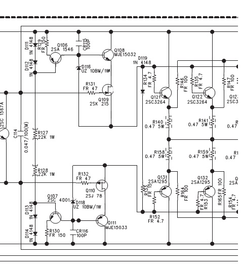

[post #4107]Bob your thoughts on this outputstage plz. In essence the driver stage, its not a straightforward cascode. Japanese highend like Accuphase use it on top models.
That's an interesting looking arrangement that would allow the use of low-Vce BJT devices in positions Q109 and Q110. One would expect that with the relaxation of Vce and SOA requirements of these transistors, you could pick fast devices with high beta. What's unclear to me is whether Q108 and Q111 need to be fast devices in order for this approach to give an overall speed improvement.
In this specific case, I was surprised to find that Q109 and Q110 were high-Vds devices. Perhaps the cascode arrangement is simply to prevent Cgd modulation? I am confused as to why Q109 and Q110 have been drawn as JFETs - when I googled those part numbers I found MOSFETs.
Also, not sure what the purpose of D119 is? Is it simply to allow the dynamic impedance between Q109 and Q110 sources to be lowered without increasing said transistor's quiescent current?

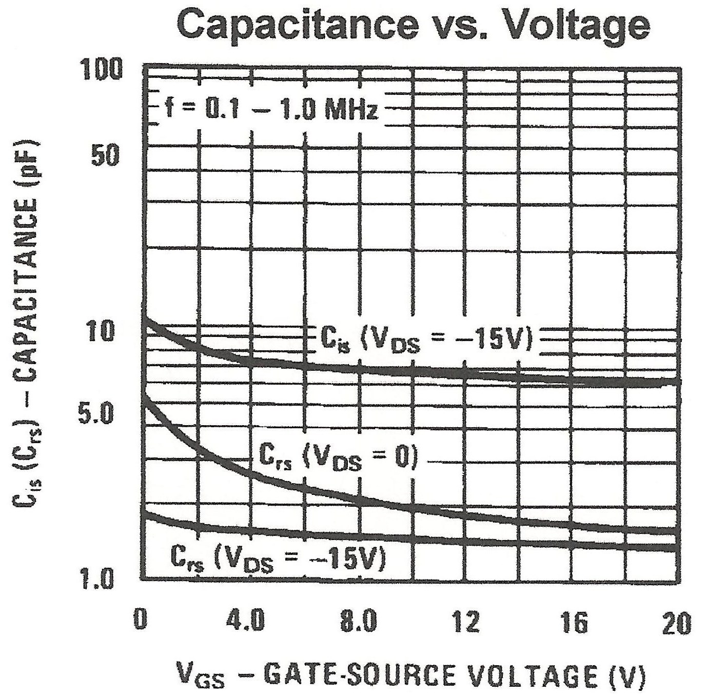

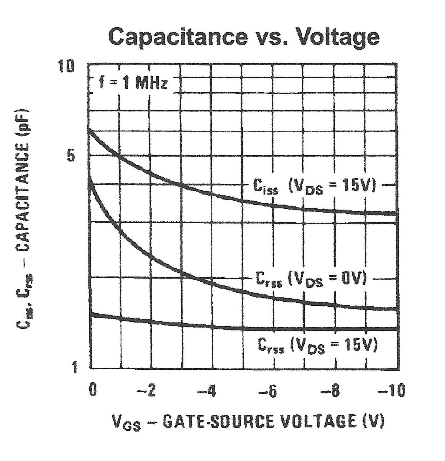

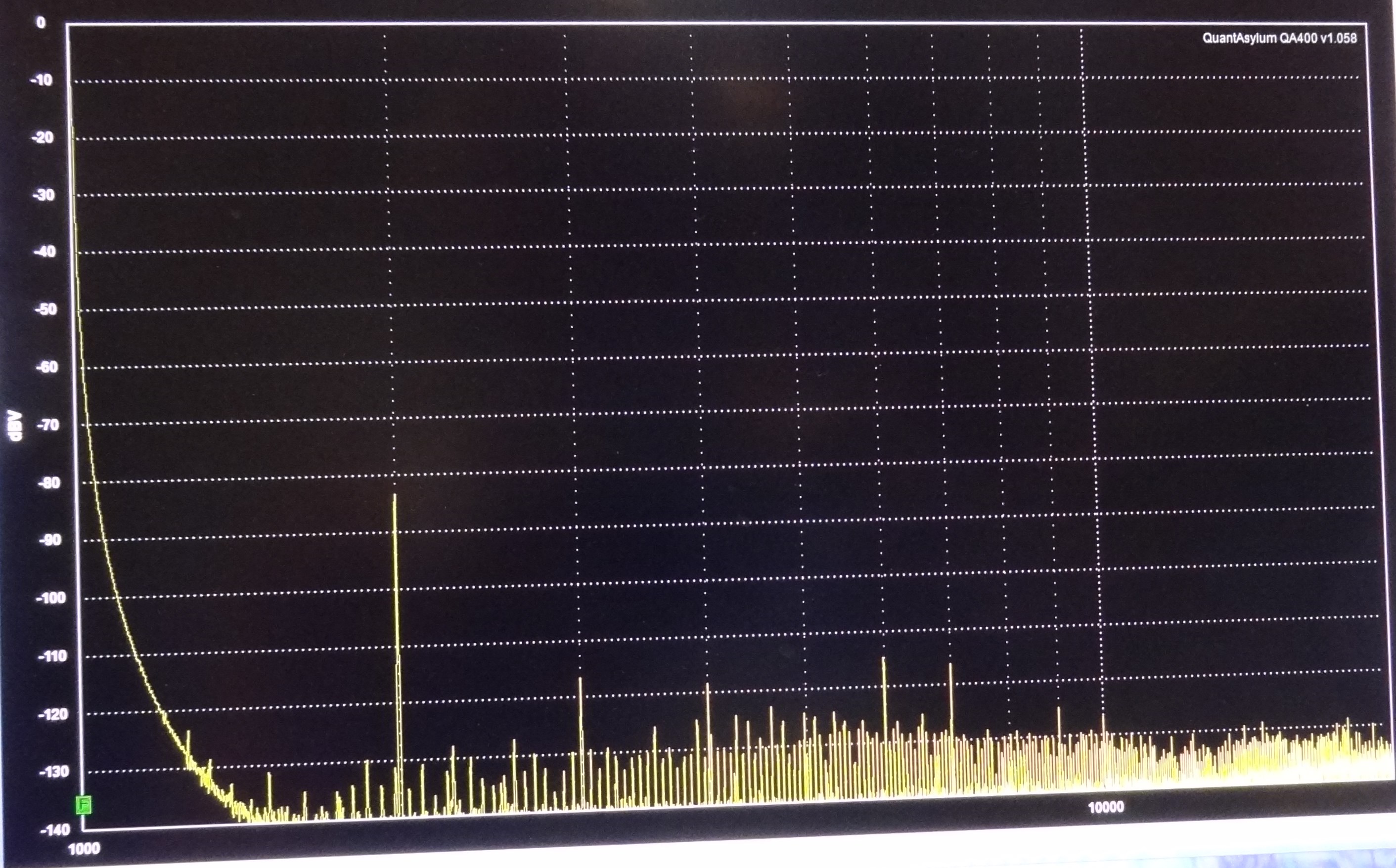

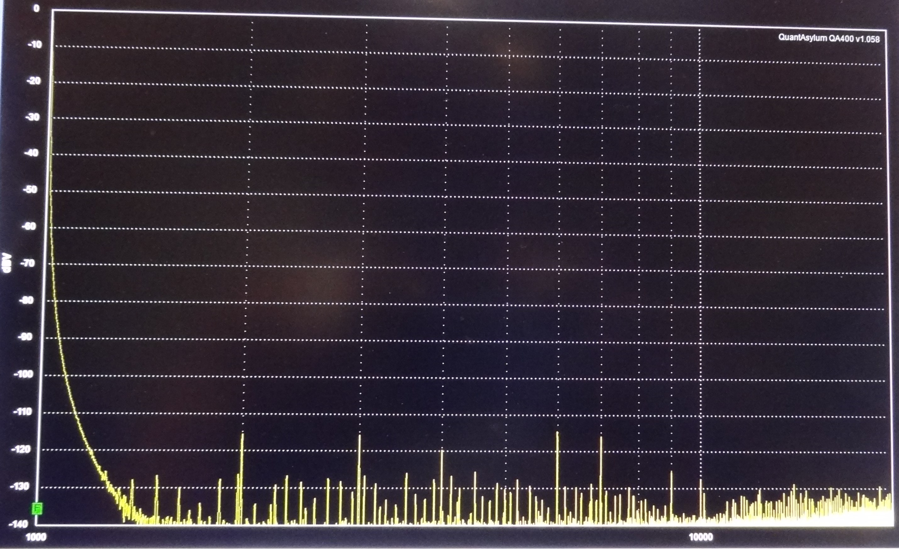

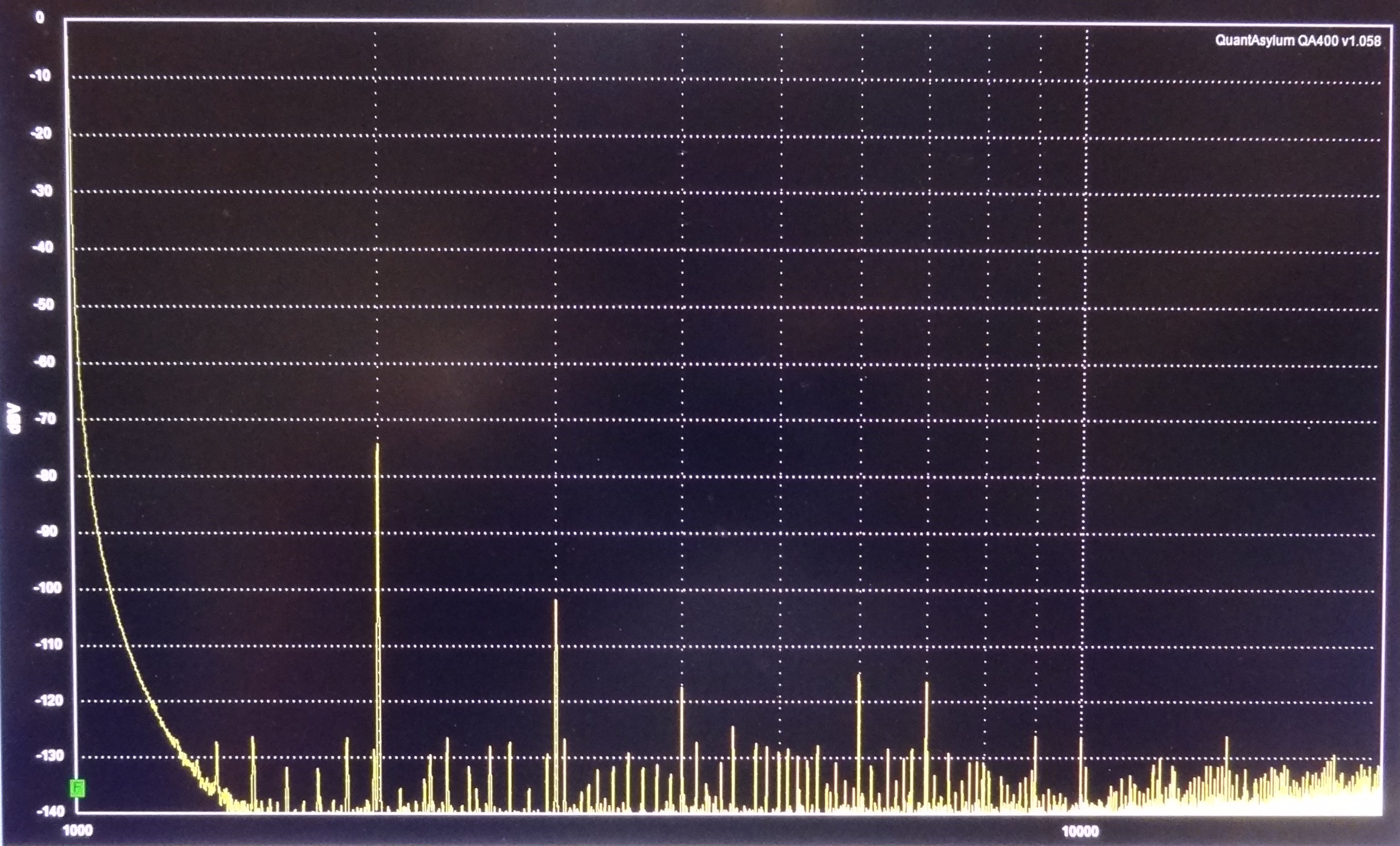

Yes, this is all in the text books. I want to demonstarte that harmonics can be reduced thru cancelling techniques... cascoding reduces the C (J.Miller) affect but does not cancel it.... as in a null. Some things can be done to reduce the C (Miller et al) without cascoding and without extra expense. Or even before/after as an adjunct to cascoding.

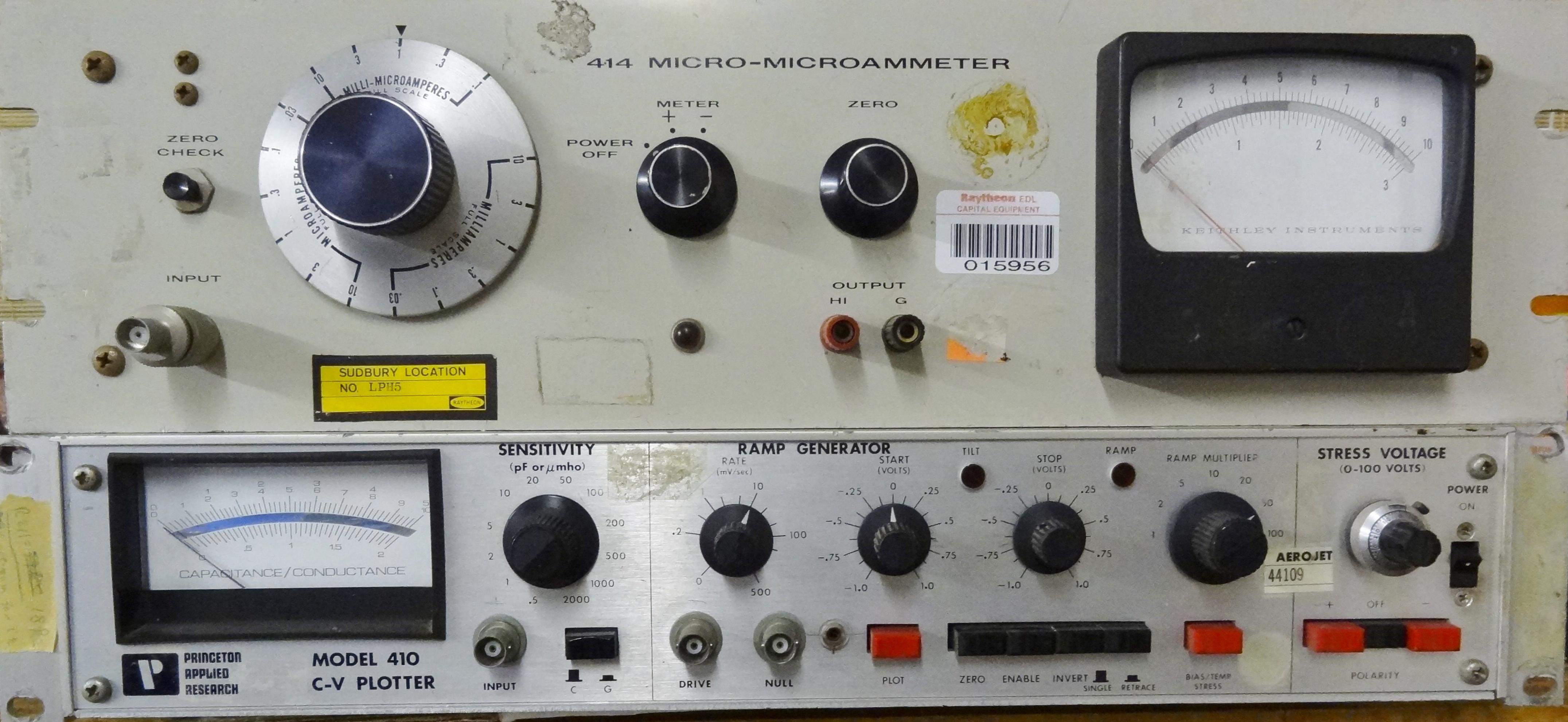

To take it a little further.... I use these oldies but goodies to measure the C of capacitance of semiconductors: It is similar (if not exactly the same equip) used to get the data curves, such as those shown below:
As you can all see, the C drops towards a plateau as the Vds increases and this directly helps with lowering the distortion from those C's. In the example the 2H and 3H drop by 10dB going from 12v to 18v.

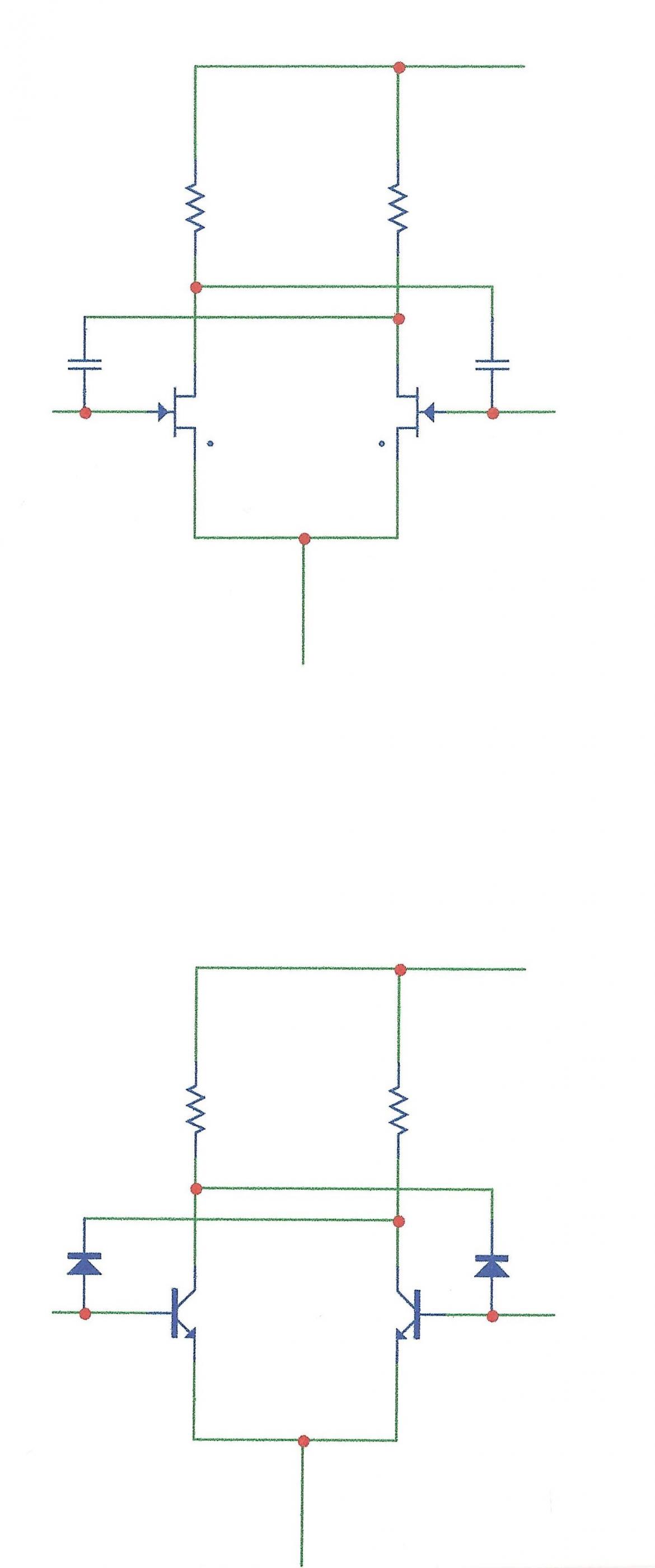

However, when the C's are matched the cancelation can be almost total. In fact the 100X more expensive analyzer shows it into its' noise floor.
Such neutralization techniques are more common as the VDC supplies are below 5v and two devices limit the output ability to get things done with just cascoding. Often with HF amps even using cascoding, the neutralization methods are still needed and help with stability.
So, I showed that with matching C in/Cout(Miller) by padding up the input C can cancel distortion and that adjusting the Vds can be used to match C's and cancel distortion. Here are two more commonly used techniques used but with Diff amps:
Note, if the back biased diodes are made from the same transistor model/part as the diff amp is, the C will track very closely and offer a null over a wider operating range.
Thx-RNMarsh
View attachment 361472 View attachment 361473
View attachment 361479 View attachment 361480

I sure do love that old equipment! Micro-micro amperes! Wow, sounds like picoamps.
Bob

We have a PAR410 in one of our labs, never used it. I suppose it's designed to measure C-V curves at 1MHz, right?
Harry, in some of the amps use of BJTs are made for the driver as well as the cascode, this model only happenened to use mosfets. Indeed the cascode arrangement in driver stage can have many advantages, SOA, high speed devices can be used ect. Im not sure for the purpose of that diode either. To me most strange is the cascode connection, note the connection from D116 and D118 to the mosfets sources instead of being just connected to each other which is the more common cascode arrangement. You might think this connection is of no consequence but spice will show you otherwise. To me resembles hawksford but here we are dealing with a common collector arrangement. I have difficulty getting stability from sims with this arrangement but it does work and is used in very expensive amps so the designers Im sure know what they are doing. Ive build the stage exactly as in that schematic some years back as a quick experiment and found it indeed superior to Selfs EF2 and it even outperformed a triple outputstage although by not much. Not shown in that schematic is the peculiar compensation scheme required around the driver to get it stable. Note with the more common cascode arrangement no such compensation is necessary. From measurering the commercial versions of amps using this circuit one notices improved 20Khz distortion figures. They also dont display the sudden and rapid increase in distortion one usually finds when a class AB amp gets close to clipping. Distortion here climbs more gradually. These advantages are the selling points in the brochures of these amps. Note this arrangement has been used since about 1982 by Accuphase.
I find it strange that simulation displays the arrangement as being unstable no matter what devices are used but the real actual circuit works as intended.

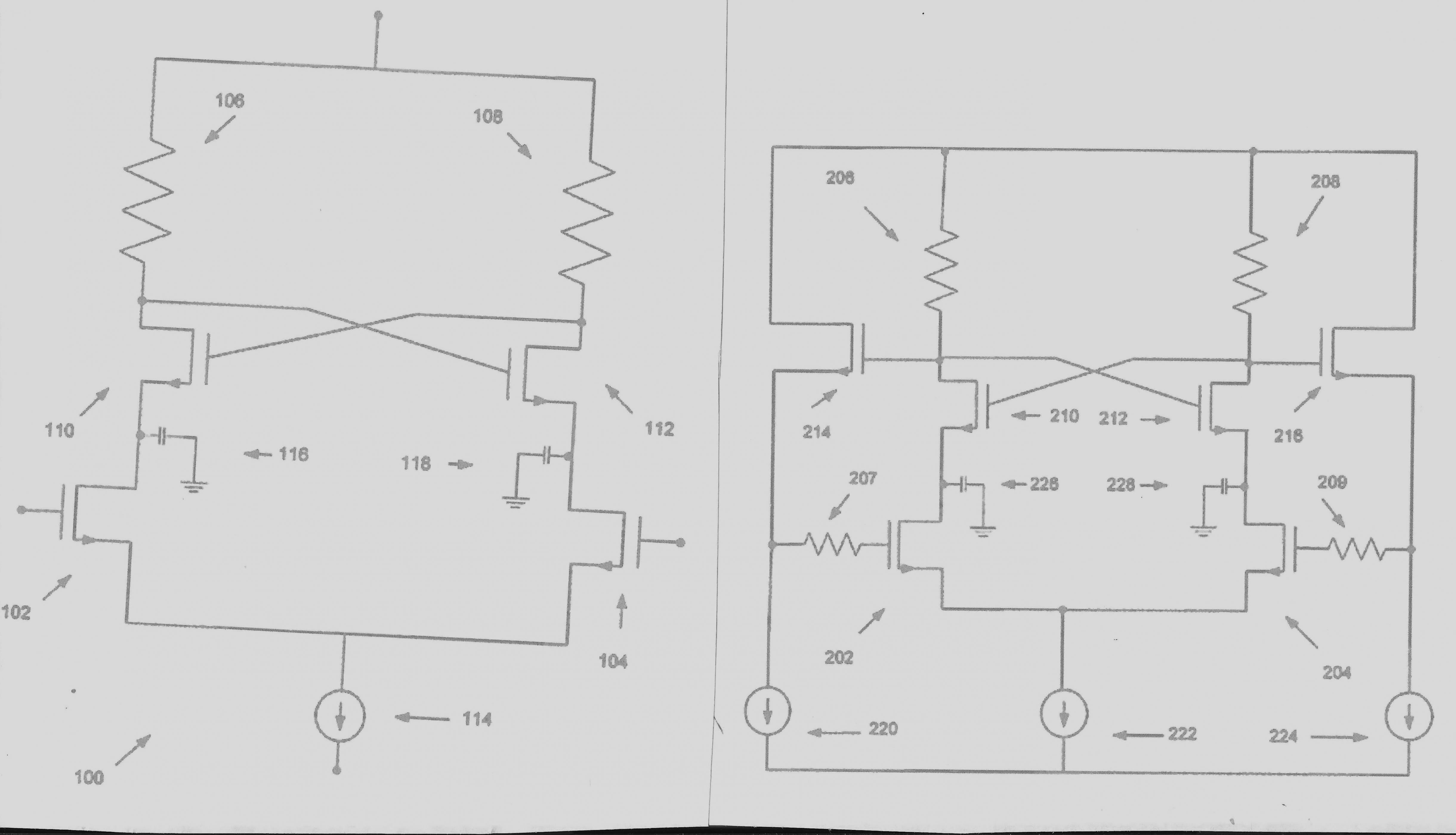

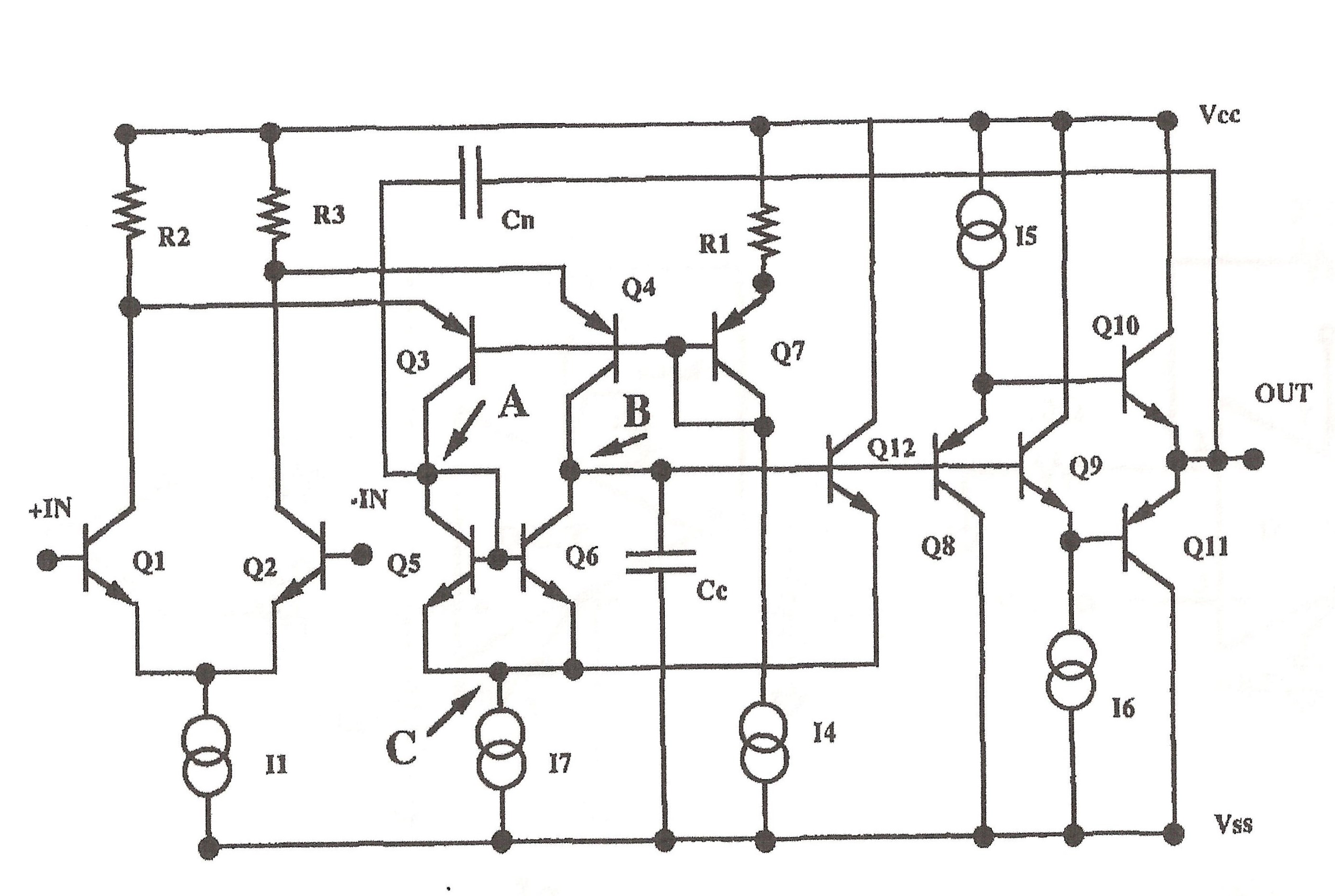

A few more ideas for topologies to cancel the non-linear capacitance that causes so much distotion; though used for increasing speed and BW increase but you can use it for the non-linear C distortion cancelling for lowest Harmonic distortion:
And Scott Wurcer's idea (AES 1992 #3231) for opamp distortion cancelling via Cn.
There are many cancelling techniques found via web search.
Thx-RNMarsh
