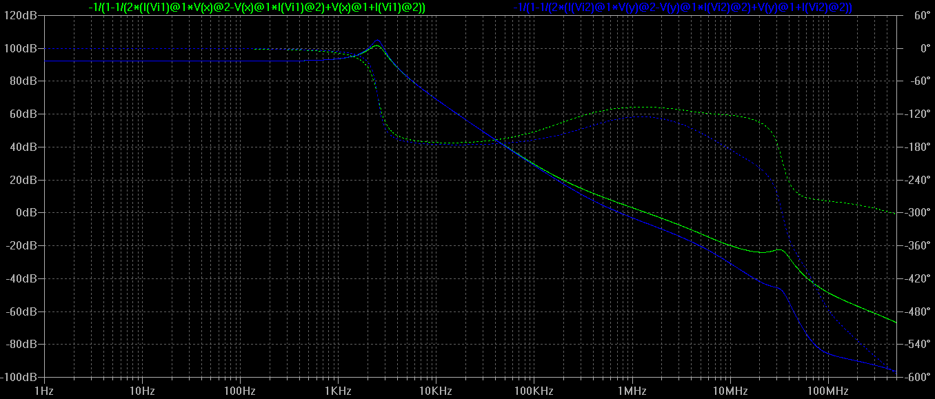

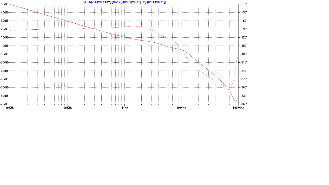

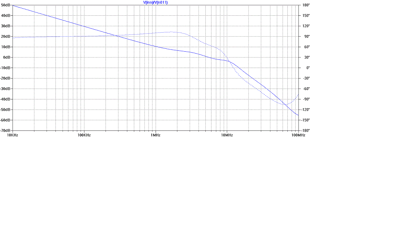

.....could you tell me where you would put a Tian probe to measure your 'total loop gain in the minor loop' for TMC?

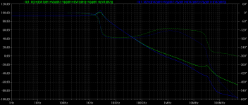

Hi kgrlee,
I have run a sim below of the total loop gain enjoyed by the TIS and the output stage with "TMC" (green trace) by placing the probe in the innermost loop enclosing the output stage.
The blue trace is the major loop gain of TPC using the same compensation network values.
As you can see the loop gain in the audio band in both cases is exactly the same.
So, of what utility is "TMC" relative to TPC especially as the later provides the additional loop gain for the whole amplifier (including the input stage) while "TMC" does so for only the last two stages of the amplifier? :scratch2:

But if "TMC" does not improve on the loop gain in the audio band about the output stage compared with TPC, while TPC makes available the same extra loop gain to linearise both the input stage and the last two stages of the amplifier, of what utility is "TMC"?
TPC loads the VAS, which is a significant source of distortion in designs with heavily buffered output stages. If you have a heavily buffered output stage and a beefy input stage, TMC is superior as far as I recall.

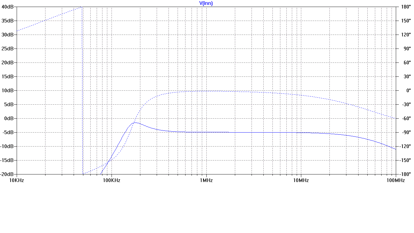

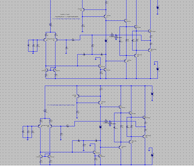

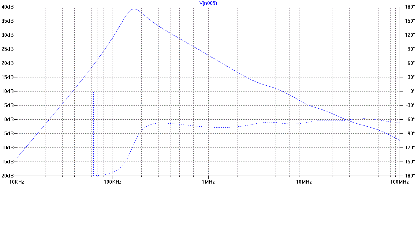

Loop Gain & Tian probes
Bob, section 4.5 Evaluating Loop Gain could use an explanation & recommendation of Tian probes in LTspice
1st pic shows an amp with Inductor breaking the loop at -ve input of LTP as you suggest in the book. I sorta used this method for sims in Jurassic times. LGinductor.gif is the result.
As you say, the 'accuracy' of this depends on the difference in Z on either side of the inductor. If the Z at the base of Q3 is much greater than the Z at InN, we can expect the result to be OK.
baseQ3.gif shows the input Z at the base of Q3. 0dB is 1k and the input Z falls to that only above 27MHz.
Ignoring the LF stuff due to the inductor, we see InN is sorta dominated by R9=600 as we expect and the Z there is always less than the input of Q3. It's also mostly resistive. We would expect little change to the Loop Gain at 10MHz and a bit more droop at 100MHz when we factor in the real Zs
As the Loop Gain goes to 0dB around 10MHz, we expect LGinductor.gif to be good enough to twiddle stability.
Lastly replacing the inductor with a Tian probe confirms this.
The Inductor is probably as good as the Tian probe in this example cos the 'large' difference between the two Zs.
However, if we probe other more sensitive parts of the circuit, the Zs might be less different or even crossover. Then the Tian probe calculates the effect of the different impedances for us. It's accurate & convenient.
Tian probes have other useful properties but these will do for us :)
The TMC phase at ULGF is better.
Plot is a bit small but it looks like an extra third of a radian or so.
And that is even with the TPC crossover frequency a little lower.
So there looks to be room to push up the feedback for the TMC and lower distortion a little.
