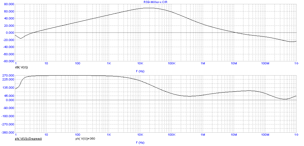

First, let's start with the VAS. In order to accurately simulate the loop gain you have to look at the voltage gain as well as the current gain. How to do that with MC is describe here: Simulating Loop Gain - Spring 1997 and here: Loop Gain
However, this method is a bit cumbersome, as you need an additional copy of the circuit. To avoid this extra copy, you can look if there is a suitable point to break the loop where only one the components (either voltage or current) is very large with respect to the other component.
In this case there is such a point for the voltage component: between the emitter of Q19 (having a low impedance) and the base of Q23 (having a high impedance). Now we break the loop by inserting a huge inductor (L1), which blocks AC signals but preserves the DC operating point.
Via a large capacitor (C13) we inject a voltage into the base of Q23 and looks what happens at the emitter of Q19, which acts like an output.
Of course, we are not done yet, as there is one more VAS. So we inject the signal also into the base of Q26 via C14 and combine the output signal from Q20 to a common point (U) via C10. Needless to say that we also have to break the loop of the second VAS by means of L2 (fig. 1).
Now we simply look at the relationship between V(vin) and V(u) (fig. 2).
Knowing that this method is not accurate (and basically wrong), I've compared the results with Tian's method. Happily, the results were almost identical.
As the ULGF of your original circuit was pretty high, I've adjusted several components: The Miller and TMC caps are now 47pF resp. 220pF and lead lag compensation at the VAS inputs is 330pF in series with 15 Ohms.
Now the phase margin is 94 degrees at an ULGF of 11.5MHz, that is, simmed with above method as well with a Tian gain probe.

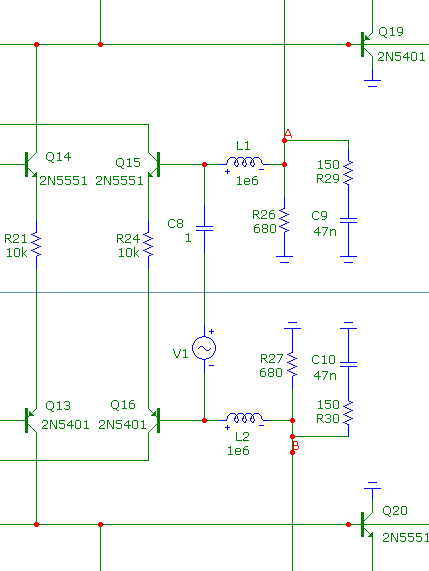

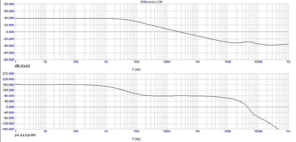

Next, how to determine the gain and phase of the CMCL.
Again, better use a Tian gain probe, but also in this case we can keep it simple: break the loop by means of huge inductors and look at the voltage components.
Opposed to the Miller loop, now we have to inject a differential test signal at the base of Q15 respectively Q16, and look at the differential output voltage at node A and B (i.e. V(A,B)). Simple, isn't it?
Notice that the ULGF (255kHz) of this circuit is lower than in my previous sim. This is because the lead-lag compensation at the VAS inputs, which has been changed, has a marked influence on the behaviour of the CMCL. Also notice that I've increased R29 & R30 from 100 to 150 Ohms for a slightly better phase margin.
For more details, just download (and run) the MC file.
