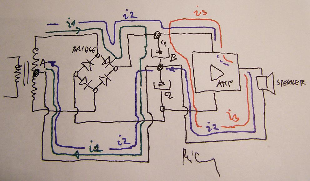

If i understand correctly, the length of the charging-periods will also differ.The upper or lower halves charge separately for part of the charging period.
The charging-period for the cap that sees the most current-draw, will be longer.
Is this correct ?
With kind regards,
Klaas
my use of wording is almost certainly not accurate in that statement.
To expand a little and refer to an earlier discussion.
I said that the current in the upper half exactly cancelled the current in the lower half with the result that the current in the external leg of the centre tap is EXACTLY zero when the rail currents are equal.
What I have now realised is that the two halves of the smoothing caps can recharge at different rates to account for unequal draw from the supply rails.
When the differing recharging is happening it is probably a combination of slightly different currents in each polarity pulse, but also very marginally longer/shorter pulse time.
As an aside the difference current (through the centre tap) is going to be relatively much smaller than the total pulse current that runs through the secondaries.
The effect of this is that the voltage modulations induced in the external centre tap wire are of necessity going to be relatively smaller. This has implications for the dual secondary transformer that is converted to centre tap style by connecting the two secondaries together in series.

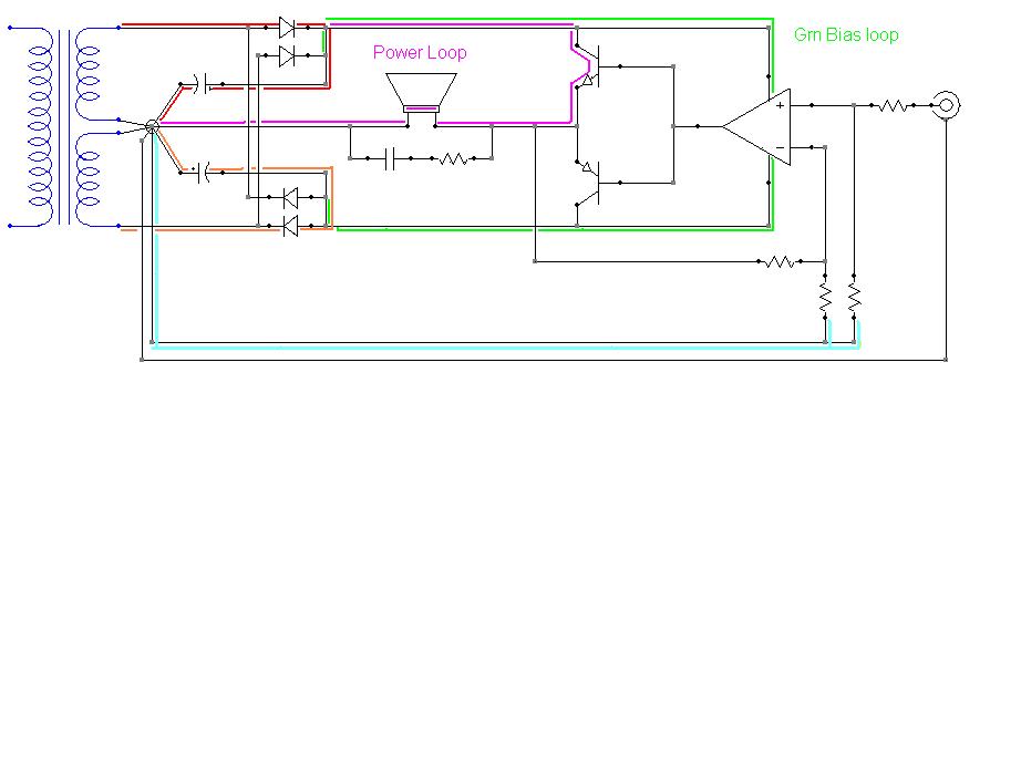

Interesting in how far we had strayed from my original intent. The main issue I was trying to address is one that Andrew and I had called a draw on in an earlier discussion and I still feel strongly about, which is where the main/star/reference ground in an amp/preamp should be located. The conversation branched into a number of sub topics which I attempted to keep intergrated (obviously confusing the heck out of everyone in the process), with the end result being where it was left.Christer said:
Why interesting?
The memorable part in your entrance into the discussion was the comments on the function of the centertap, which I felt compelled to respond to since it is fundamental to my location of choice for the main ground.
I think Andrews post (#159) very eloquently describes my understanding. I was was going to comment on his post, aligning what I had presented (in other words) with his description but I think it stands on it's own and I'm satified we're on the same page there (his discussion even highlighted the shift in currents based on the crossover from A to B, which I had not given any thought to) I believe we still have our differences in where to locate and implement the main ground but I'm not sure how to proceed discussing them.
Your comments are below and I'll attempt to address them
Christer said:Both Jan, Bob, Gerhard and I protested against something you claimed.
The claim that caused the problem was that the speaker current always returns to the center tap. Our protest was that it only does so when the filter caps are charging, and otherwise it returns to the filter caps. In fact, it still seems (to me at least) as if you have not understood what we were asking.
I understood what you were describing and my only response was to try and describe my point a bit differently so you might understand. I'll try again, once again conceptually.
My experience/understanding (and I could be wrong) here stems from the fact I view the purpose of the filter caps a bit differently. I look at them as support for smoothing the DC supply only, which starts at the rectifier outputs and returns to the centertap. Once we added in the rectifiers and the need to sustain the power the filters become necessary, but only to the extent that they are enabling a steady DC supply and return.
My approach is to keep this loop to this function only, connected between the rectifiers and the centertap.
The next important loop is the DC from the rectifier through the output transistor back, once again to the centertap. I don't see any other place it needs to go because the +/- supplies do not interact as far as the signal is concerned (with the exception of the crossover point interaction that Andrew describes). The current for the circuit biasing flows from negative supply through the circuitry and back into the positive terminal (exceptions previously noted)
The third loop of importance is the signal reference. And this needs to be as clean as possible or the input signal/ feedback is contaminated. Accomplishing this is the tough part, especially if either of the two return currents noted above are also circulating on their return paths to the centertap. Which is the basis of my approach to implementing (and where) the main ground. This is an extension of the above thoughts that only works if one accepts the premise as presented.
Christer said:There are different opinions about where the central ground point should be. Neither of us were actually protesting against your claim that the center tap should be used as central ground point or trying to say it is a bad choice. We only protested against what seemed like an erroneous but vital part of your argument for that choice in an attempt to get a clarification of the argument
But current flows only during charge phases, ie. when the AC magnitude is larger than the cap voltage plus a diode drop. This is the very issue being discussed all along. At all other times the diodes do not conduct, so the loops through the center tap and the windings can in practice be considered as broken.
I totally agree with your discussion of the charging currents and their timing, but feel that even when the diodes are not conducting the centertap is still sinking the return from the speaker and is still needed as the root source for the reference grounds.
My thoughts on this has germinated over many years after reading a description of the ideal ground as a unvarying potential that could source electrons without electrically changing. Every system needs this.
Hopefully this makes some sense. As part of my job I'm constantly describing technical concepts to mildly technical people, so I find that this is how I describe things. I also find this site a moving target as to what level the audience is on, it doesn't always work.

Just to add a bit more fuel to the fire
Center tap current also flows when filter caps are not exactly equal in capacitance, or transformer winding sections are not exactly equal, but of course only during cap charging (at least one diode in the rectifier bridge must be conducting).
The whole point is to separate the charging currents (rectifier) from the discharging currents (amplifier), by making the common path the shortest possible. This is actually not that big a problem, but unfortunately, most of the common path is usually within the caps ithemselves where it can hardly be helped except by the choice of caps. This problem is greatly reduced by paralelling caps along 3 wires connecting center tap of transformer with ground of amplifier, + of the rectifier with + rail of the amplifier, and - of the rectifier with - rail of the amplifier, as the wire lengths between form PI filter sections with the caps.
In my opinion, we are dealing with 3 current loops (picture below).

moamps said:In my opinion, we are dealing with 3 current loops (picture below).
When the diode conducts, currents i1 and i2 flow. Current i1 is the charging current of capacitor C1 whereas current i2 is the current which flows directly from the transformer to the amplifier and the speaker. Both currents (i1&i2) return from B to A by the same path so the path must be kept as short as possible. This leads to the conclusion that the optimum design would be the one with only 1 ground star point!!
These 2 currents usually flow 10% (gainclone fans increase that time by up to 20% or more!) of the time of amplifier's operation, which is something that must not be overlooked. The rest of the time, current i3 flows and the capacitor C1 feeds the amplifier.
My two cents,
Milan
I agree with the one star ground point, but not really with the i3 current path. I'll make a diagram of my thoughts later and post.
Regards Mike.

Here's a diagram. I'm not saying I'm right or wrong, it's more that I've had real good performance and It makes sense to me based on the evolution of the approach and the sonic performance. I'm very aware of the other approaches posted on the site, I'm drawn to anything layout related.
Feel free to poke holes in it.
Regards, Mike

It seems to me you forgot about wires from diodes to capacitors...
Hi Moamps.
i1 and i3 routes I agree with.
I see two alternatives for i2 route.
a). as you have drawn.
b). from cap C1 to amp+ve, to spkr, from spkr, to A, up thro' secondary, to bridge, downthrough diode, to C1. (this route does not need to go through B.
Either route works electrically.
Our discussion is whether a) or b) or something else, performs better for audio.
