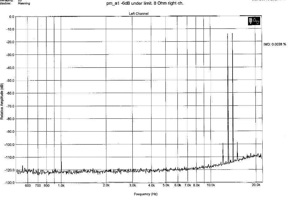

This one does not use error correction. In principle, it looks like Walt Jung diamond buffer. Outputs are complementary feedback pairs, here the notice about local feedback. The output stage is biased at about 1.65A now. The structure is completely symmetrical, but not differential.
I am able to measure 13+14 kHz CCIF IM distortion, but have no current plot. I have plots made about 5 years ago, measured on previous version of this amplifier.
It makes significant sonic difference if I close that stage into global feedback or not. Though, the distortion of the output stage is only 2nd and 3rd harmonic, up to 0.004% at listening levels. Also CCIF IM, measured 5 years ago, was low. I believe we have to explore different methods when trying to correlate measured and perceived results.
Sincerely,
Pavel

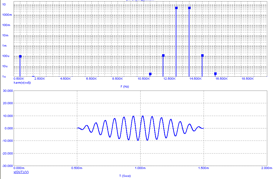

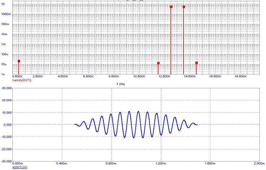

Bob Cordell said:
Do you by chance have a spectral plot of 19 kHz + 20 kHz CCIF IM ?
My 1st attempt, simulator output:
(but simulared THD is different from measured, measured is about 2-3x lower. It horribly depends on transistor models)

further the 10x reduction in sidelobes in the sim suggests a low-modest feedback factor that I think recent pages have shown can give complicated and suboptimal distortion spectrum changes
also the smaller change in 1 KHz diff product seems odd, I'd expect substantially higer reduction with typical single pole op amp gain

I am enclosing MEASURED result on a sample 5 years ago, output stage out of global NFB.
