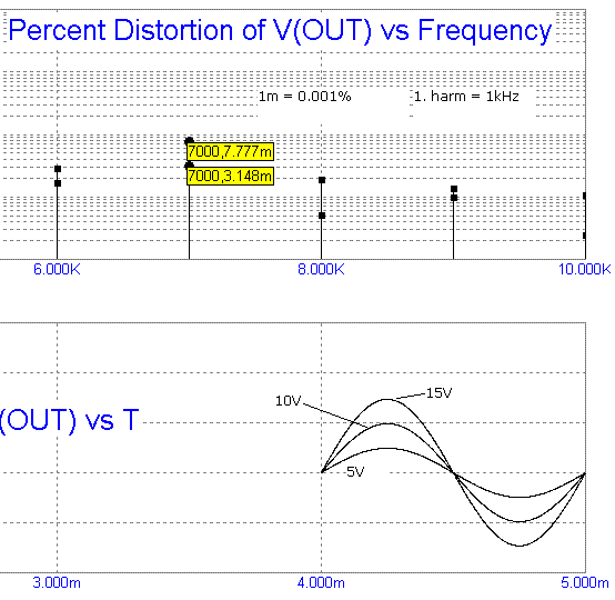

john curl said:This is where a computer could be very valuable. For example, I usually recommend 15mV-25mV drop across the resistor. However, maybe 35mV gives lowest 7th harmonic distortion at the transistion.... I don't know yet. ..... Who knows?
Yes, a computer seems to be valuable.
I think we all agree, that in conventional designs feedback where it is MOST NEEDED from psychoacoustic point of view (trebles, transients, high order harmonics, class B discontinuity...) is LEAST efficient or there is smallest amount of it.
I don't like blanket statements, but "error correction rules"! indeed.
Adam
Adam

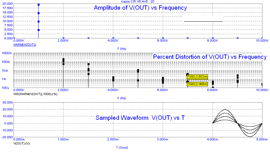

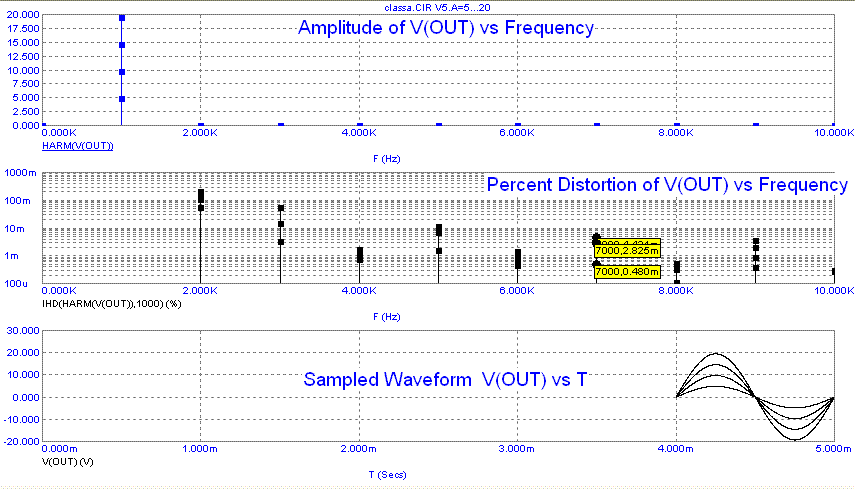

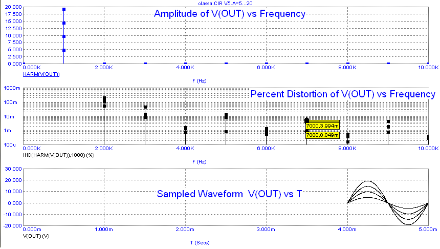

Looks good. Now, IF you can change the resistor Re up and down a little bit, we can see if we really have a null for 7th harmonic. However, please keep Iq at exactly the same place, if you can. Output must exceed class A boundry, but you are already doing that, so we might get an interesting result.
In truth, .1 ohm is a pretty low value for this Iq.
If I change the Re a little bit, I can find minimum for the 7th. But this only for just one amplitude of input signal. So I get 0.00048% of the 7th at 5V. This is definitely out of class A for 105 mA.
Yes, 105mA seems low. But it was the value where I got the lowest 7th. And also Re = about 0.1 seems to be good.
You have more output pairs then 1, don't you? So you will have N x 105mA.

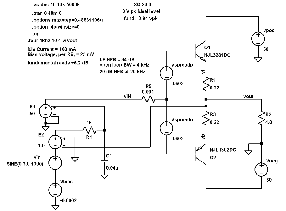

NFB for Class-AB Output Stage
In the schematic below I have simulated a Class-AB output stage with and without negative feedback at an operating signal voltage that is around the worst case for crossover distortion, around 3 V peak into a 4 ohm load.
The stage uses the ThermalTrak RETs with Andy_c's models. It employs 0.22 ohm RE and is biased with about 23 mV across each RE. This is very slightly over-biased compared to optimum, but not by much. Idle current is 103 mA.
The circuit shown applies 34 dB of low-frequency NFB with an open-loop corner of 4 kHz for 20 dB of NFB at 20 kHz. Closed loop bandwidth is about 190 kHz.
In the subsequent posts I'll show the Fourier output spectrum for the circuit with and without negative feedback.
Bob
Bob

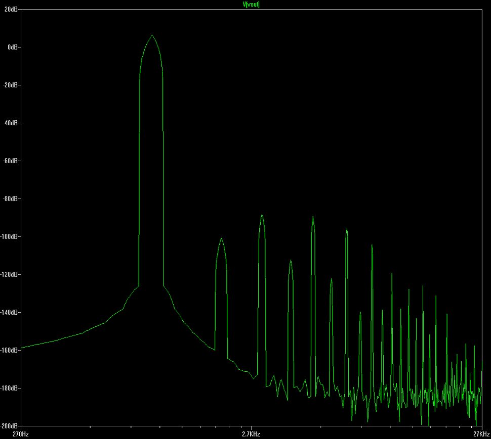

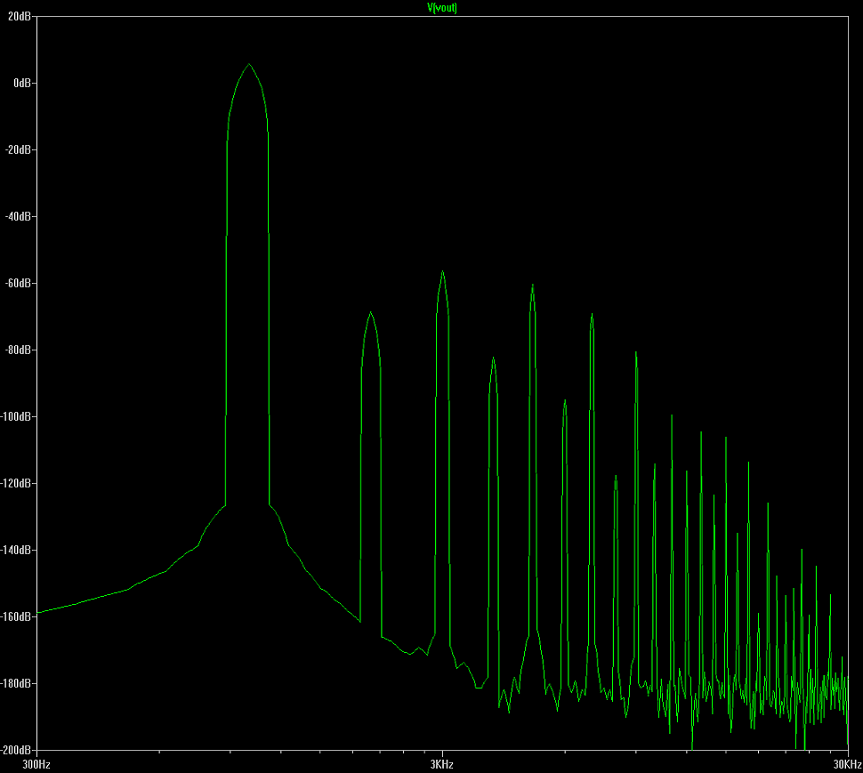

Here is the output spectrum of the Class-AB output stage with no negative feedback. The simulation schematic is shown in the previous post.
Note that the frequency scale goes out to 30 kHz and that the amplitude scale goes from +20 dB down to -200 dB.
Significant crossover distortion is in evidence out to very high frequencies, as expected.
Note that the 15th harmonic lies around -100 dB.
Bob
Bob
Here is the output spectrum with negative feedback.
Note that the 15th harmonic lies at about -120 dB. Negative feedback is doing an effective job of reducing even the high harmonics of the crossover distortion in accordance with expectations based on the amount of negative feedback available at the frequency of interest.
Bob
