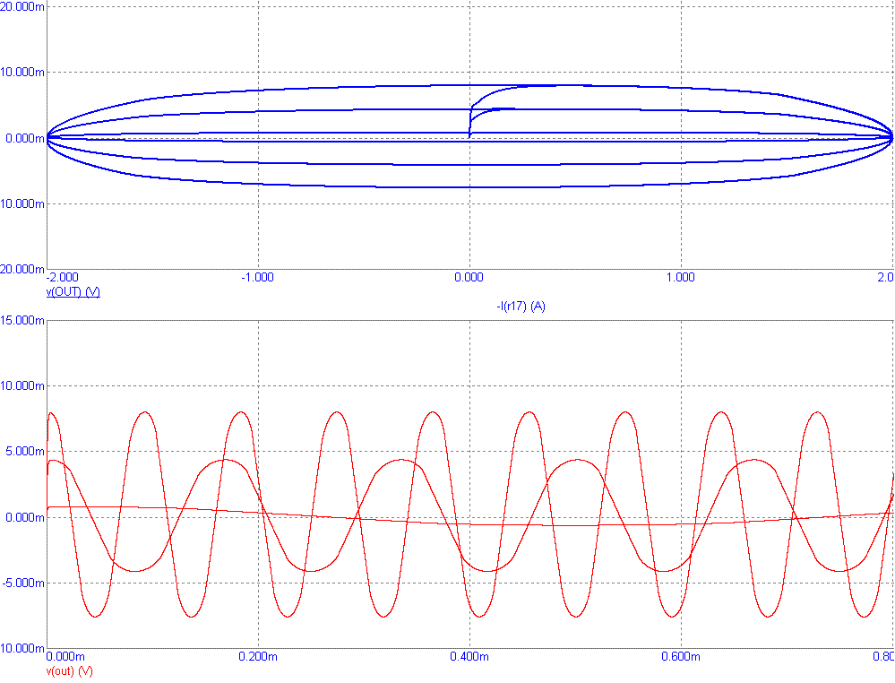

PMA said:Hi Graham,
the story is continuing by different point of view as well:
Hi PMA,
Looks rather nasty, but what is it? Graham's amp?

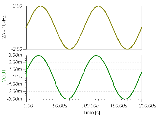

I saw a couple of plots a moment ago and Edmond asking if it was my amp., but now I cannot see them.
No they were not my amp.
I do not know if I can make the same kind of plot here to demonstrate mine the same way as PMA does.
I have never done this specific test before today, but mine appears to check out with <1mV error for 2A reverse 10kHz sine injection, and visible but nicely smoothed crossover.
But that is Sim only. The sound is what I built upon so this result does not surprise me.
Maybe PMA could check it.
Cheers ......... Graham.

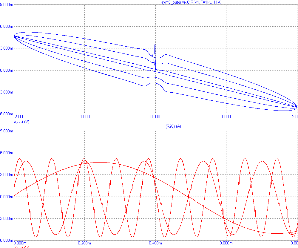

Hi Hugo,
I did. One moment there, next minute not, and when I posted nothing would make them return.
Anyway the traces.
Post #587.
Presumably there is a suddenly starting sine wave starting at t=0.
At 1kHz little phase shift shows so damping will be linear with little error.
At 10kHz there appears to be a typical leading phase voltage error. Crossover through zero is about 10uS early of 100uS, so likely to sound clean. The zero crossover does not look nice, but I will not try to guess whether it is actually audible; might depend on load, cables etc.
Post #590.
This displays what I personally so dislike about quadrature phase shifted damping.
That is, at moments when dynamic loudspeaker generated back-EMF leads (musically altered) NFB loop controlled amplified input, an instantaneous error voltage is generated which increases linearly with current and frequency because damping current lags the sensed voltage by 90 degrees at each frequency demonstrated. Every fully cycle zero crossover point is shifted by 90 degrees, hence what I stated before, the error is greatest for most of the cycle.
Thus I would still like to know how you generate those elipsoid figures.
Below is the linear graph error simulated for the GEM.
There is still a fractional lead, as with the Symasym only less, though here the class-AB crossover incongruity is smoothed by simultaneous and parrallel connected class-A control within the same NFB loop.
As I said I never checked for this before today.
