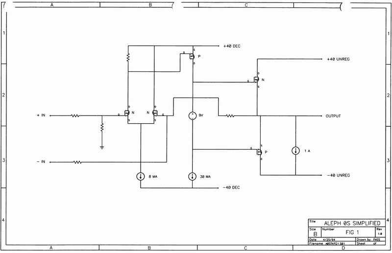

lumanauw said:Putting CCS between output node and negative rail, isn't that is description of NP's Aleph0 and Aleph1? 1994, that's 13years ago.
David,
I was thinking about another design, but I don't remember the exact model, a single ended output stage with a CS as the drain load, and then the CS is modulated by the output voltage.
Jan Didden

janneman said:I was thinking about another design, but I don't remember the exact model, a single ended output stage with a CS as the drain load, and then the CS is modulated by the output voltage.
The original Aleph 0 had a high value constant current source
in parallel with a push pull output stage and ran Class A to
75 watts, which was the rating of the amp into 8 ohms.
A later version modulated the current source based on output
current. This was found in version 1.4 of the Aleph 0 and also
the Aleph 0s and the first version of the Aleph 1.
All later Alephs used a much different circuit.
The schematic for the Aleph 0 1.4 is a pdf file found here
www.passlabs.com/np
