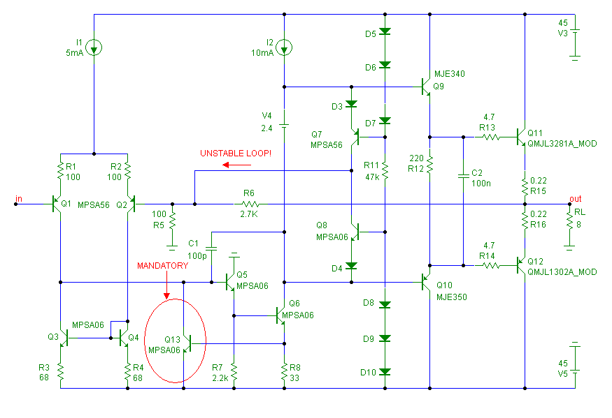

Hi Andy,
You're right, preliminary versions of the blameless amplifier appear to have a serious omission: a current limiter. Luckily, D. Self corrected himself in later versions by including such limiter (see Q13).
BTW, the schematic below also incorporated a clamping FB loop (Q7, Q8 plus diodes), which, as mentioned before, does not work (David ask me to investigate that).
As for my latest design, please, have some patience with me while updating my new website. As soon as it is fit to be seen I'll let you know.
Cheers, Edmond.

Hi Edmond,
I built a very similar circuit twenty years ago, I do not remember the exact details (I think of resistors in the clamping feedback loop) and it worked.
The drawing mentions that it is unstable. No way to get rid of that ?
Cheers

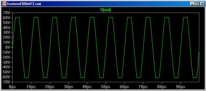

.......is the partial schematic of an amp design of mine with the VAS voltage diode clamped with a circuit that tracks the rails, thus preventing the driver and output stages from saturating. I also like to keep the voltage headroom conservative to prevent fT droop at low Vce as this allows a higher unity gain loop frequency. The circuit also provides a clipping detect output.
The circuit also has a diode clamp (unlike D.Self’s I-limiting transistor) to limit the VAS current.
Attached below is the clipping performance at 100kHz. The input stage LTP’s are being driven well into cut-off here. The LTP’s however, are a very fast stage of the amplifier and the recovery from overdrive is measurable in nano seconds.
So, the question begs:
Why should we care if the input LTP(s) is(are) driven into cut-off during clipping?

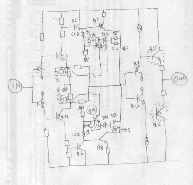

Here's my simple implementation of Edmond's CFB clamp (sorry, I mis-wrote it as CMCL)
For clear illustration, the base schematic is DartZeel schematic (CFB diamond buffer amp)
When VAS Q7-Q8 approaching 0V6 (approaching clipping), it activates Q13-Q14 to send feedback directly to inverting input (Q3-Q4 emitor).
D2-D4 to prevent reverse bias of Q13-Q14. D3//R2 to get soft characteristic. This all Edmonds idea.
The main difference with baker clamp is the clipping data is send directly to inverting input, doing this :

Kind of reducing OL gain when clipping occurs. Local anti clipping like baker clamp is doing the otherwise, pushing more and more signal during clipping.Why should we care if the input LTP(s) is(are) driven into cut-off during clipping?

Hi Glen,
Normally, we shouldn't care about that, as a LTP is 'self limiting' , i.e. the max output current equals the tail current. But there are exceptions, the PGP amp for example. In this case, the LTP easily overdrives the next (NDFL) stage. Also in Bob's amp, in which the LTP is followed by an intermediate stage, the output has to be limited (see D2 and D3).
But we are talking about a CFB input stage, which output current is not limited by a tail current or something like that. Therefore, a simple VAS clamp is useless and we need other techniques to avoid overdrive conditions. How? See my website next week.
Cheers, Edmond.

Baker clamp does not prevent this. Edmond's CCT is working, because it reduces gain during that clipping event. During linear operation (far from rail voltages) they are off.
I tought about this also. It turns out, Edmonds CCT is not working during normal amp operation. It works only near clipping state. In this state, the transistors have big and non-linear capacitance (due to low VCE near saturation), the driver before that transistor had to push large current to that transistor, all adds up to a not normal behavior during near clipping. During clipping, worse. The differential push larger signal, high order harmonics (due to square wave formation) is happening.Clever circuits are nice to design but we are there in the transient/non linear area and this is difficult to analyze/simulate.

Hi Glen,
I think that a NFB clamp in a classical VFB amp (like the blameless) is of little use. Whether you can combine it with an over-current protection circuit, I have my doubts. There is simply too much phase shift along the chain of IPS, VAS and OPS, in particular with reactive loads.
In cases where the supply voltage of the VAS is higher than the main supply voltage, your tracking clamp will of course do the job, but I don't like such brute force method, as you effectively short circuit the output of the VAS during clamping. Just a matter of taste.
The CFB clamp however, was born when I was struggling with the finishing touch of this amp, the one with a little bit of local gain around the output stage. An attractive feature of this topology is that the supply voltage of the VAS can be chosen lower than the main supply voltage, meaning that it can be derived directly from the main PSU and regulated too without loss of voltage swing of the OPS. Also, it provides sufficient headroom for a cascode. In short, you don't need an ugly boosted PSU for the front end (in my NAD-319: 44 additional components!).
The downside is that the VAS doesn't 'know' exactly at which level it should clamp, as it depends on too may factors (main-PSU, VAS-PSU, OPS-gain, cascode-Zeners, etc). A too low level means loss of power and a too high level means it simply doesn't work.
So I concluded that the only reliable solution consists of a circuit that detects where and when it goes wrong: saturation of the drivers. Feeding the 'saturation signal' back to the VAS input is of course feasible, but in case of a fast CFB input stage, it's more elegant, even mandatory, to feed this signal back to the inverting input.
There are of course some pitfalls, for example, how to avoid additional distortion under non-clipping conditions and how to ensure that the additional FB loop doesn't affect the stability. But, according to my simulations, these issues are easily overcome.
Cheers, Edmond

lumanauw said:Here's my simple implementation of Edmond's CFB clamp
[snip]
Hi David,
Isn't it a bit naughty to give away my 'secret' before I've disclosed it on my website?
Cheers, Edmond.
Re: Re: Re: Re: CFB clamp
Hi Forr,
So we are/were on the same track!
I think it is feasible to make this arrangement more stable, although it'll need more components. I've tried several lead lag compensations, but without convincing results. So I prefer a CFB input stage, which is more stable, i.e. less phase shift.
Cheers, Edmond.
forr said:Hi Edmond,
Cheers
Hi Forr,
Cheers, Edmond.
