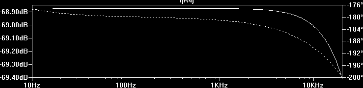

Consider the filter below. Neither me nor my friend could hear a difference between it or a flat phase response. Speakers were not an issue since we used his electrostatic headphones. Now, maybe we have tin ears, but I'm not convinced...ingrast said:This is mostly of concern with transient phenomena and irrelevant for example with steady tones.

Nixie said:
Consider the filter below. Neither me nor my friend could hear a difference between it or minimum phase. Speakers were not an issue since we used his electrostatic headphones. Now, maybe we have tin ears, but I'm not convinced...
Your posted response is not THAT bad after all. Yet probably sensitive people could discern a difference in certain percusive sound passages.
Rodolfo

If you are concerned for example with stability, phase is more relevant. If you are concerned with phase linearity, group delay is more informative.
