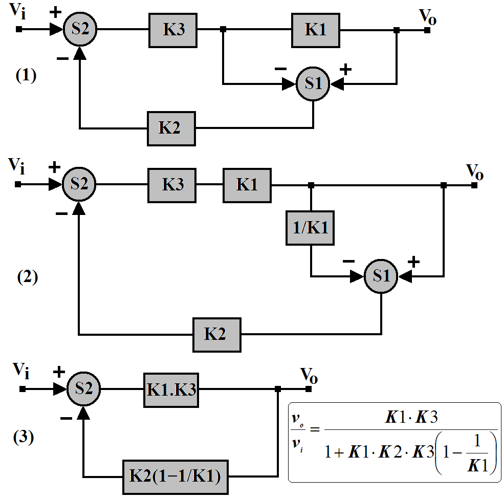

You'll notice that the condition for which my argument is valid is at balance when the summers are of exactly unity gain, so that the error extracted from the output stage, and transferred to its input, remains of exactly the same magnitude, but with 180 degrees phase shift.
Clearly, when you stray from this balance condition, however slightly, the expression for loop gain given here no longer applies; error-cancellation cannot then be said to occur, here and here.

We can visualize what happens by returning to the block diagrams below, previously given here.
With respect to the transfer function, Vo/Vi, when K2=K3=1, then Vo/Vi=1.
If, on the other hand, K1=1, and K1, K2 are not necessarily unity, then Vo/Vi=K3.
mikeks said:We can visualize what happens by returning to the block diagrams below, previously given here.
What I'm getting at, if K1 and K3 are 1 (no non-linearity I presume), then K2 is immaterial, and again, there is no loop transmission. So, whether there is an error or not, there is no loop transmission of the SIGNAL. Only the error, if it is present. So I can't see the infinite loop.
