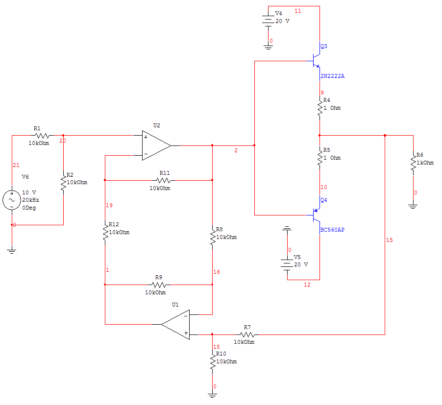

traderbam said:
Jan, I feel the penny is going to drop very shortly...so let's persist.
Disagree.
I am saying that figures 1, 2 and 3 (below) are equivalent. Fig 1 is H.ec as shown in his model. Fig 3 is a normal NFB system.
If they are all the same, if fig 1 can be nulled, so can fig 3.
No.
OK, getting closer. If, in your figs 2 and 3 in this quoted post, you give the global nfb block the value 'beta'.
Then, the remaining 'a' s should be called '1/N' to be equivalent with my fig that you quoted. Agreed?
Disagree.
In my diagrams (all three of them) the input to N, let's call it Vn, is given by:
Vn = (Vi - a.Vo)/(1 - a)
In your diagram,
Vn = Vi + (1/A - B).Vo
I don't see how to make these the same.

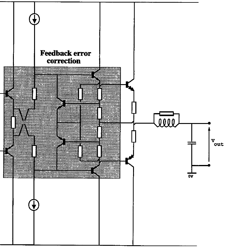

lumanauw said:
What happened if the EC tries to compensate for the nature rolling down response of the output stage? I think it is very possible, because the EC transistors usually smaller size (have much higher fT) than the output transistors.
You're absolutely right. If you refer to the schematic in this post you'll see the single capacitor to ground from the junction of the two resistors in the driver stage. So instead of subtracting the output stage's output voltage from its input, the output is subtracted from a low-pass filtered version of its input. If that capacitor is not in place, you can look at the frequency response from the circuit's input to the gate of one of the output devices and see it rising as frequency increases, just as you said. What I do is just increase the capacitor until it is just large enough so there is no rise in this response. That seems to result in a nice stable system according to the sim.
The idea is to have this low-pass filter approximate the frequency response of the output stage as closely as possible so that what you are saying doesn't happen
lumanauw said:
In Bob Cordell's schematic, there is C10 (39pF) from R38-R39 junction to ground. Is this C works the same as your C3?
Yes, that's it.
Since you have made amp with Hawksford EC...
I haven't made one 🙂. I was working on the design of one but couldn't get the sim results to come out right, so I gave up. I am working on the design of one now again.

darkfenriz said:
Andy and Mike
LTP in Hawksford's correction is no better than original single bjt. Look carefully: predriver's emitter is a part of correction circuit's collector load. Then, if correction is a sigle bjt it kind of 'diode-linearizes' itself.
Adam
Not really; look more carefully:
mikeks said:
Hi Andy,
As you've noted regarding your arrangement: how does one accommodate the headroom required by the diff. pairs without over-biasing the output stage, especially if an all-BJT output stage is used?
I was thinking in terms of MOSFETs, so I'm not sure what would happen with bipolars. In my referenced schematic, the DC Vcb of each diff pair will be about 8V. If you set up a sim and try it, you'll see that's way more than needed. This also leaves 8V for the current sources and that's plenty too. If the output stage transconductance is large enough, the voltage across the diff amps' collector resistors will consist (approximately) of only DC plus distortion, so the dynamic range requirement is less than one might think. In the sim I'm looking at now, the diff amps can only swing +/- 4V, and this is more than enough to accommodate an output that's swinging +/-80V, even with a 4 Ohm load.
I suspect, for a start, returning the tails of the diff. stages to the supply rails, and, perhaps, adding a resistor to connect the emitters of the complementary followers between which the diff. pirs are sandwiched.
Yikes! I'm not sure how I'd adapt this to bipolars to tell the truth. Bipolar output stage with MOSFET drivers maybe? That's what John does in his big amps apparently. I'm not sure why you'd want a resistor between EF emitters though. If you bias the diff amps hot so that the collector resistors are small, you may find them pulling too much current through the EFs as is. Neglecting base current, that current is constant even as the error correction current varies. But I may be thinking of something different from what you're describing.
