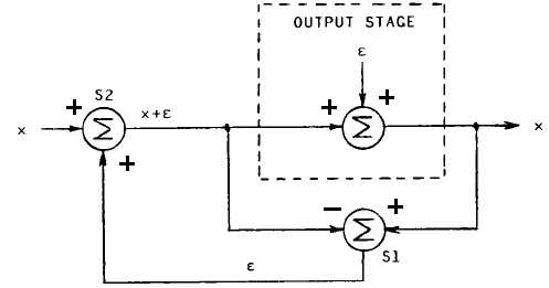

Error correction corrected
I've figured this "error correction" system out. I've read Hawksford's 1981 paper. I'm both intrigued by the superficially seductive algebra and appalled by its complete failure to admit the impractical assumptions it relies upon. I now see why I was and still am having trouble with fig 11 in Bob's paper.
As shown, fig 11 is impossible except when e(x)=0. Sorry.
The error in the diagram is that the output of S2 does not equal e(x) and the output of S1 does not equal x + e(x).

I think at least part of the confusion must reside with the fact that Bob calls his error ''e(x).
This implies, by mathematical convention, that ''e'' is a function of ''x'', which it most certainly is not.

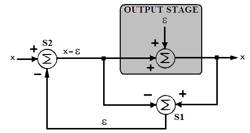

Here is figure 11 as i think it should have been in the interest of clarity:

"error feedback" is more apt but what is negative feedback if it is not this?
In your diagram, to agree with Hawksford, I think the signs of S2 are the wrong way around and the "e" term should be subtracted at the output stage summer. I understand your point and agree because you have assumed the output stage summer is linear - that the "e" term is added after and is independent of the input to the summer, which is "x + e". But the whole point is that the output stage summer is non-linear: this is the device whose distortion is meant to be reduced.
I've observed two feedback loops in this feedback system. Can you see them?

I've been acquainting myself with Bob Cordell's MOSFET with error correction paper. I'm not sure I understand fig. 11. In the text it says wrt e(x) that "This error signal is then added to the input of the power stage by summer S2 to provide that distorted input which is required for an undistorted output. Note that this is an error-cancellation technique like feedforward as opposed to an error-reduction technique like negative feedback".
But the diagram doesn't add up to me. If the input to the output stage is x + e(x) then the output must surely be x + e(x) - e{x + e(x)}, rather than x. And doesn't this assume that the e(x) function is linear itself? So I don't see how the output error can ever be cancelled unless e{x + e(x)}=0, which resident mathmaticians may well offer some solutions for, other than e(x)=0.
It may be the ale, but the diagram looks unstable to me, as it were . The x and e(x) tail chase round the loop reminds me of something...
I should never have used the term feedforward in that article, even though I was not describing the circuit as a feedforward circuit, but rather one that behaves like a cancellation process rather than a process where an error is progressively driven to become smaller as loop gain is made larger. There is literally a pot in the actual circuit implementation that can be adjusted for a distortion null. I apologize for the confusion that I may have created by using the analogy to feedforward.
In that same paragraph, you should have also included in the quote "This technique is in a sense like the dual of feedforward....The technique of Figure 11 also tends to become less effective at very high frequencies because, being a feedback loop (albeit not a traditional negative feedback loop), it requires some amount of compensation for stability, detracting from the phase and amplitude matching."
Bob

I beg to differ. I don't think you've yet figured it out.
As I mentioned above, I did not call it feedforward. It's my fault - I should have written it more carefully so that people who don't read it carefully still are not misled.
Bob

Bob,
Is it not the case, though, that the Hawkford system, when used in feedback mode (b=0, a=1) is a negative feedback system in disguise? I say this because I see that the difference between output and input is driven to zero by virtue of the enormous forward gain that is generated by a positive feedback loop. In your fig 11, this is the regenerative loop between S1 and S2. The negative feedback from the output acts to control that positive loop.
Suppose the -'ve input to S1 were disconnected. Any non-zero value of x at S2's input would cause the output of S2 to seek infinity. Not unlike an op-amp would behave in open-loop if it had infinite gain, infinite slew rate and infinite bandwidth. Hawkford's algebra neatly eliminates the output error term because there are no practical constraints in the algebra.
traderbam said:Bob,
Yes, you are exactly right. One can re-draw the block diagram with the summers in such a way that the whole thing looks like an inner positive feedback system with PFB gain = 1 (resulting in infinite gain) that is then enclosed in a negative feedback system. Both ways of looking at it are equally valid, but each way lends one a different perspective on how it works and on how best to apply the technique. The whole thing works as well as it does because those two loops are implemented in a very tight arrangement with synergy from shared devices.
The key to making it work in practice, which Hawksford did not address in his original paper, is in compensating it in such a way that it is robustly stable while not giving up too much of its error-correcting ability at high frequencies (where it is needed the most). This is the best application that I know of where the higher small-signal speed of the MOSFETs really pays off, since the less excess phase they introduce into this tight loop, the more effective the error correction can be at high frequencies.
BTW, I think that one would have to be borderline suicidal to use this circuit without any output HF isolating inductor at all (because of the resulting unpredictable effect of the load on the excess phase). But note that I was able to use a very small inductance.
Bob

Achtung!
This is wrong; duly corrected below.
Note that this actually shows that the error is obtained by subtracting the output of the power stage from its input, as indicated by Bob on page 10 of his paper, but contradicted in his figure 11.
