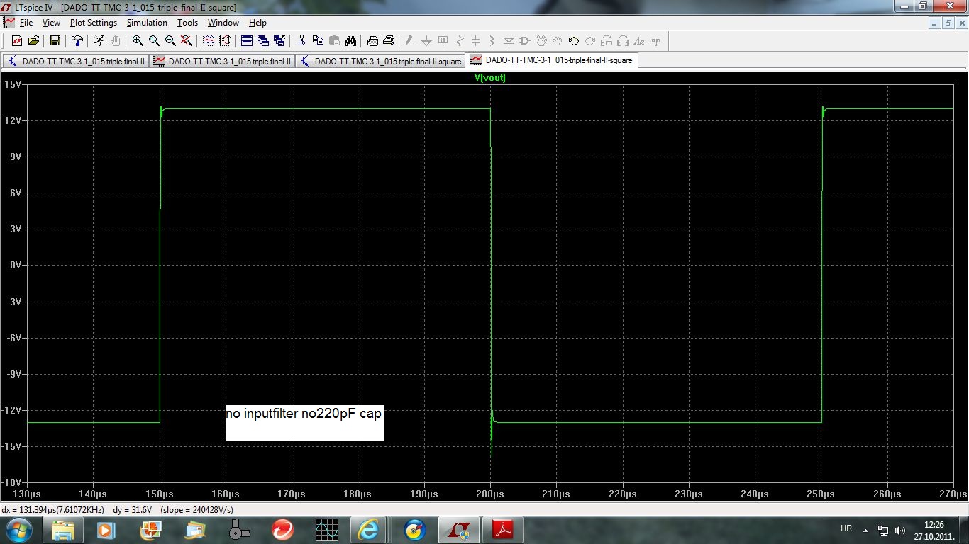

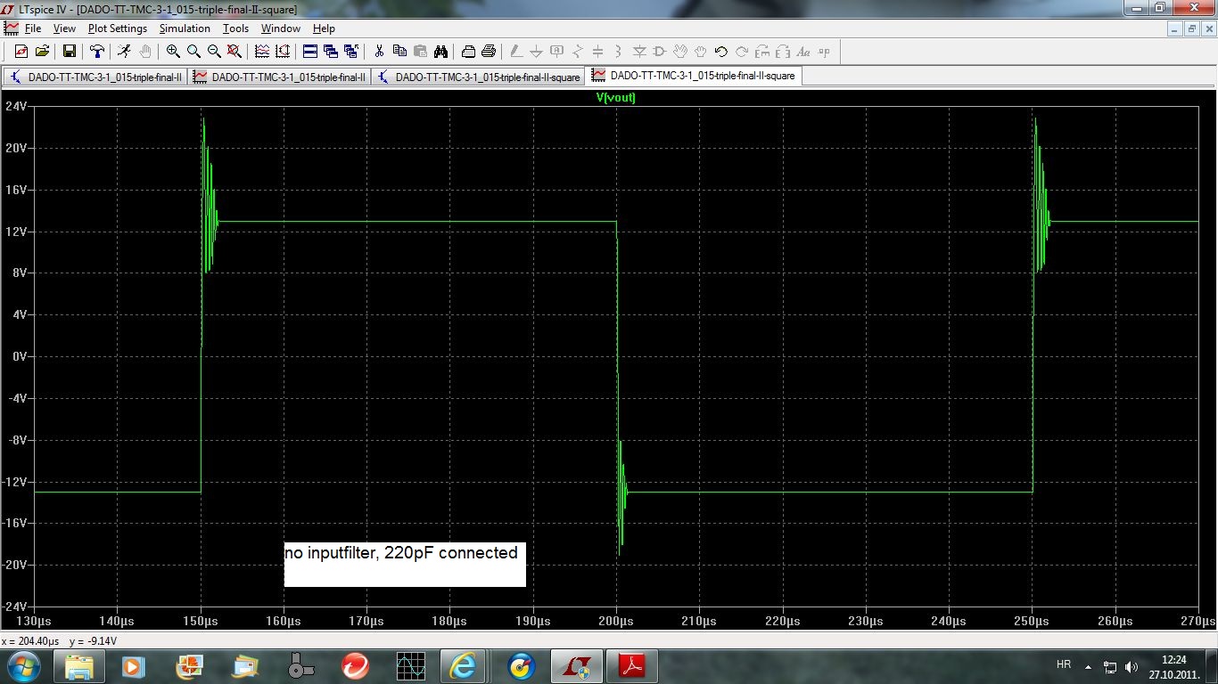

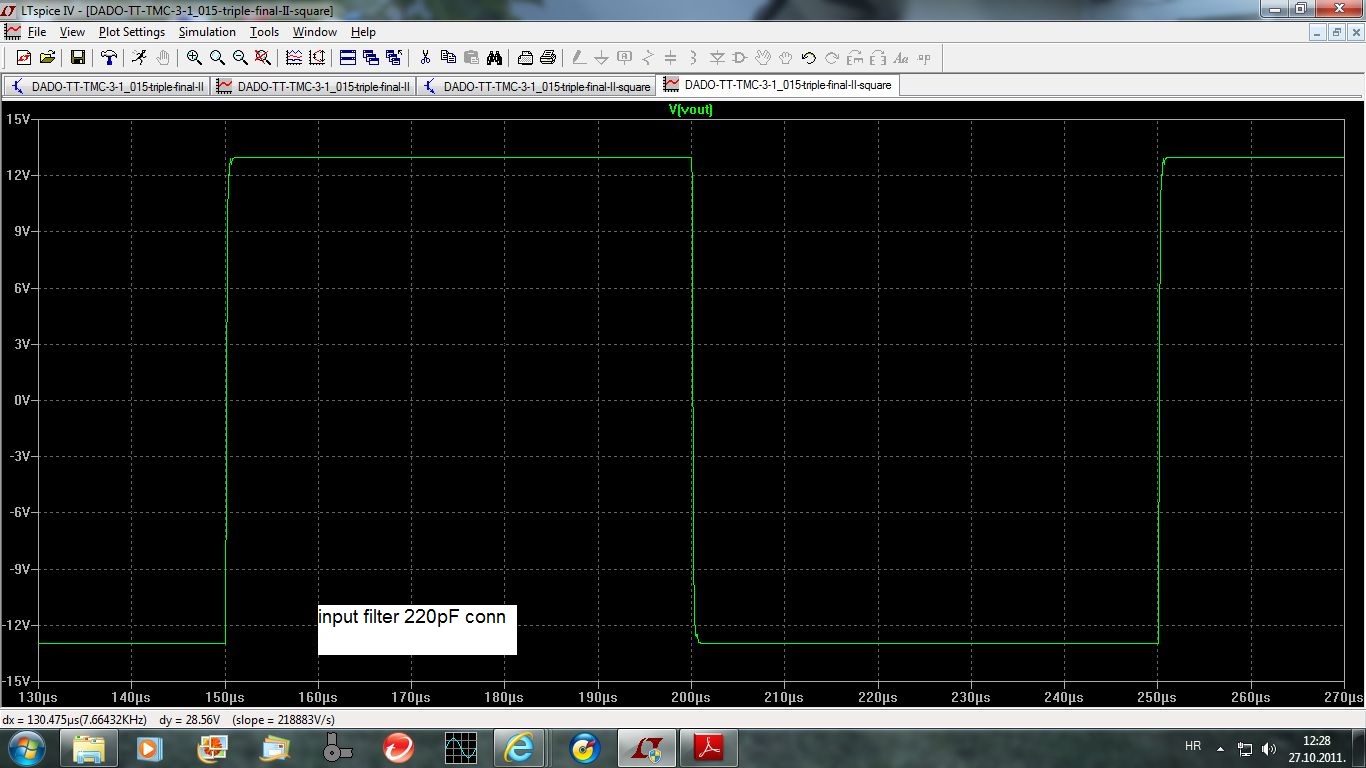

I simuated may amp at my best(not to experienced) and built it exactly as simulated. Only change(or add) were two 220pF capcitors connecte between drivers bases and emitters to tame Triple OPS oscilation. It was not shown in the simulation, not in transient nor in square wave simulation.

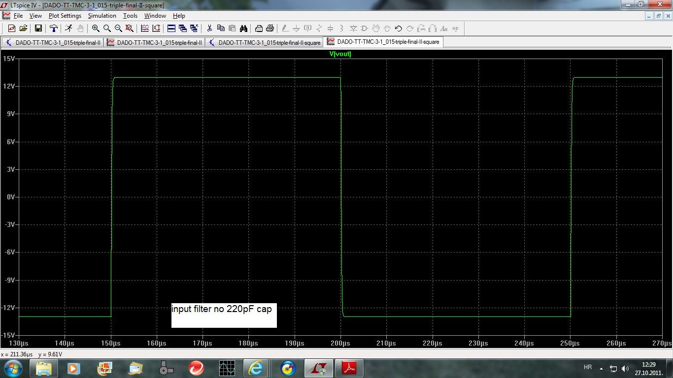

Hi Dadod,
how were changed sim results after putting those caps in your sim circuit?
Hi padamiecki,
I did not notice differeces with the .tran test. With the square wave test there were some differences. Please comment, it looks worst with those caps but in practice thay are needed.
Diagrams below.
dado

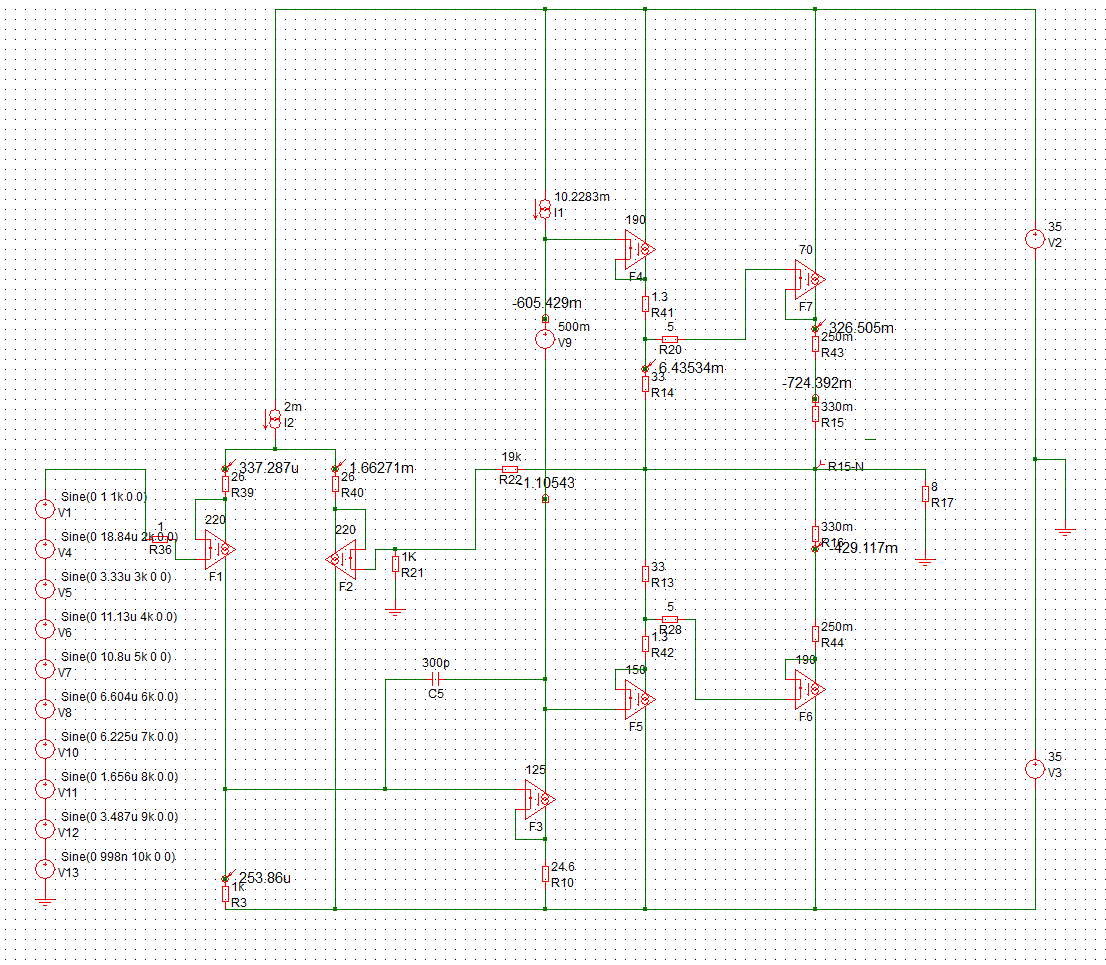

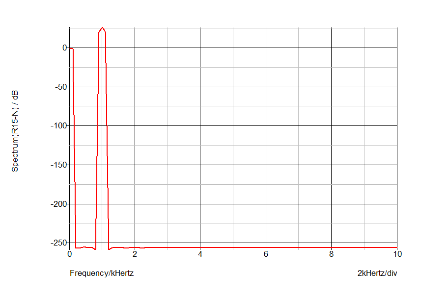

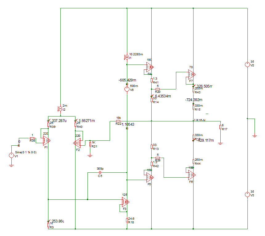

THD Results of Ideal CCCs component Cordell amp
Hello Edmond
Here is the results of the Cordell amp THD simulation using CCCS components, notice I have not included the output inductors to simulate the magnetic induced distortion as I dont know how to couple inductors yet.
Regards
Arthur
Hello Edmond
Regards
Arthur
Hi Arthur,
Thanks for the sim. So THD is virtual zero.
As you have noticed, Antonio has probably nailed down the problem.
His simulator (Cadence) goes only mad when harmonics are present,
while in case of a pure sine the noise floor is okay.
Perhaps you are willing to repeat my sim with the ten sine sources (see post 3905).
Maybe your simulator goes mad as well.
BTW, As for the inductors, it's okay to ignore them. They only mimic the lead inductance of the power trannies and were not intended to simulate distortion as a result of magnetic induction. In order to do that, one must add more inductors (at the input for example) and define the coupling ratio (in case of a decent PCB lay-aout a very low value, of course).
E.

Dadod
What is the frequency of your measured oscillation?
How does it compare to the Amps cross-over frequency.
Namely is the oscillation a loop issue or a local instability with the follower?
For the simulator you might consider adding small inductors in series to the main driver bases to represent the actuals parasitic (as well as some output capacitance).
-Antonio

Dadod
-Antonio
I could not stabilize the amp without those caps, so I don't know the frequency.
I suppose it was a local instability. Thanks for the advice I appreciate it.
dado

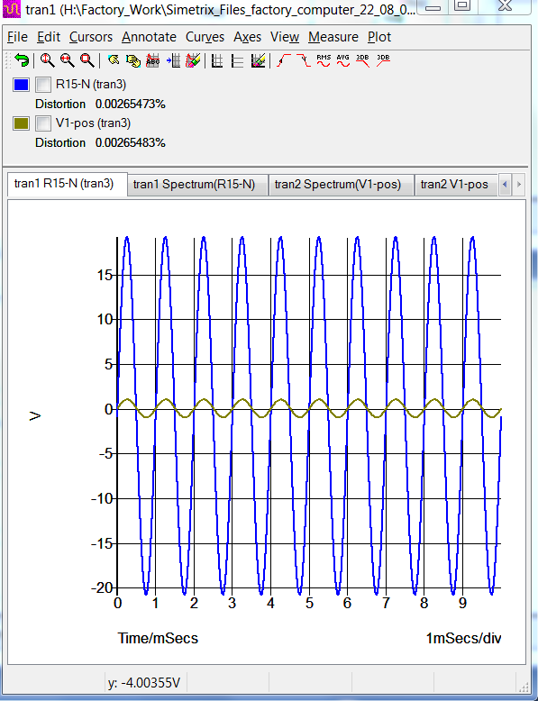

Edmond, Wally,Just to be clear, the only discrepency that I see from Wally's original comparison (LTspice to Cadence Ppsice) is the Cadence higher tabulated fourier components from the .Four output.The 2 FFT plots appear to be identical and correspond to the Ltspice .Four components. Note that this is still consistent with my observed errors with the Cadence FFT plots, in that I saw 20 to 5% errors (2nd and 3rd harmonics) which interestingly decreased as the distortion was lowered (so at least well within the error of interpretting from the supplied log plots).I think Wally later also observed the same behaviour in increasing the Cadence FFT resolition and decreasing its noise floor actually resulted in worsened .Four values.As far as which is correct, well I know that for my simple 4rth order polynomial test Ltspice was accurate, Cadence FFT was not and its .Four showed evidence of worsening with decreasing distortion levels (or at least needed a smaller max delta time)Hope this helps-Antonio
THD performance with 10 sine inputs ( as per post3900)
Hello Edmond
Here is the simulation with the 10 input sine wave signal from post 3900
As you can see the input THD is 0.00265473% and at the output THD is 0.00265483%. As can be seen the the output has virtually the same THD as the input. This is interesting.
Regards
Arthur
Hello Edmond
Regards
Arthur
Hi Antonio,
Indeed, the plot seems to be identical*, except the scale: rms vs peak values.
The numerical output on the other hand, is wrong, totally!
Happily, you observed that too. A rather embarrassing situation, in particular for those who repeatedly shouted that THD simulations are useless ("excreble" [sic]) and produce just noise.
Ironically, those skeptic guys, of all people, didn't look any further and draw the wrong conclusions. As said before: Only fools get fooled.
E.
*I've checked only the amplitude of the 2nd harmonic.

Hello Edmond
Regards
Arthur
Hi Arthur,
Thanks for the effort, but you have done too much.
I meant just the THD of the sine source, i.e. without the synthetic amp.
Never mind. The outcome is still accordance with what would be expected.
edit: That leaves the nasty question, why your sim of Bob's amp predicted a much higher THD-1k (190ppm)
E.
Hello Edmond
This is a very interesting question, as far as numerical computations Simetrix is good but you may notice from time to time I ask you questions about THD sims you do " what input level did you sim that with" I am attempting to compare results. I wish I knew what the difference was caused by.
Regards
Arthur
